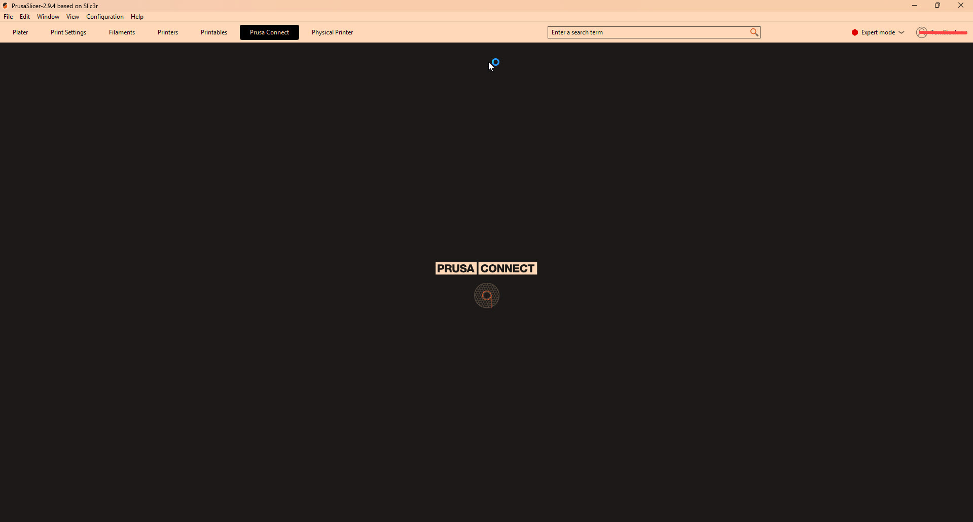

HI there,
I am trying to setup Prusa Link on my MK3 via a RaspberryPi 4B
However, despite PrusaLink & the PrusaLink documentation saying that the MK3's are supported I am unable to connect. I have updated to the latest firmware (3.14.1), and flashed the PrusaLink github image ( https://github.com/prusa3d/Prusa-Link).
Can anyone help with this? Or is it a case that both the MK3 and PrusaLink are just considered legacy now and not maintained?
Finally, I attach screenshot of the PrusaLink error messages I get from PrusaSlicer and via my browser.
Note, I am unable to connect via PrusaConnect either...

RE: Prusa Link: "Unfortunately your printer is not supported or running old firmware. Only Original Prusa MK3, MK3S and MK3S+ printers are supported."
Check on the printer first under the menu that the firmware upgrade installed correctly - make sure its the latest version and not a beta.
Try flashing the prusalink software again and reconnecting.
