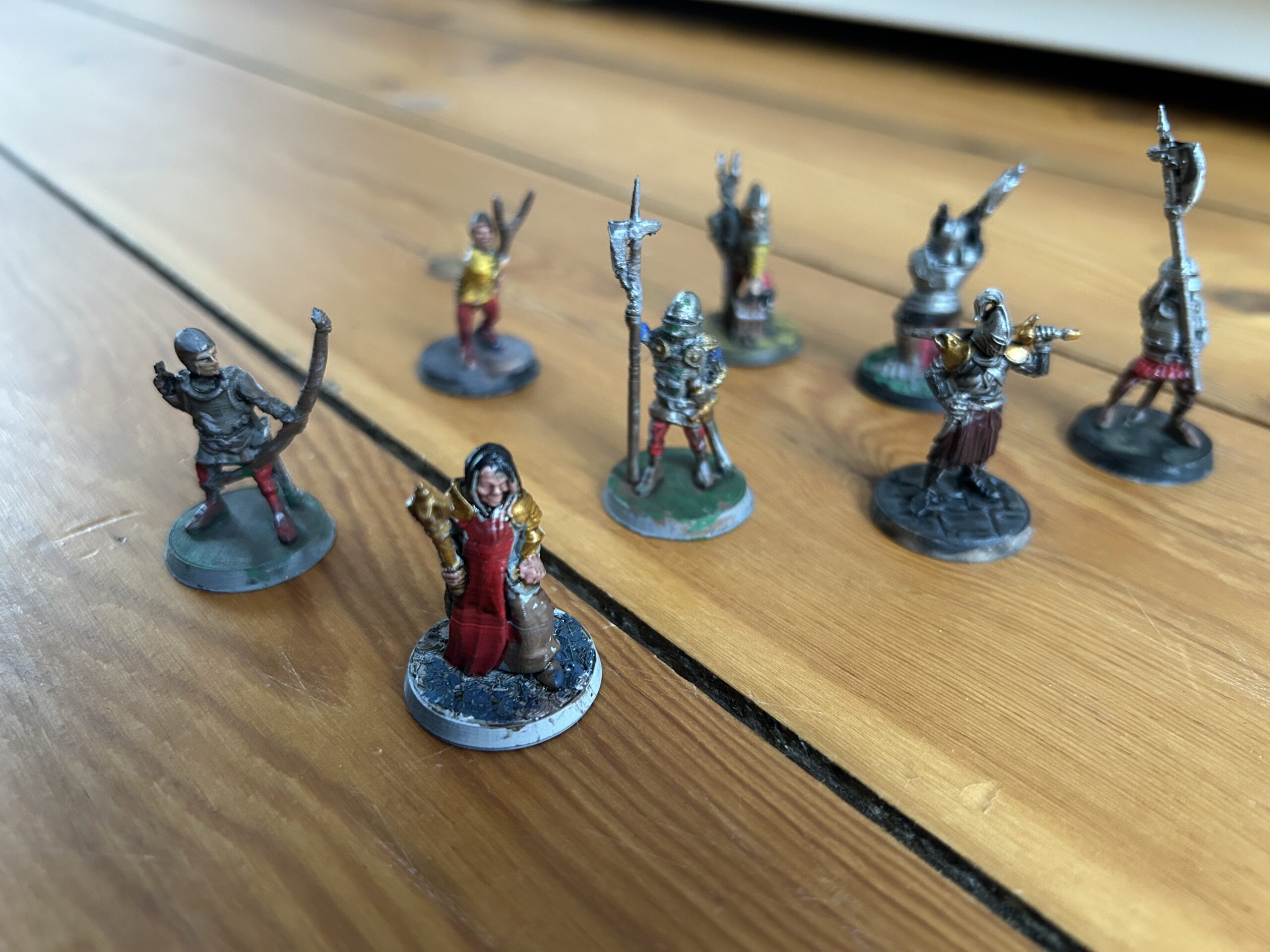

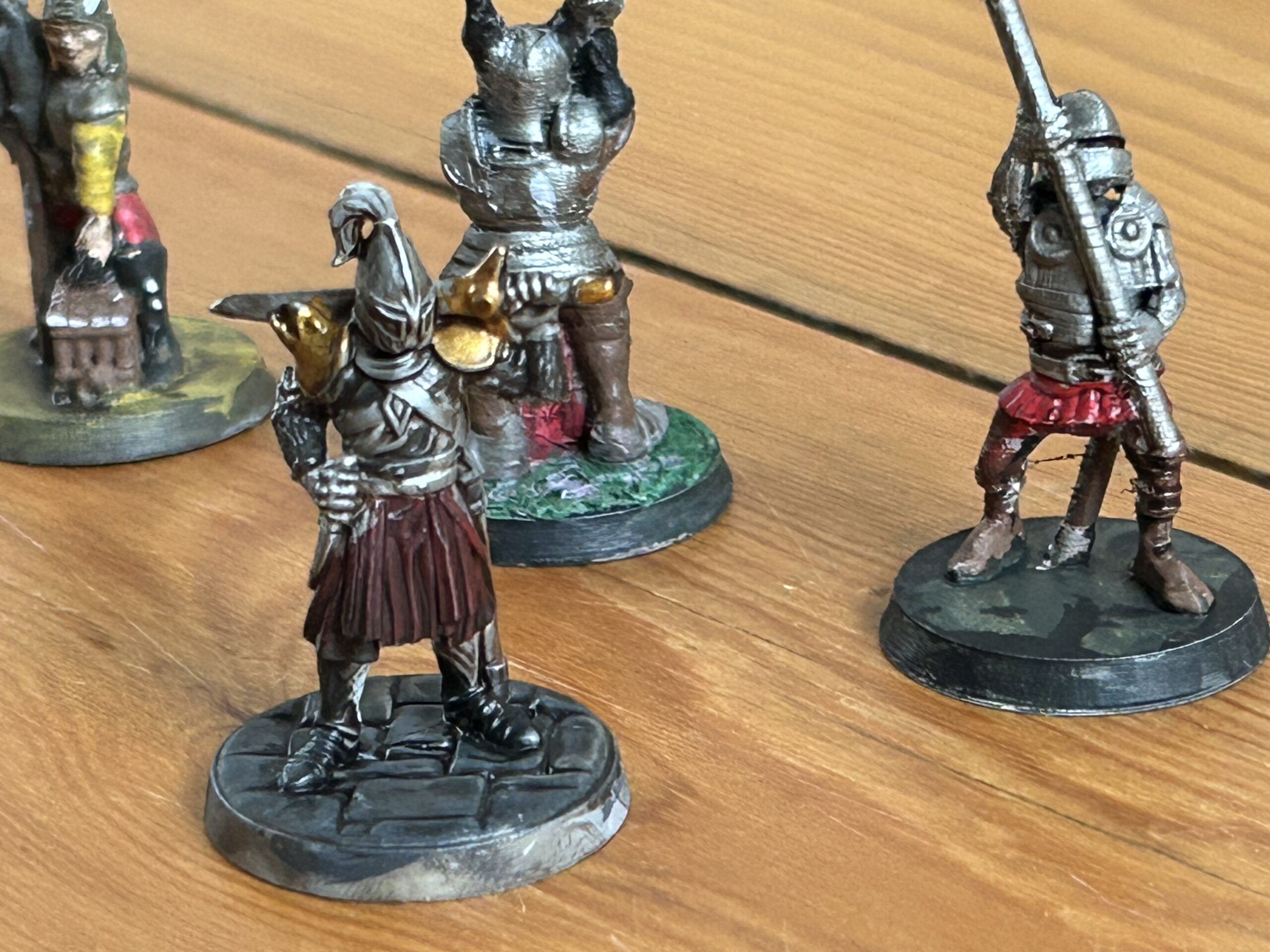

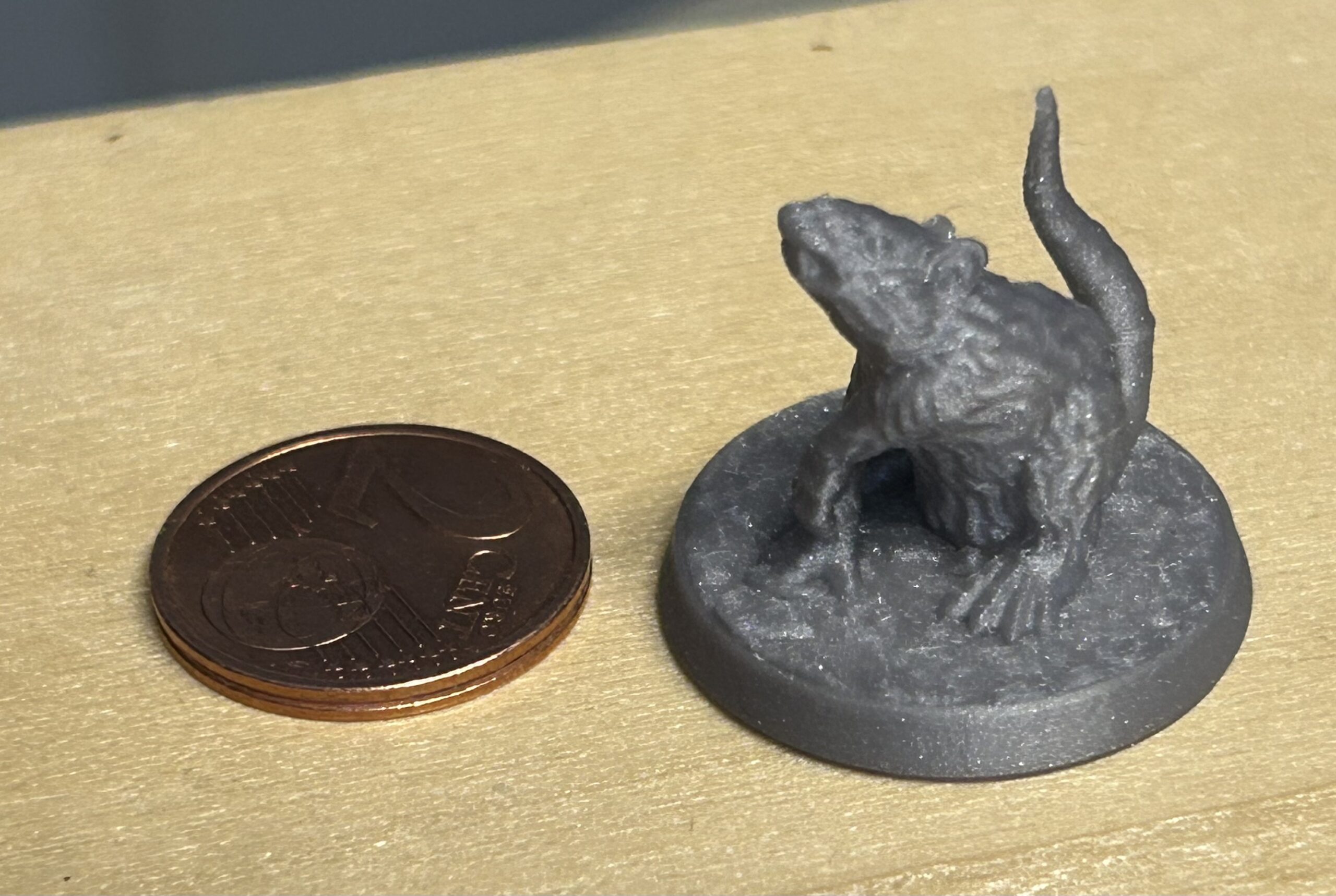

circlesmiler
(@circlesmiler)
RE: Print settings for 0.25mm nozzle and PLA
Hello,
I try to print miniatures since some weeks now. That's my current result:
My learnings/thoughts:
  • With 0.4mm nozzle I had no chance to reduce stringing to an acceptable level at a 0.1mm layer height. (I'm sure this can be solved, but I gave up)
  • I use 0.2mm nozzle now which solved the stringing problem.
  • 0.1 - 0.07mm layer height works fine for me
  • First layer should always be thicker. Use 1.5mm or 2mm. (I had problems (bed adhesion) with 2mm which is expected because your layer height should be max. 80% of nozzle size)
  • I had a clogged nozzle sometimes, so I reduced the nozzle temperature.
    This seems to be a tricky part, because the first layer must be very sticky to the bed. The following layers may not be too cold because it seems this can result in warping.
    • First layer: 210°C
    • Following layers: 200°C (I also had success with 190°C... this really depends on your filament, your environment temperature (enclosure) and so on...)
    • I've read a lot about using “higher temperatures” so that the filament comes out of the nozzle more easily. However, this seems to be counter intuitive as it makes clogging worse.
  • Go slow... but not too slow.
    • I mainly used the Prusa Slicer settings for 0.25mm nozzle and 0.07mm detailed print profile. (Use an existing profile that fits your nozzle/printer to have a starting point. If you do not have a perfect match to your nozzle size you have to change the extrusion width!!! See here: https://help.prusa3d.com/article/creating-profiles-for-different-nozzles_127540 )
    • I reduced the perimeter speed to 60mm/s. Outer perimeter to 40mm/s.
    • My thoughts to this:
      • Lower speed can result in better quality, but think about the filament that is cooking inside your nozzle. I think that if you print slow, you maybe want to reduce the nozzle temperature.
      • Keep the speed more or less constant. The combination of speed and nozzle/filament temperature seems to be important.
  • "One small object" VS "A lot of small objects"
    • Check your bed level!!! Keep in mind that you only print a 1.5mm thick first layer. Your bed must be leveled correctly so that the first layer has the same good quality at every position on your bed. Maybe it's worth to have a look to this bed level guide: https://help.prusa3d.com/article/bed-level-correction_2267
    • The layers have much more time to cool down if you print more objects. This can have an effect on less stringing or less warping.
    • If you only want to print one piece with very thin fine elements like a sword, you maybe want to add another object with the same height that works as a "slow down the cooling" object. (You could use a cube in vase mode/1 layer wall and no infill and no top layer)
I hope this will help you.
Some tipps when trying things out:
  • Choose a representative object. (Maybe only print a part of this object by cutting it and add a brim/raft, if you left the plate) This will save you a lot of time!
  • Observe exactly what the problem is. Watch the printing.
  • Choose one problem at a time and work on that.
  • Try to understand the physical problem. This is maybe not so easy at the first time, but if you understand what the reason for the problem is it's much easier to fix it.
  • Only change one parameter at a time.
  • Make small steps.
  • Keep calm and take your time. 🙂
I hope this will help someone in the future. Also read the previous post. It contains good settings (but no explanations why they are good).
