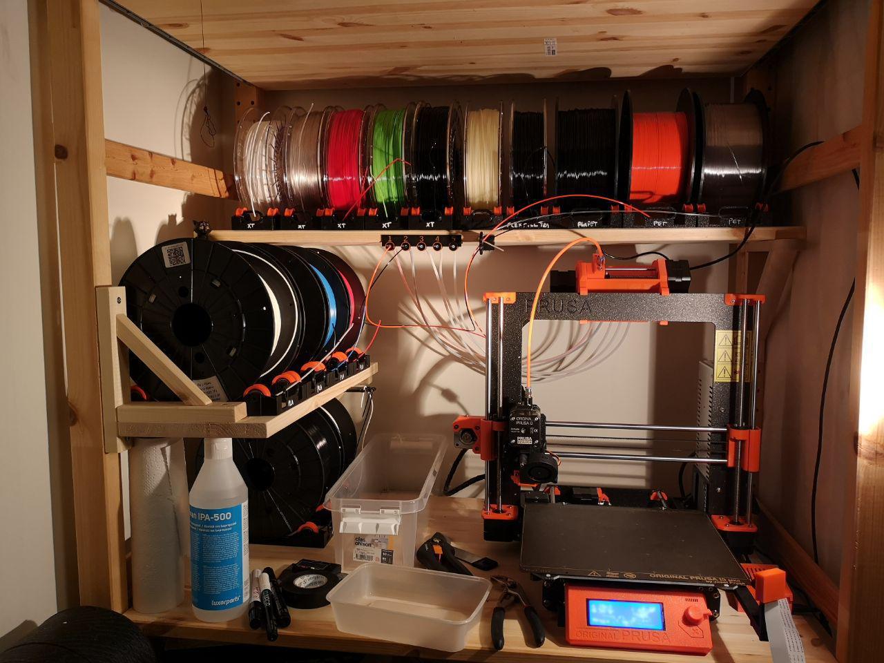

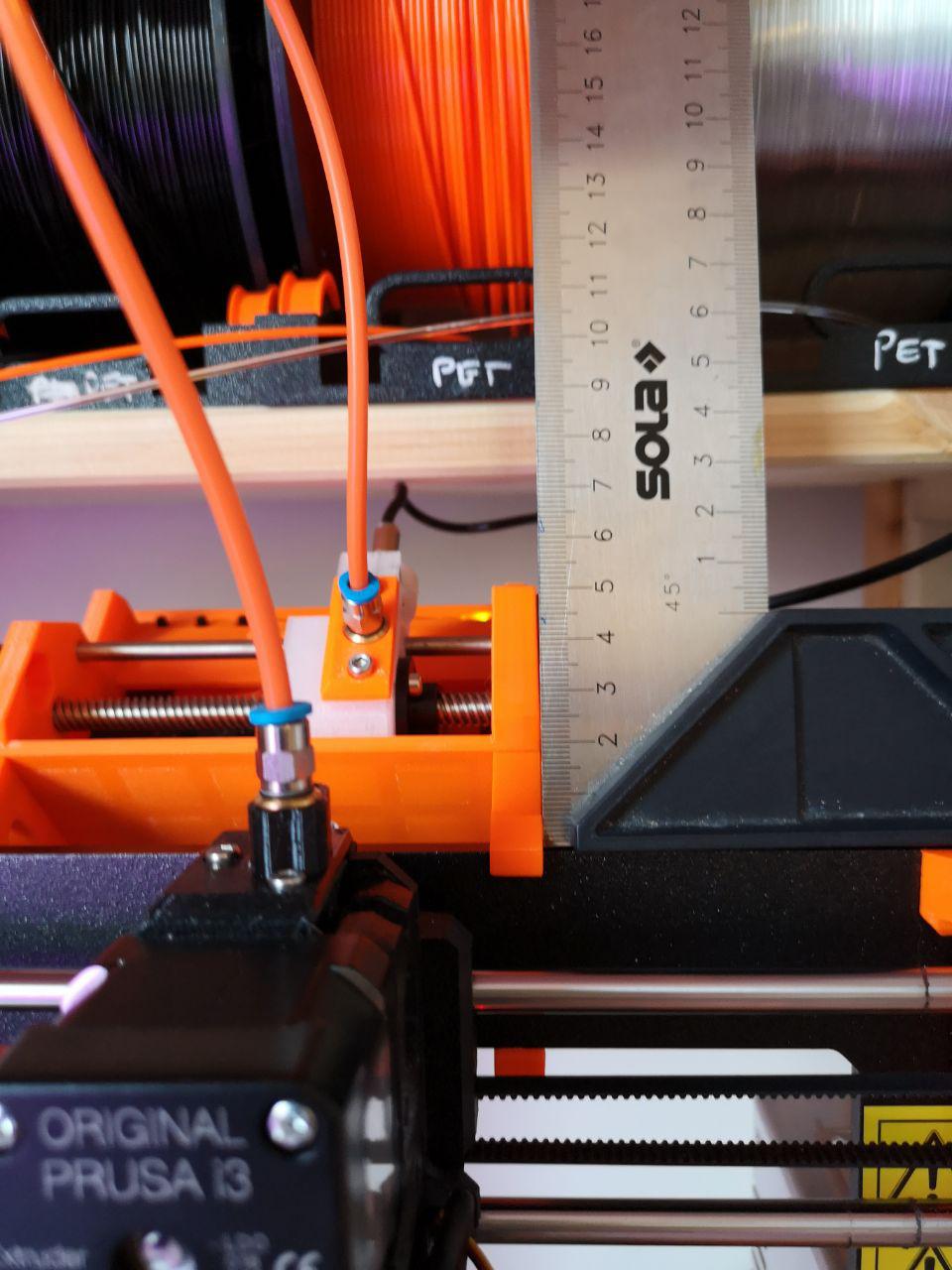

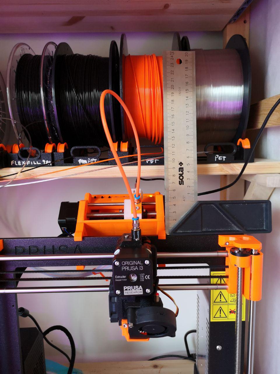

It adds about 7.5cm above the frame itself, but the PFTE tube to the extruder can use up as much as 20cm above the frame:
And yes, that's a modded IKEA IVAR 80x50cm, but the camera arm pokes out about 10cm.
I didn't find the measuring tape but I hope the original MK3 needed space is easier to find online... the MMU2 can be moved and you can have a different PFTE tube, but it might require modded software - I'm not sure.

I'll see if I can find a measuring tape tomorrow if noone has solved it yet.
I do like my solution with an IKEA IVAR, I might cut plexiglass to make a "cover" for it at some point. But I'm not super motivated - I'm not usually in that room, the temperature is super even (22°C-25°C over most of the YEAR) and there's an air purifier so it's not very dusty...
(Spool holders and camera arm on my thingieverse: https://www.thingiverse.com/Mirar/designs )
