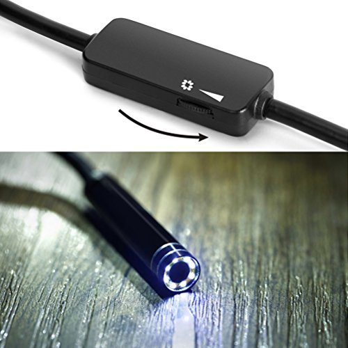

  • The camera I used is WiFi Wireless Endoscope,EletecPro Inspection Camera 2.0 Megapixel 720P HD.
    Any other similar camera will do. However if you regularly print ABS in an enclosure try to find one that works at a higher temperature than the 60°C that this one is rated at. It is however fine for PLA and PETG as the draft from the part cooling fan will stop it over heating. The camera mount is specifically tailored to this camera including ridges that align with the recessed printed rings on the camera.

    Sorry to revive a dead thread, but just wanted to say that borescopes are now very cheap! ($20!) and small. The diameter on the one that i ordered is about 5.5mm / .2 inches. I was able to use the modified cable guide/support from martin and didn't even need the lower "plate". I have more than 1-2mm of clearance... almost 6!
    https://www.amazon.com/gp/product/B07LCJY94K/
