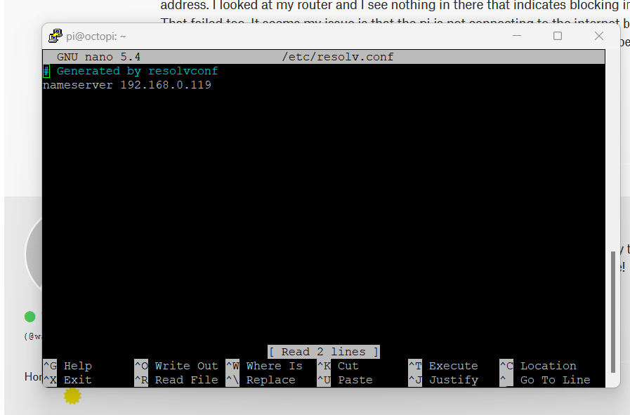

I tried *.8.8.8.8, 1.1.1.1, 9.9.9.9, 2.2.2.2. with octopi web interface. They ALL connect. Only hostname does not connect. I can ping the DNS but can't ping a web address. I looked at my router and I see nothing in there that indicates blocking internet access. I tried logging into the pi via putty and getting an "update". That failed too. It seems my issue is that the pi is not connecting to the internet but I have no idea why. I have googled this issue and found several posts on it but none of the suggestions I have tried fix the issue. Everything else seems to be working fine. I would sure like to get some of the plugins to make life easier. Wonder if there is a way to manually install them from the repository.

ok..I did sudo nano /etc/resolv.conf and got the attached screen. Is this correct??
Opublikowany : 06/10/2023 8:23 pm

RE: Can't get the webcam to work with Octoprint.
What is this IP address there? Is this your DNS server? If this is the IP of your Pi you have found the source of the problem. Replace it with "nameserver 8.8.8.8" and you will most certainly see a difference.
OMG!!! THAT WORKED!!!!
Thank you sooooooooooooooooooooooo much!

Thank you Walter. Actually, I had previously setup a static ip address in dhcpcd.conf to look like the following:
interface wlan0
static ip-address=192.168.0.119/24
static routers=192.168.0.1
static domain_name_servers=192.168.0.1
When I changed the /etc/resolv.conf file as you suggested earlier, it worked. But after I would reboot the pi, it stopped working again, After some thought I remembered I had set a static DNS server, So, I went back in and added the 8.8.8.8 etc and now even after a reboot, it works as it should.
interface wlan0
static domain_name_servers=8.8.8.8, 1.1.1.1, 9.9.9.9, 192.168.0.1
Again, thank you so much for all your help. I could not have done this without all the suggestions.
