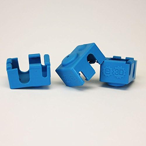

Which silicone socks do that?  For reference, let's have a look at the genuine e3d pro socks:
There are cutouts that allow the heater cartridge and temperature probe to enter the heater block, so I don't see that the sock offers any shielding to them, and especially not their wiring against an all-engulfing Blob of Doom.
Hmm. I thought I'd had some V6 socks that covered the wiring, but I must be thinking of the Volcano socks. Just had a look and am not finding any for the V6 that do... though I'm not sure why. Nevermind then. Perhaps one of the guys doing their own socks can give it a go? I vaguely recall somebody wrapping everything up in Kapton tape. There's an interesting discussion on the old ways here.
