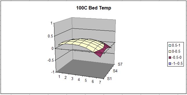

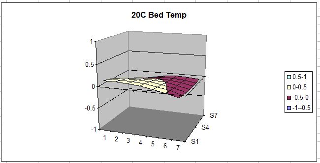

Note that the temperature of the bed has a large influence on these numbers.
Take a look at these graphs, with the Bed at 20, 50, and 100 degrees C:
yeah , apparently the pinda temp offsets don't really work as advestised.
look here, as well as the previous thread linked in the first post:
https://shop.prusa3d.com/forum/original-prusa-i3-mk3-f30/1st-layer-problems-in-depth-look-at-software-pinda-t14815.html

I can't leap to any conclusion regarding the Pinda calibration info- it could very well be that the numbers spit out with the G81 command are PRE-correction. I've not looked into the code yet to determine this. What I do know is that I don't have the Z-height problems that others have complained about here- mine is very consistent.
Posted : 11/03/2018 1:14 am

..... yeah , apparently the pinda temp offsets don't really work as advestised. .....
This is showing that the bed changes shape with thermal expansion. In order to verify the Pinda height sensor one would have to compare the height measured with feeler gages. The Pinda is probably reporting the bed height just as it is.
When I checked the mesh leveling and adjusted one corner the end result is that I had symmetry but the center was still higher than the outsides. The difference is very small. I considered the idea of shortening the center spacer to compensate or putting shims under all of the other spacers except the middle one. However, since this slight crown never affects my prints I just left it.
Posted : 11/03/2018 11:47 am
thrawn86
(@thrawn86)
Re: View Mesh Bed Leveling Data
I should have clarified: there was discussion in the previous thread about exactly that, several of us including myself have been shimming the standoffs to correct the bed level. support has said before that > .2 difference is not ideal and won't be compensated as well. Obviously the bed will expand but the larger issue is that the probe isn't compensating like it should be when it does expand or change. The temp calibration of the probe itself is the obvious suspect.
Posted : 11/03/2018 10:05 pm
themzlab
(@themzlab)
The results you get from the mesh level report are meant to feed the software during printing. One might say these are pre-compensation. The Pinda senses it's own temperature in order to measure distance correctly. If you want to find if it is doing the job you need to use feeler gages. Pinda is not supposed to adjust directly for different bed temperature but it's results will help the printer indirectly account for this.
