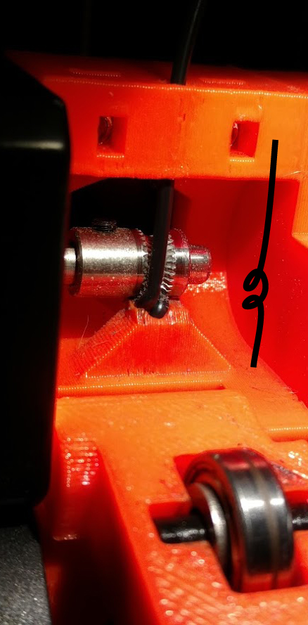

Roykinn7
(@roykinn7)
Re: Flex-Filament question.
Hi there, I'm using this exact filament currently, might I ask what settings you're using to achieve good results? My first prints with this Priline TPU came out good, but I think a setting or two got changed while switching between profiles in Cura and now it's not printing as well.
I do keep the stuff sealed in ziplock bag with very little air and a bunch of dessicant WITHIN a drybox while I'm not using it, so I don't think it's moisture, but it seems like extrusion is becoming an issue and the last two prints the filament curled up above the extruder gear.
Any help would be appreciated!

Roykinn7
(@roykinn7)
print slow at first. like very slow. see how fast it can go without curling at the extruder.
These last few prints I've actually been printing slower than the first few that came out perfect, 20mm/s rather than 30, I just confirmed via gcode settings.
I came home today to a print which started off fine, for the first 10mm vertically or so then started underextruding, then eventually extruding nothing.
It printed another 30mm or so as thin air until I came home to stop the print.
It's seems like the tpu could be getting clogged?? It bunches up right UNDER the extruder gear, not above as I said previously, like the gear is trying to push it through the tube and nozzle but it's getting stuck. I drew out what's happening over this pic to help explain since it's hard to see.
This is the third time I've gone and swapped it back out with PLA, at which point once the PLA had flushed out the rest of the TPU it extruded perfectly normal, I would think a clog would affect the PLA too?
This is so much more annoying than dialing in a filament because it printed very well for three 12+ hour prints in the beginning 👿
Any ideas?
edit: I should add that this Priline TPU is a very rigid TPU, I think the shore rating is like 98 or so, it's supposed to be one of the easiest TPUs to print, as I first thought myself when those three big prints came out perfectly.

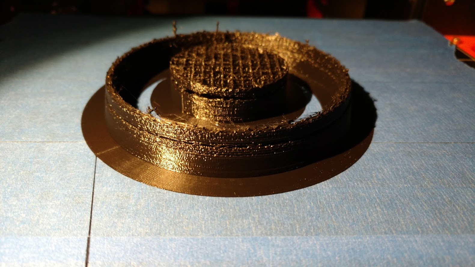

Update: Watched Maker's Muse video on printing TPU, my current print is coming out good so far, about 30mm vertically with no issue. The higher up it gets the rougher the walls look, but they're still even with no underextrusion.
What fixed it was (I think) a combination of printing slower at 15mm/s, a cold pull with PLA, adjusting Live Z down by 40um then compensating for lowered bed adheasion by changing first layer height from .15 to .25.
I'm pretty sure what was happening is the increased pressure within the nozzle caused by printing as I normally would with PLA (first layer squished real good to bed) was creating buildup in the nozzle, it would eventually cause the filament to kink right under the extruder gear because kinking got to be easier for the TPU that pushing through the nozzle against that pressure where PLA/ABS as rigid as they are wouldn't have a problem with this.
Very loose idler springs or almost as tight as PLA idler springs (14mm, not 13) changed nothing for me. Hot or cold bed changed nothing, 220c or 230c changed nothing. I'm pretty sure the speed, 15mm/s to 30/mms isn't the issue either as I'd been successful initially with the faster speed. I do know I had to run the Load Filament process 3 times with the PLA with which I was planning to cold pull before that white PLA was truly only white PLA with no black TPU mixed in, but the cold pull came out clean, so that may not have even helped. I have to guess that the initial printing done with this spool about 3 weeks I must have had the bed a bit lower like I do now, though I could have sworn I set it to print a first layer like I would PLA when I put the blue tape down so who the hell knows 😡
