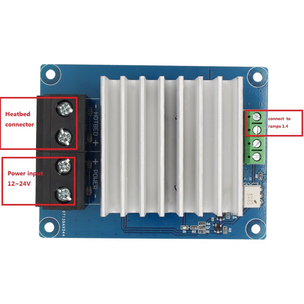

It seems like Q5 on the Mini Rambo could use a heat sink since that mosfet handles the largest load.
The location of the heat sink on mosfet Q5 would be under the label Fan1 and Fan2:
Would I be able to use this TriGorilla 3D Printer Heating Controller MKS MOSFET to offload current from the mini rambo?
Also, using the TriGorilla I should be able to add a 24V power supply to power the heater bed but could this cause any damage?
I'm not sure how I would wire in the green terminals but I think I would only need to use 2 of the 4 terminals based on the verbiage below.
Steps 4 and 5 seem to mean only use (Gnd and D8) or (the RAMPS mosfet +/- bed terminals) but do not hook up both (choose one signal group). Please let me know if that is the same interpretation you came up with.
Specification:
Usage :
1. Connect Power to power source, please note the anode and cathode
2. Connect Hotbed to heated wire , please note the anode and cathode
3. Connect digital control signal to Gnd ,D8
4. Connect the control signal of Ramps1.4 or MKS MOSFET to -Bed+
5. Choose one signal group to connect

In looking at this again I think the 2 sets of inputs are basically a 5v trigger (GND, D8) and/or a 12v trigger ( Bed - / Bed +).
I will need to do more testing.
