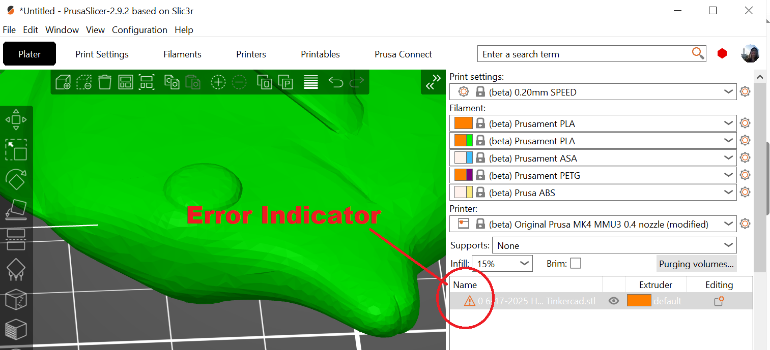

I recently purchased a used MK3S, and I have sometimes had prints fail in a repeatable way. At a certain z-height, the extruder will move to the front of the bed, pause for a bit, move up several millimeters, and then resume printing in the air above the print. You can see this happen in the following video, starting at about 22 seconds IMG_6733
If I re-print the same file, it will fail at the same height.
I have tried reinstalling the firmware. I have checked the gcode, both manually and in PrusaSlicer and I do not see this Z-axis movement anywhere. The only thing that seems to help is selecting "Fix by Windows repair algorithm" in PrusaSlicer before slicing.
Does anyone have ideas on how to solve this? I suppose that the repair algorithm works, but if I forget this step, I would hate to lose a print when it is mostly finished.

Most of the time, a defective STL will show an error marking in the right hand section of the Prusa Slicer window, See image below!
if you see this, use the repair algorythm immediately...
Please be aware, if you use the Prusa slicer CUT tool, you can often get new errors in the cut model...
So look for the marker1
But beware, sometimes Prusa slicer does not indicate an error, but errors can still exist, so... if something looks screwey in the sliced model, try repairing it anyway

Thanks so much for your detailed answer! I will definitely be extra careful to check for the warning messages. I've only been using PrusaSlicer for about a month, and I have been using Cura for the past three years, so I definitely have some new things to learn.
When importing one of the troublesome models, I did see this message:
"40 degenerate faces, 40 facets removed"
