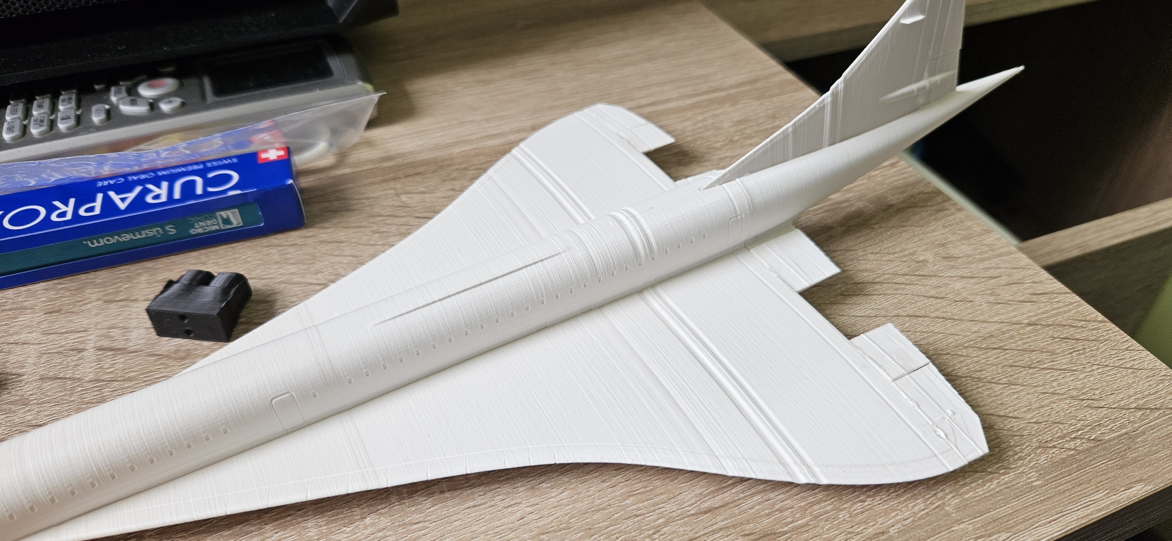

Hello! I own a Prusa MK3S+ with a REVO Six and 2 Print Fans Upgrade.
I seem to be experiencing, X or Y layer shifts on a certain Z-height. This was happening even before I wrote this post but now have just gotten to fixing it due to having time. I have my belts tensioned quite a lot , I believe substantially. I am attaching an image of my latest print in white PLA where the artifacts are extremely visible.
What can this be caused by? Belt tension as mentioned seems to be good. Thanks !

Did you check to make sure the grub screws on the motor shafts are tight?
