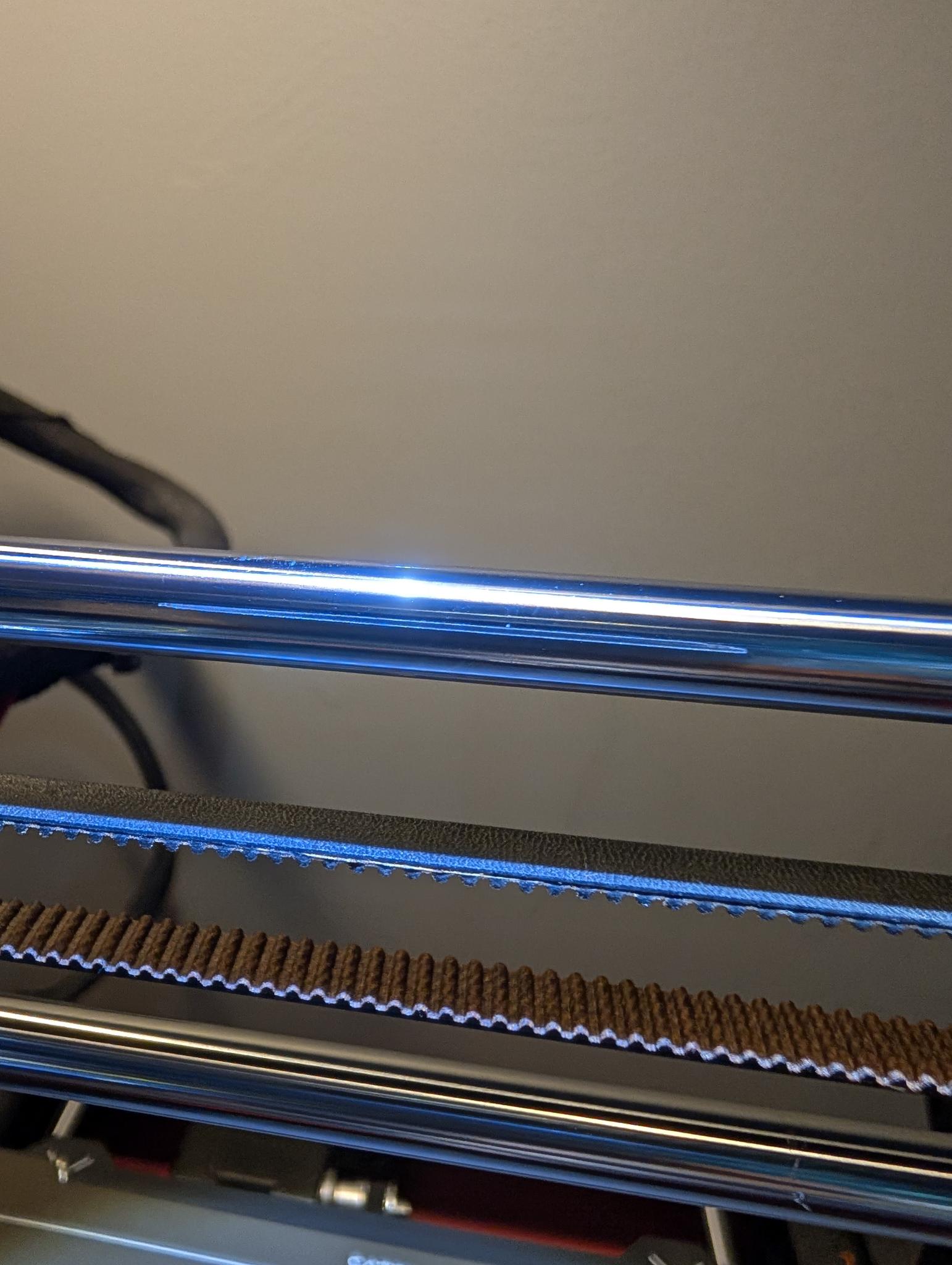

I'm trying to print this telescoping sword for a Halloween costume, but I'm having trouble with wobble.  The sword blade segments are tall, thin, PETG, and vase mode, so the wobble factor is high.  I had to scale it down to 80% size to fit in the MK3's print volume and my kids' hands, but that also exacerbated the thinness.  This seems to be a worst-case scenario for wobble, so I'm looking for any advice on how to get these printed straight and true.

Update, I started going through the regular maintenance guide and found a scratch on the top X axis rod.  I'm trying the print again in a part of the print bed that won't overlap with the scratch.

Sometimes a print wobble in a tall, thin part is exacerbated by resonance, a small change in speed, faster or slower, might be enough to de-tune the problem.
You may be able to rotate the rod by a few degrees, enough to move the rough spot away from the bearing point until you can do serious repairs.  There is a possibility your linear bearing(s) is/are damaged as well as the rod but both are available as spares.

Thanks for your message, @diem.  I have tried many different speeds, see the OP, and the difference was noticeable but minimal.  The one thing I didn't try was going faster.  After moving away from the scratched area, the print was much better.  There's still a bit of wobble, but far less.  I also discovered several similar scratches in other parts of the rod.  Maybe dry or damaged bearings. 🙁
I'll replace the rod and clean or replace the bearings, add some new lubricant, and hopefully it'll be good as new.  Thanks again @diem.
