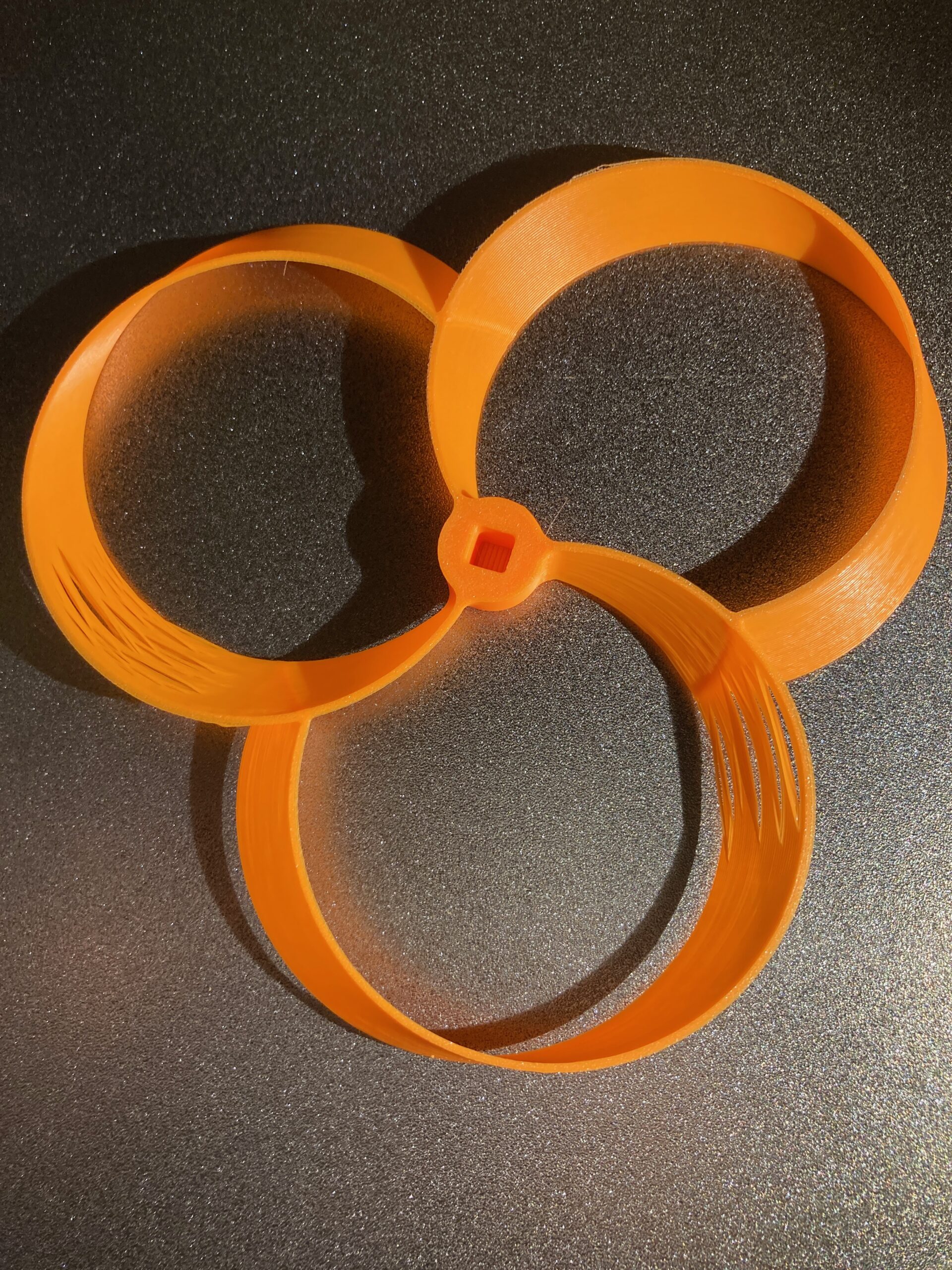

why doesn't this print now? It has before
This has printed perfectly before. This week, before and after a new print bed and a couple of complete re-calibrations, it won't. The workpieces consistently show those gaps you can see in one of the toroid "blades." That was not the case a couple of weeks ago. Same filament, same machine. Seems almost if if the bed is not level but how did that come to be and why isn't it being picked up in the calibration process?

First off how's your first layer looking there is a chance the new printbed isn't level my favorite way to test that is print a 1 layer thick square the size of the bed that will Also insure the first layer is dialed in correctly
Posted : 13/10/2023 9:18 am
Your first layer looks OK.  If it has printed well before it's likely to be a filament issue; have you kept it dry?  Have you  printed a different type of filament in the interim?
What is the filament?
Posted : 13/10/2023 10:12 am

it's Prusament. It was bagged up before this job. Lots of other colors and filaments have been run through it. I just ran a much more involved job overnight and those pieces look OK, no thin layers or sections like this though.
Posted : 13/10/2023 12:34 pm
If it hadn't printed OK before I'd have asked to see the project file.  As it's been out at this time of year it's worth drying the filament - then print a little slower to aid interlayer adhesion.
If you have used any higher temperature filaments purging by manually pushing some PLA through at the higher melt temperature should shift anything left behind.
Posted : 13/10/2023 2:02 pm

I am not that sophisticated as to run different temperatures for different flavors of PLA. I know the various slicers can manage all that. If I can tame some of these issues, I can drill down into the specifics of that. But I'm not investing the time in that just yet. I have this filament in a sealed bag with large dessicant pack, I'll see about running it again a day or two. The fact that the artifacts show in the same places on every print are curious, as if the bed is out of compliance. I'd expect more randomness, maybe a chunky first layer, but I am not seeing that. It's always the same…what look like inter-layer gaps in the same places.
Posted : 13/10/2023 2:24 pm
RE: why doesn't this print now? It has before
With the curved perimeters and the slope the ga-a you see are caused when the layer being laid down does not adhere to the previous layer. It’s probably not related to bed level at that point, it’s far more likely to be environmental factors or the filament taking on moisture. Colder ambient temperatures for example. Which is why Diem suggested slowing the print down. This gives more time for the layer to adhere. Printing hotter can do the same thing.
Also just because it’s stored with desiccant does not mean it’s has not taken on moisture.
Posted : 13/10/2023 2:56 pm
OK, I wondered if you'd been printing PETG or similar and left residues.  Dessicant doesn't dry filament, it does slow down the rate of water absorption but don't rely on it for long periods.
Go back and check the same places in parts you printed before - perhaps there was an issue that went unnoticed.  If so: save your project as a .3mf file
Files > Save Project as
Posted : 13/10/2023 3:01 pm

It looks like some of the print isint touching the bed and some is am I right

That's top and bottom of one piece so no, it's not all in contact with the print bed. I removed it to inspect it, then thought maybe someone here could add some clarity.

Same design/STL printed on an AnyCubic mega S. Looks good. No gaps between layers or any of that.
Posted : 14/10/2023 10:21 pm
I printed it with your settings and freshly dried Prusa PLA - it came out perfectly so you probably have a filament issue.
Having said that - the part is very light, too light in my opinion as it is likely to distort in operation.  The thickness allows for just two strands of filament to be laid down in each layer, I would thicken it to allow for some semblance of an aerofoil profile incidentally increasing the stiffness.
Do you gain much thrust to power ratio advantage with this part?
Posted : 15/10/2023 1:21 pm
