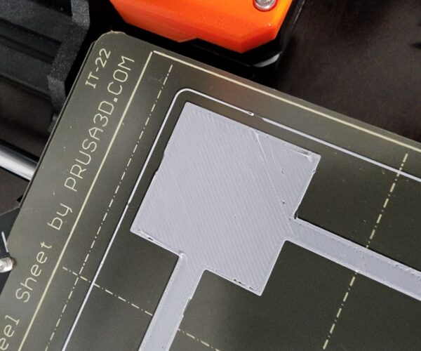

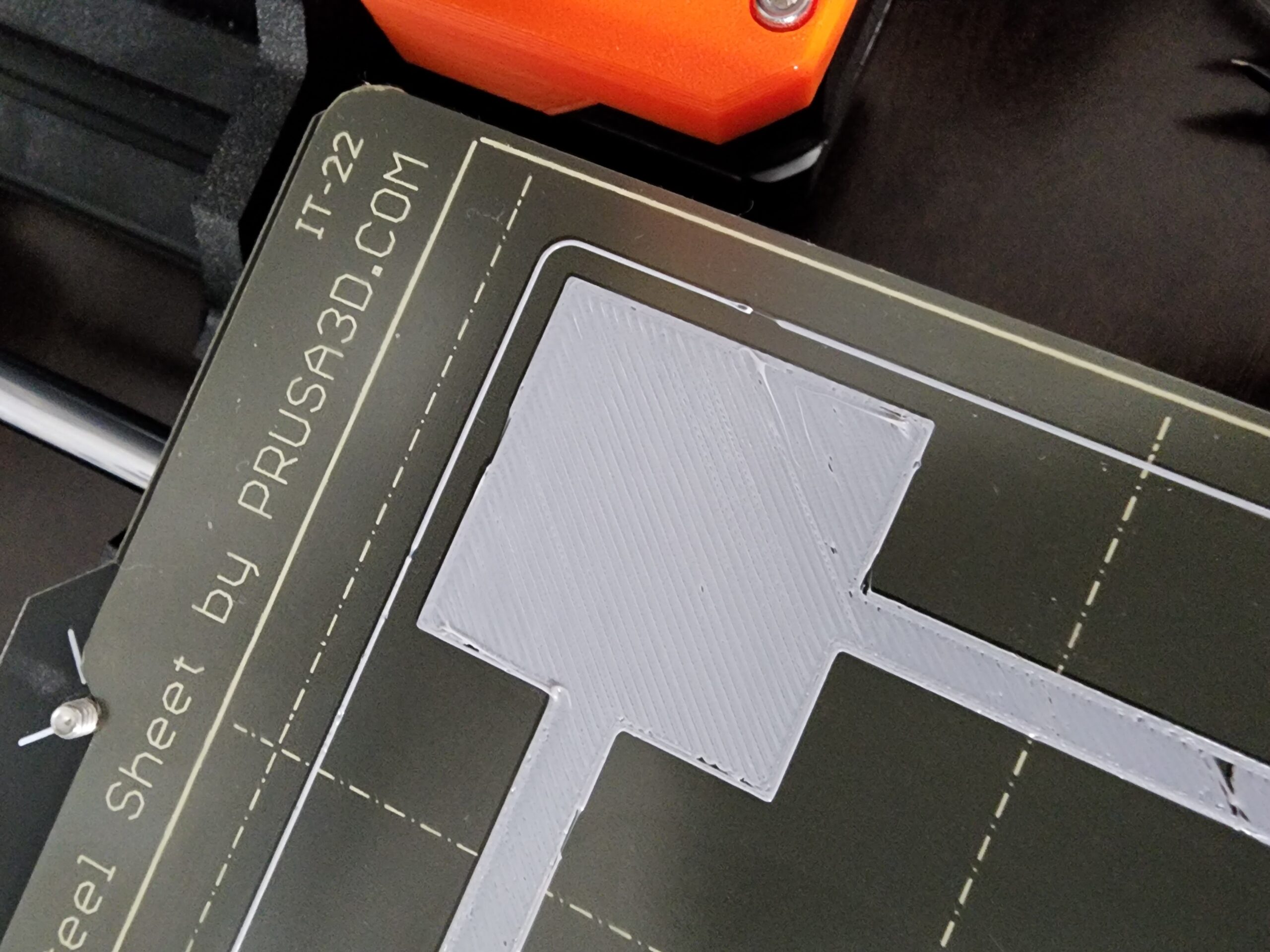

What is my issue? Please see the picture, Please suggest what do i need to do to fix this..
outkasst
(@outkasst)
Looks like somehow filament is NOT dispensing properly..
I tried adjusting height, can anyone tell me what could be the issue here?
Temp adjustment doesnt help either..
I just changed Nozzle , Can this be a Nozzle issue? Where can i get good Nozzle for MK3S+
Material is : Flexible TPU, I have printed the same material pretty good in the past on the same machine..
thx in advance to ALL the Experts!

This is either not low enough or a wet filament.  The images are not fo great quality.

Maybe try adjusting the tension of the idler. I print TPU with lower tension to avoid filament grinding when printing larger objects, this doesn't seem to be an issue for you but maybe it would help. Also try printing something smaller with the same material, for example a small cube 20x20 mm base dimensions. What is the speed for the base layer?
Can you print other materials like PLA normally?
