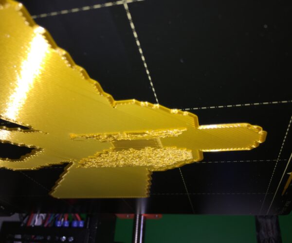

Weird bumpiness
So, could anyone explain why this is happening and how to fix it? This has happened so many times and nothing I does fixes it

That is poor extrusion.  It might be a partial jam.

@charles-h13 Hey you were right! Thanks a lot.
