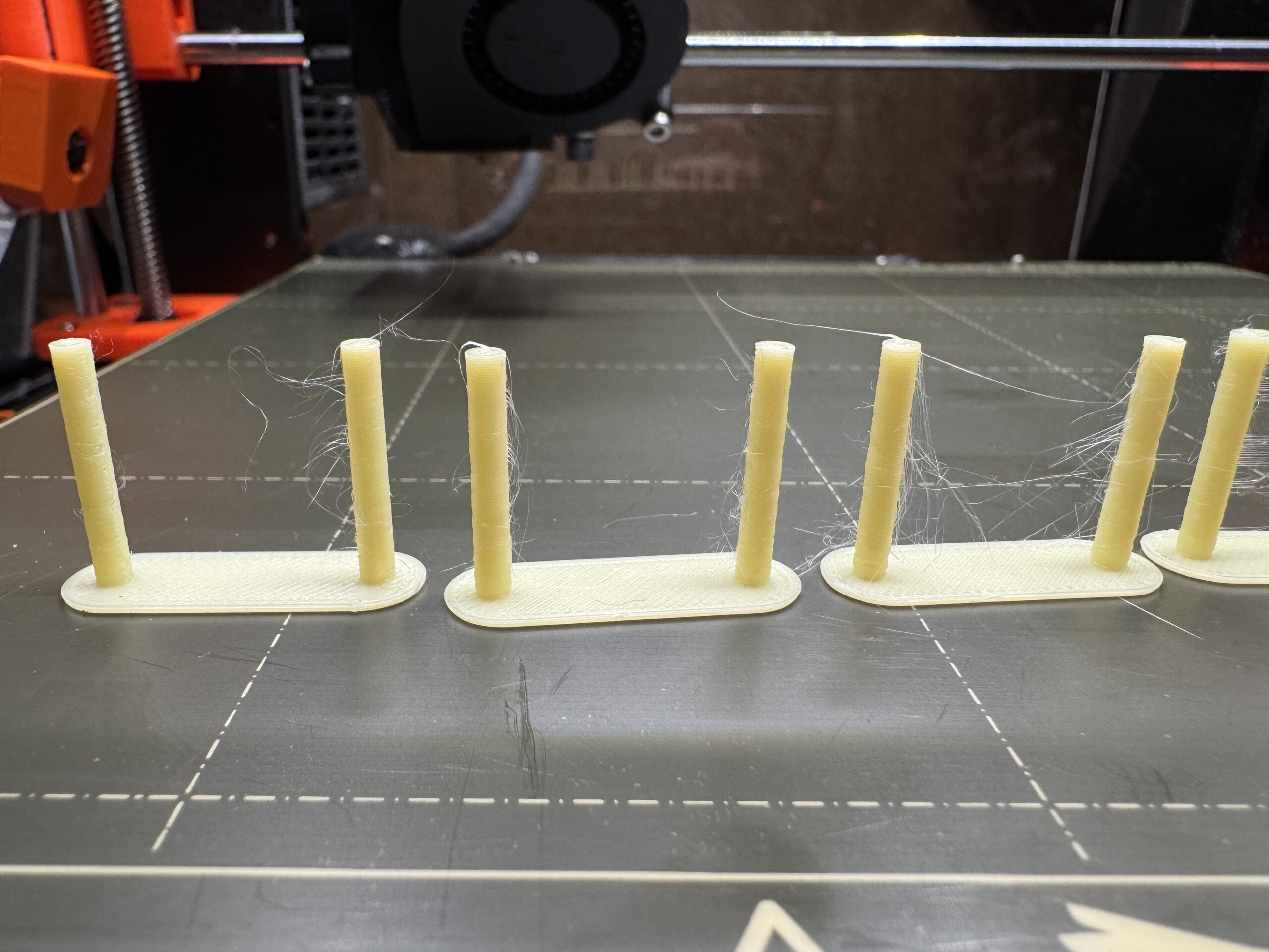

Hi everyone, I’m at my wit’s end. I think I’ve tried just about everything I could find on this forum and others. I’ve printed countless stringing towers, but my issue with stringing persists. No matter what I change, it seems to have little to no effect on the degree of stringing.
I have an MK3S+ without an MMU. I print with Sunlu PLA+ spools, which have been actively dried (just to be sure). I’ve tried different colors from different batches. I started with the default settings and from there made small, incremental adjustments. I’ve experimented with:
- Filament temperature
- Retraction length and speed
- With and without Z-lift, and different Z-lift heights
- Extrusion rate
I’ve even replaced the nozzle with a new one. No matter what I tweak, the results barely change.
I’m starting to suspect that there might be a hardware issue with the printer.
Any ideas?

Please show us a picture of the issue.
Posted : 20/02/2025 4:26 pm

these ones are all from after the nozzle change (made absolutly no difference btw)
1. T195/215 Rl2,4 Rs100 z-lift 0,4 em 1,0
2. T195/215 Rl2 Rs80 z-lift 0,4 em 1,0
3. T195/215 Rl0,4 Rs35 z-lift 0,2 em 1,0
4. T195215 Rl0,8 Rs35 z-lift 0,4 em 1,0
5. T195/215 Rl0,8 Rs35 z-lift 0,4 em 0,95
6. T195 Rl0,8 Rs35 z-lift 0,4 em 0,92
within the higher towers i changed the temperature around every 1/3 of the height with increments of 10 degrees
T=temperature
Rl=retraction length
Rs=retraction speed
em = extrusion multiplier
retract on layer change is on
This post was modified 11 months ago by voord099
Posted : 20/02/2025 4:52 pm
For how long did you dry the filament?  That still looks damp.  Try a few hours more and print at 205°C.  White and pastel filaments are always troublesome so test also with a dark colour.

It's in the dryer for more than one week already. I 'shocked' the filament with a 9 hours @ 55 degree. after that the dryer goes into maintance mode. where is keeps the humidty at a controlled level between 20-25%.
I've a wide variety of colors, from lighter colors up to brown and black. The stringing problem persists true the entire color range.
