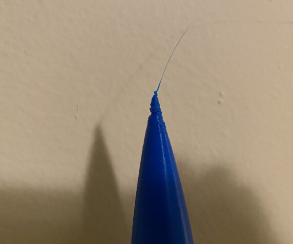

I am trying to get my nose cone tips perfect.  I have difficulty with them even after 2 years.  Any tips on printing these with PETG and ABS?

Your tip looks - stringy...
The tip is a very small surface area. It will get really hot... Try dropping your nozzle temp 10 degrees for the top 20 layers.
(don't blame me if your nozzle clogs at the tip...)
And maybe bump up your print fan in that area - same reason.

Along with the above suggestions on fan speed make sure the settings under filament>cooling for 'Slow down if layer print time is below' is set to something small like 2-3 seconds and set the Min print speed there to a faster value like 25-30mm/s
When it comes to those very small areas it does then so quickly that it triggers the layer time so slows right down, that leads to the nozzle staying in the same area too long and it ends up printing on top of layers that haven't cooled down.

I tried slowing it down and lowering them-erasure.   It got worse on two successive printers.  I am going to try upping the fan speed and speeding the print up to like 40 mm/s.

This might be a waste of filament, but if you don't need to print two nose cones (to give one a chance to cool each layer while a layer is being put on the other), you could try a sacrificial cylinder. Try adding a (blind diameter guess) 1cm diameter cylinder of the same height as the nose cone with 3 perimeters, a couple bottom layers to help adhesion, no infill, no top layers. I think this might minimize waste while hopefully letting the small nosecone tip cool between layers.
Just for chuckles, I just sliced a 10mm dia x 200mm tall cylinder with 4 bottom layers, 3 perimeters, zero infill, zero top layers using the Prusament PETG filament profile and it uses 8.56g of filament for a waste of $0.21USD. I can't guarantee that it will work, but it might be worth trying once. (Lowering the diameter to 5mm reduces the waste to 3.64g/$0.09USD, but I'm not sure if something that thin will be stable and avoid falling over all the way up to 200mm...)

I got it to print 15% infill, up the fan speed to cool the print, and sped up the print to 45mm/s.  It works.

RE: Sharp top edges
@ Bobstro
Any ideas now on how to get PETG to print better on this tip?
I set the fan on 80 min and 100 max.
I set the fan to come one when the level is 30 seconds or longer and slow down to 15mm/s.  Any other adjustments?

Ok.  Here is a photo.  The tips are less than ideal.
