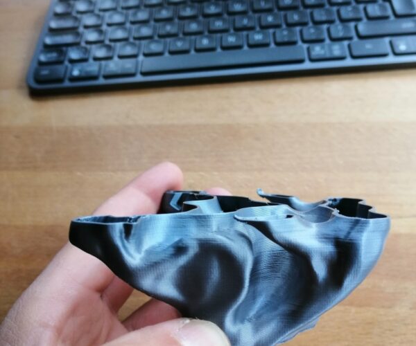

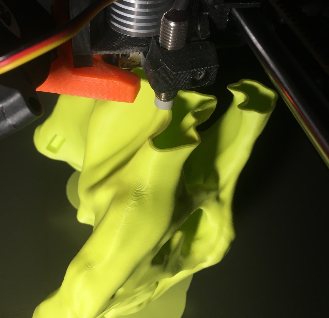

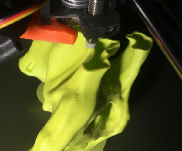

I tried printing the T Rex model, described in a blog by Jan Olejnik. The model was downloaded from Thingiverse.com and scaled in PrusaSlicer up to 200% as described in the article. I own a stock Mk3s, and used Prusa PLA for the print. As described furthermore, I used a brim of 15mm, no supports, no infill, a 0.4mm extruder and, 0.15 mm layer thickness.
Upon till now, I did 2 attempts; 1) nozzle temp of 205/200 and 2) nozzle temp of 215/210. At the second attempt, I also changed the model's orientation by rotating over z-axis by 90 degrees. In both cases the print fan was 100% on.

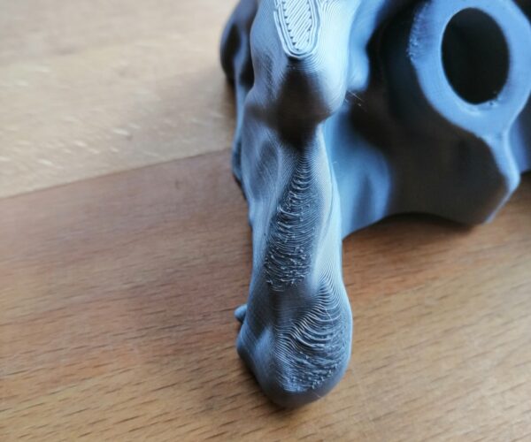

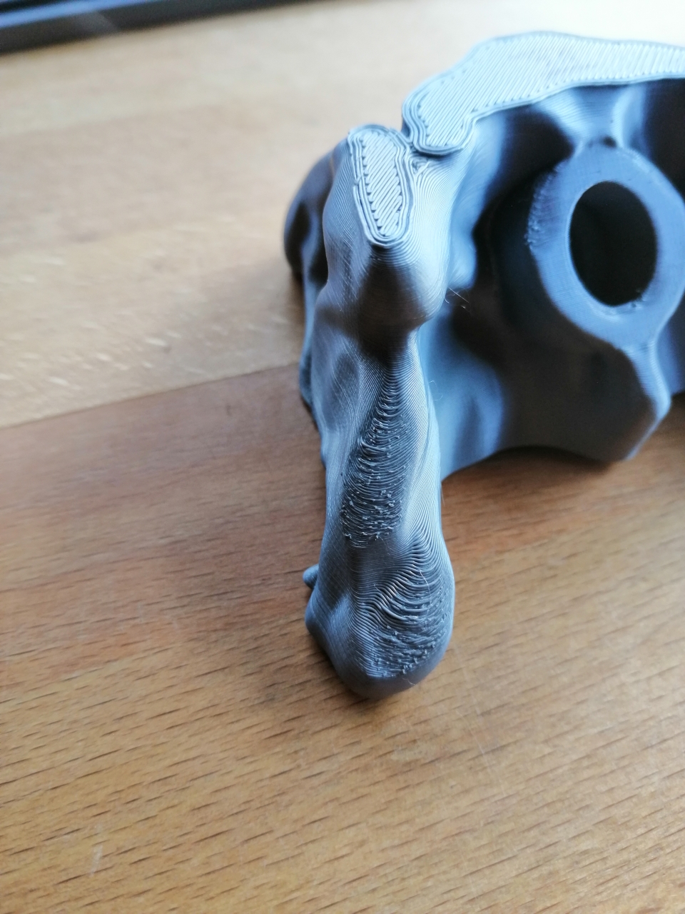

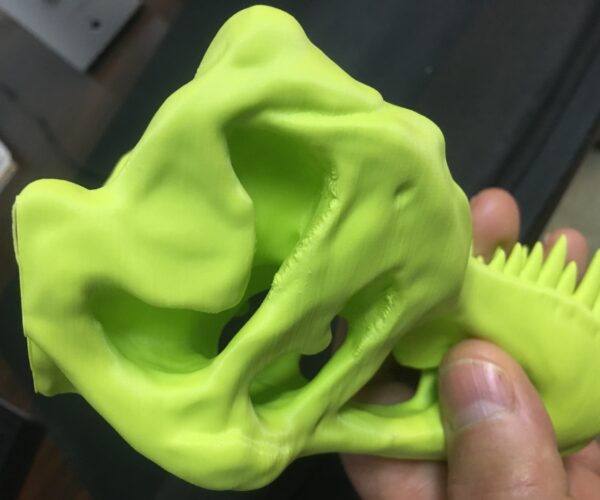

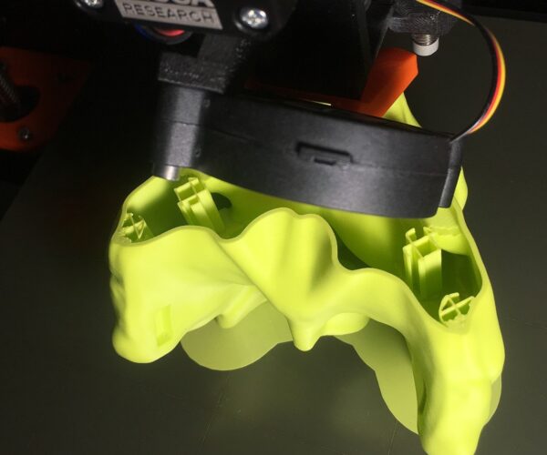

In both cases the printer crashed at the point where the PLA tends to raise (warp) from the surface.

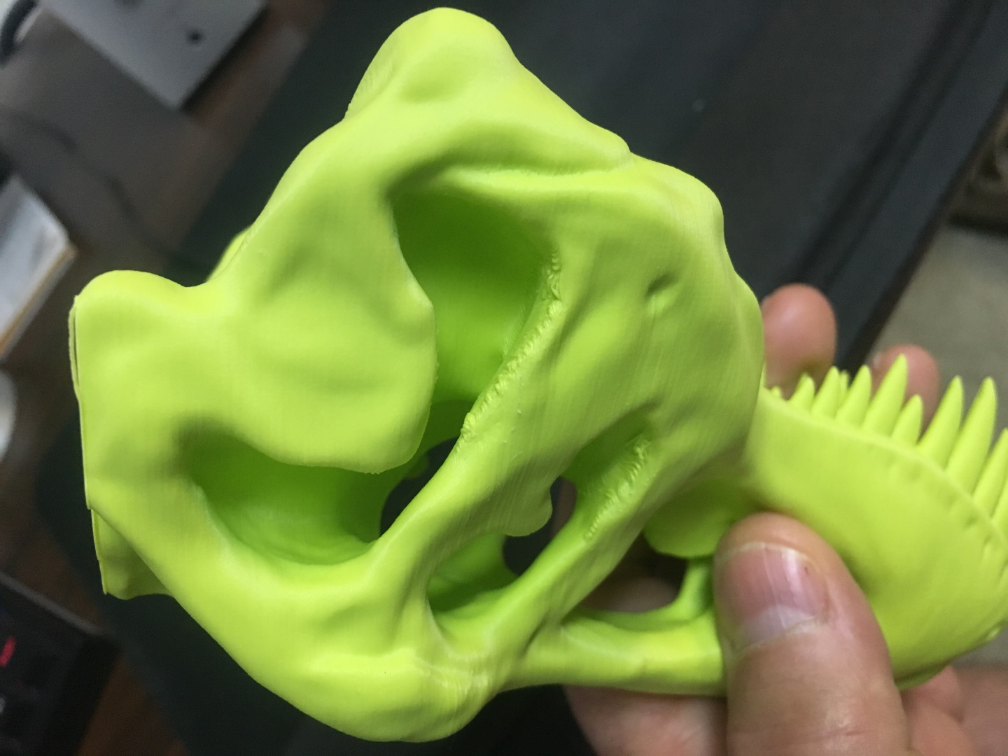

On the bottom exterior, in an earlier print stage it is clear that several other layers weren't that pretty as well:
Can someone help me out? For me it would be really helpful to get some details upon settings I should use in PrusaSlicer.

Not sure I understand the specific issue? I get the crash but it seems it's because you're seeing warping despite using a (quite large) brim? If so, my first thought would be imperfectly cleaned steel sheet (use hot water and dish-washing soap without additives) and/or imperfect Live Z calibration.

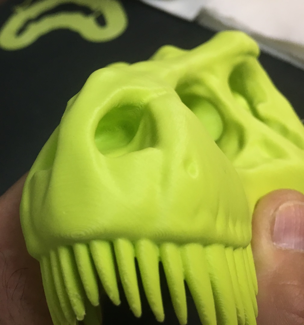

What you seeing in picture 2 is just the imperfections you'd expect from steep overhangs. The printer can't lay down filament in thin air, so it will sag. Supports may help but even with supports you're likely to see imperfections just like what you have here, which isn't bad. IMHO, your best option for this is sandpaper/dremeling.

RE: Printing a 200% T Rex; crashing issues
@bas-raas
I suspect you are having a cooling issue, if you can try turning the parts that are curling up so that they get the most straight forward exposure to the fan, steep over hanging areas that require a lot of (ensured vertical shell thickness) are especially susceptible to this behavior. with some filaments you can use heat to help this and with other filaments to much heat will cause it, so you have to know your material.

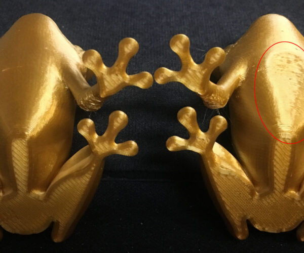

A small example of this.
The over hang on this tree frog model is curling upwards as it prints, it's very thin and flat and the nozzle passes over it many times trying to " ensured vertical shell thickness" in this case it's necessary to do so, however this silk filament (PLA) doesn't respond well to this situation at the temperature I might normally print this Frog (215C) the problem is solved in this case by turning the temperature up 5C to 220C and the problem goes away. (if this was Hatchbox brand I would have printed it at 205C) this can also be accomplished in some cases by reducing the fan speed for a part of the model or re orienting the models position to the fan, or even using a different filament. you will have to experiment with your specific model and filament to get it right. There are many possible fixes to this problem others may include, slowing the print down, turning off "ensured vertical shell thickness" <-- although slicer will still try, it changes the results, and changing the infill type and density can have an effect as well.
If it was me, I would try printing it 215C even 220C knowing its prusament, my experience has shown me that prusaments print better at hotter temps.

something I meant to mention, but forgot to as I was addressing the curling issue your having. whether it's effecting your print or not, in your second photo your Z looks to high it should be lower, and if your using a brim you should turn off elephant foot compensation.

To be honest, good luck with this. I looked at the original blog post ( https://blog.prusaprinters.org/cool-prints-from-our-office-t-rex-boxer-engine-3d-clocks_8492/) and he makes it sound easy but if I look at the model, I don't see how you could possibly get decent results without supports. But hey, I've seen stranger things happen. I would also go with 10% adaptive cubic infill, to provide a bit more support to all of the internal overhangs. It is a tall model, with a small surface connection to the sheet, so at greater heights, I wouldn't be surprised to see some vibrations that may lead to crashes.

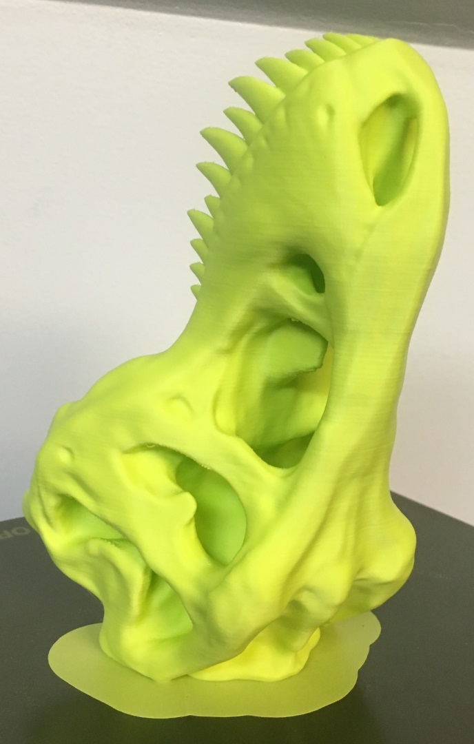

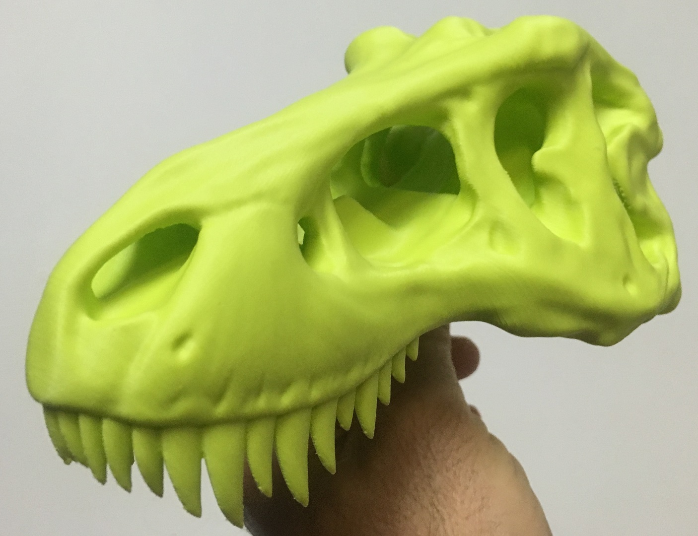

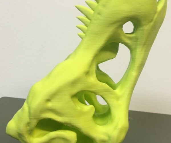

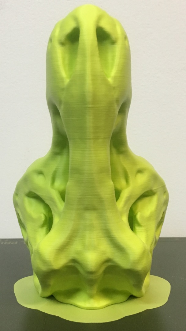

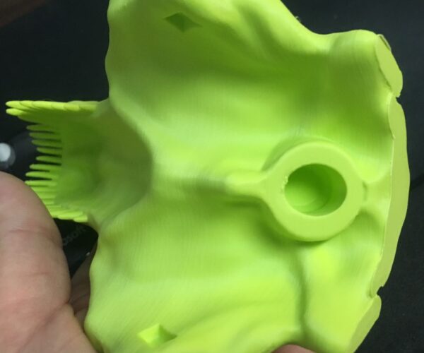

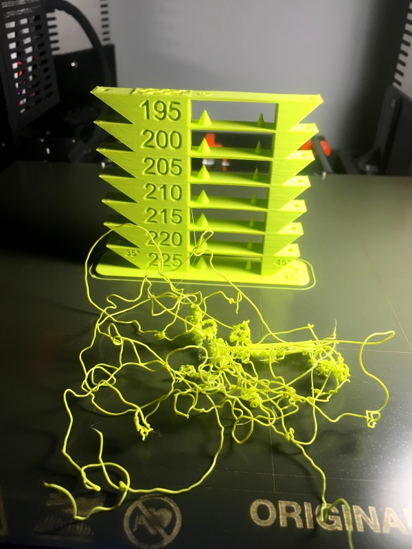

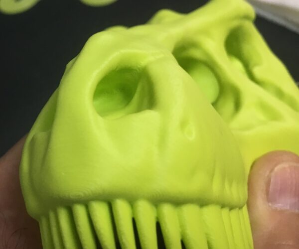

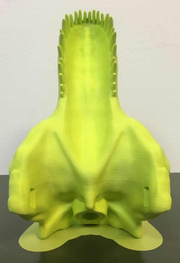

I got a roll of filament that I hadn't tried yet so I decided to try it out on the 200% T Rex I first printed a temp tower for the PLA because I've never used this type before, I ended up going with 200C it had the best bridging (A quality needed for this project).
Note: 190C didn't print at all and the manufacture spec was 190 - 220C.
This is one of the reasons I always start off hot with my temp towers.

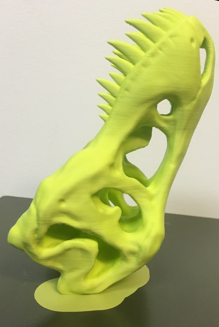

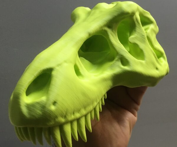

I loaded the original Skull from Thingiverse, downloaded years ago,(I assume it's the same) scaled it 200% rotated it 180 degrees, sliced it for 3 perimeters, I did some selective infill at 20% in areas that I felt might not be supported well otherwise, (can be seen in the photos, its internal only.)
The following photos were taken under florescent light for the specific purpose of showing the layers and how it printed, they are not very noticeable otherwise.
(non florescent light photo)
(Possible problem areas)
Although I think they printed just fine, the areas are at about 70 degrees or more! and unsupported, however the 3 perimeters allows for plenty of structure in these areas for sanding and post processing. they didn't cause any crashes or offer any cause for alarm during the entire 10 hour 27min print.
(be sure to pay attention to the nostril)
printed @ 0.15 quality, No external supports aside from a 15mm brim were used, Ensure vertical shell thickness was turned off, elephant foot comp off, I'm sure I'm forgetting some other info, but that's the gist of it, I really like this color and the model seems fun, I think it prints just fine your not going to get a 100% perfect version of this, although I do think I could tune it feather and get it really close. I may actually try and finish this in this color : )
