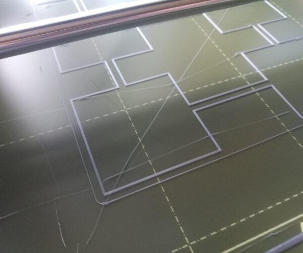

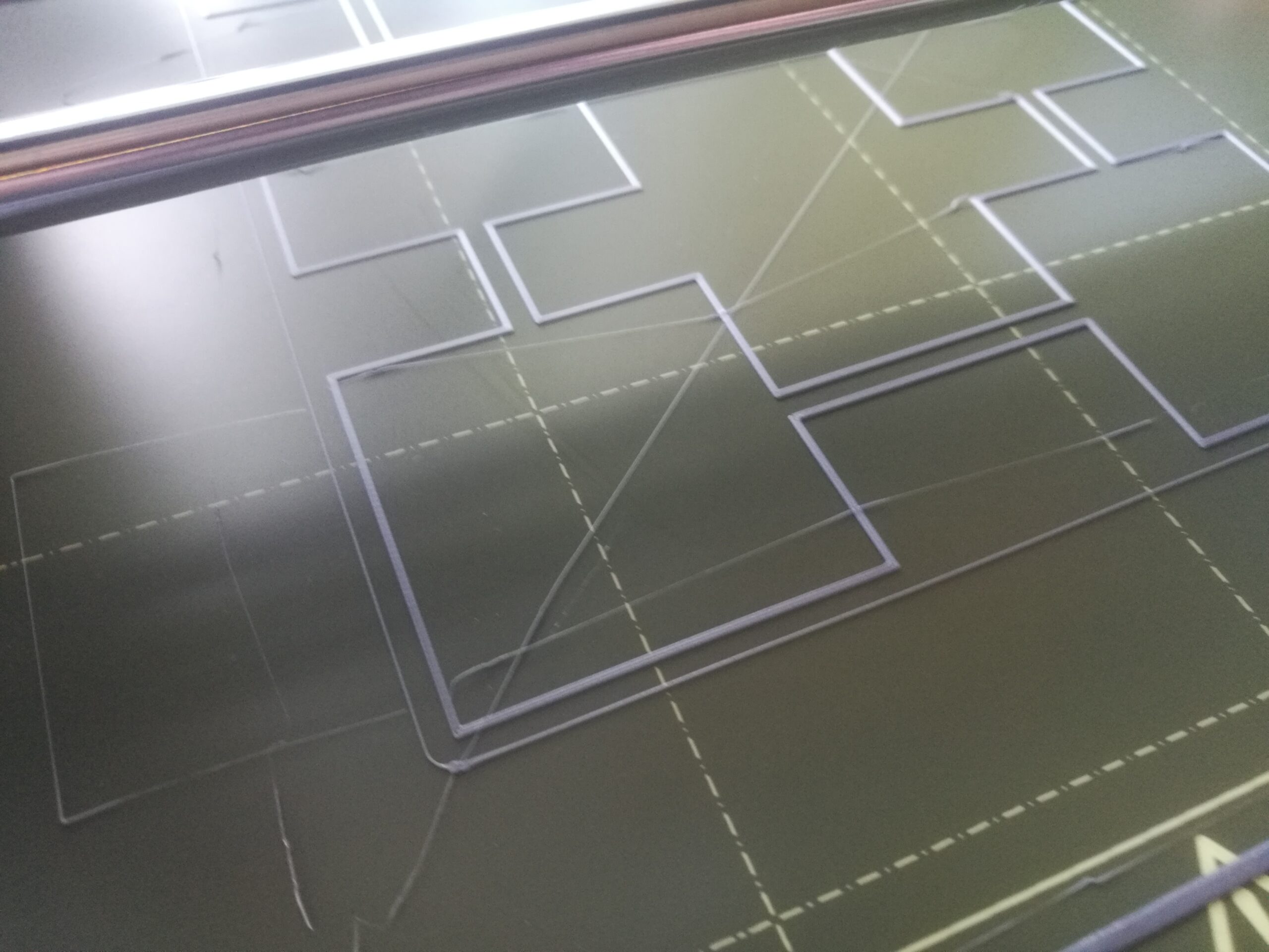

Poor print quality after using 0.25mm nozzle for the first time.
https://www.prusaprinters.org/prints/77937-lid-tightener
I'm making a lid tightener for these lids to allow the use of a torque measurement wrench.
The ridges are 0.25mm tall protruding from the lid and and 0.5mm wide, so I figured I needed a very high detail print. I switched out the 0.4mm nozzle for 0.25mm using this video.
Unfortunately the print didn't come out very well. You can see there are some bad imperfections inside. The prototype I did with 0.4mm nozzle didn't have this problem.
Additionally, I tried to run a live Z adjust print and I could see stringing
Can anyone make any suggestions about what might be wrong, how I could detect it in future before printing and how I can fix it?
Thank you

How come the wider nozzle doesn't make the stream of filament wider?
In any case, it turns out that the problem was moist filament. I've had the printer for 1 week and during that time it has been printing regularly, with the filament on the rack on top. It had absorbed enough moisture to be causing these problems, in just that short time. I have dried it in the oven (45-70*C) and it's recovered nicely.
