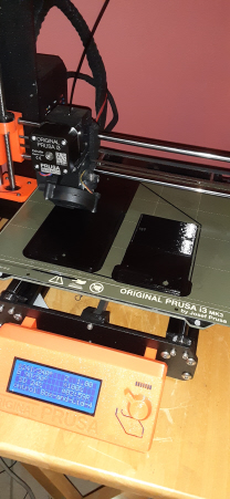

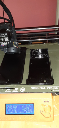

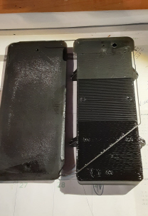

I am printing a cover and box in the same print. The plater side of the cover is acceptable but the plater side of the box is all screwed up. The entire box prints out fine but what's up with the plater side.

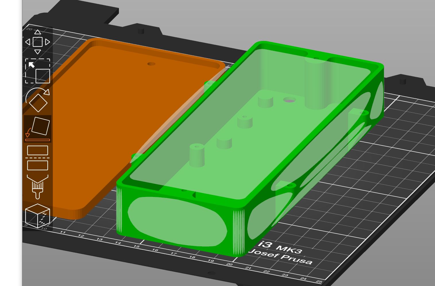

Are these two parts loaded as separate files or one multipart file?  If the latter try 'Split to objects' and then slice.
Otherwise save your project as a .3mf file and post it here for us to diagnose.

It is not flat on the print bed!
If you look from the right side and zoom in you see there is a slight gap between the part and bed
Easy fix, select object, select "Place on face" (middle icon to the left), pick the top face, then the bottom face. Done!

Click on picture to see the left column?

I concur.  Looks like it is nto flat on the bed.

DONE! Good job...........this printer would be collecting dust if it wasn't for this forum. Thank you.
