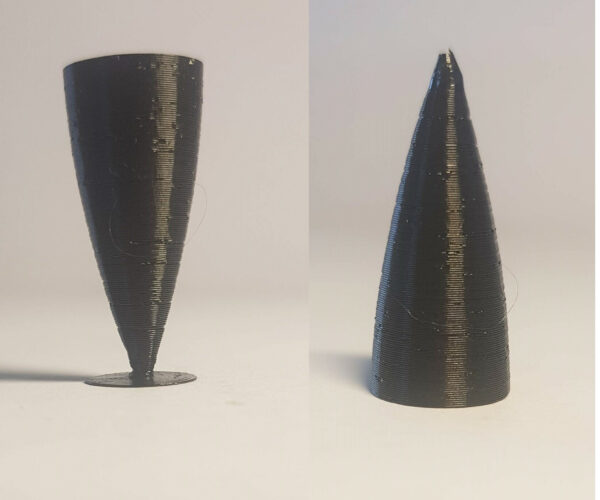

Thank you for all the help. What finally worked for me is below. Temperature flow rate changes were not needed . When I step down below 450 I started to get small rings at the start of the change in speed, could just be my machine or filament.
M106 S255 ;Fan Speed 50%->100%
G1 F600 ;Feedrate F900->F600 Starting at 5 mm from the top and changing all above.
G1 F600 ;Feedrate F900->F450 Starting at 3 mm from the top and changing all above.
Also cut the top ~0.3mm off the top of the model. And then post process with an X-Acto knife one or two quick cuts .
Stepping it down in small incremental steps probably would’ve giving me better results but I don’t have the patience . As they say at some point you have to stop engineering and start production. Once again thanks and I’m calling this one answered .
Tim your results tended to be a bit better than mine, I’m curious what printer you have I have an MK3 I did not upgrade to an MK3S… as I didn’t think it was worth the effort, I may need to reconsider that. Also I’m using HATCH Box which I tended to believe it’s halfway decent filament it is two years old but maybe  that contributes to it too not sure.
Below is a picture for those that are curious. As I said there was more of the print below. Also for those that’s saw my earlier question on vase mode where I added more bottom layers you can see that it plugs into the base and vase mode wasn’t strong enough so I added 5 mm of bottom layers and it worked out rather nicely.

RE: Need help printing a Nosecone in Vase Mode
@tinkerwest
Mk3 - I printed slower than you did, and our Mk3's are better than Mk3s's, so other folk can't print this well.

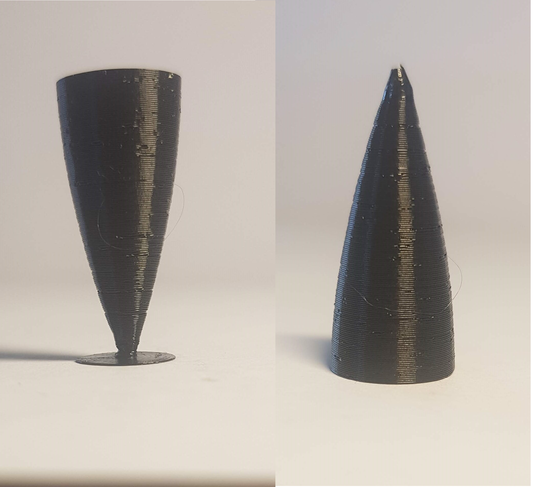

Ringarn67
(@ringarn67)
I have been messing around with the settings. A little, keeping it close to standard settings as possible
This is the OP´s original file, with the tip cut off 0,3mm
In filament settings I found this "Slow down if layer print time is below", changed 15 to 5, and "Min print speed", changed 15 to 1.
That way, as I understand it, the slicer take care of the speed settings. Please correct me if I am wrong.
Maybe I should have bumped up the "Fan speed"?
binary comment
The height is 23.7
Prusa i3 MK3S+ FW 3.11.0 (kit dec -20), PrusaSlicer 2.6.1+win64, Fusion 360, Windows 10
Posted : 23/05/2021 8:04 am
