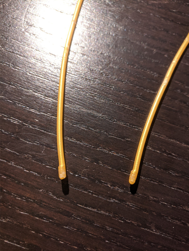

I’m having troubles printing successfully with an 4032D based PLA (PLA FIL3D 4032D - TUCAB) on my MK3S.
I keep getting jams, and when I unload the filament, the tip is as pictures shows.
I don’t have these issues with other brands of PLA.
Any suggestion?

try 0.4mm retraction, if using an enclosure leave the door open,
enable retraction only on layer change...
