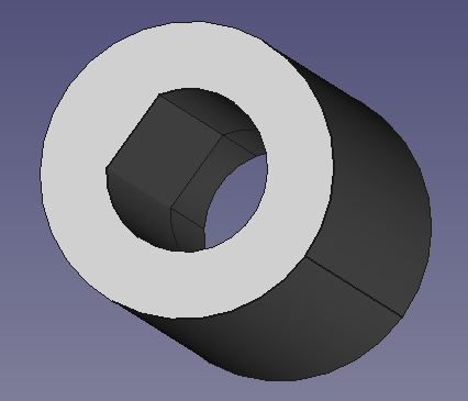

How to print for a stepper motor shaft
Greetings, I am trying to print a gear using MK3S, for Nema 17 D-shaped shaft.  Its 5 mm in diameter, Each time I print, the results ends up with oval shaped hole.  Can someone advice how to get the result as shown in the picture so the printed part fits into the shaft nicely.   I am using Prusa PLA filament.
Best Answer by Neophyl:
I've printed it as-is from the project now.  One immediate thing I noticed from the project is due to its size its hitting the speed slow down due to layer time, so its all printing at 15mm/s.  Personally on my settings I change those values Filament>Cooling> Cooling Thresholds>Slowdown if print time is below = 5 seconds. I suspect its that which is causing the melted look.
Also the gyroid infill is doing almost nothing on this part.  If you stick with 2 perimeters I'd go with cubic and increase the %.  For structural Id use 3 minimum and more if needed.  On a stepper Id go with 4 or more 🙂
The other weird thing is when I open that project its setting a Printer of 'Default FF' but all the settings in that profile look like they are for the MK3S, not sure why its doing that though.
I used Spectrum PLA which I normally run hotter than the settings you have but its actually come out looking pretty good.  Some over extrusion on the top layer but that's to be expected without the filament being tweaked.  The little flat is there and it all matches the model.
So at this point I'd say that even with the sub-optimal slice settings that the problem is most likely hardware related.  Or Firmware,but that's not as likely.  As your parts arent round I'd check the grub screws on the motor pulley(s) for X/Y as a first thing, then the check for smooth movement on the axis.

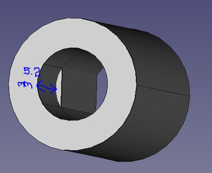

ganesan
(@ganesan)
RE: How to print for a stepper motor shaft
FreeCad view 1 FreeCad View 2
Posted : 22/04/2020 4:34 am
ganesan
(@ganesan)
I am using PrusaSlicer, default settings, 0.20 MM, 20 % fill.  I hope community members can help me out. The printed part does not fit the stepper shaft.
