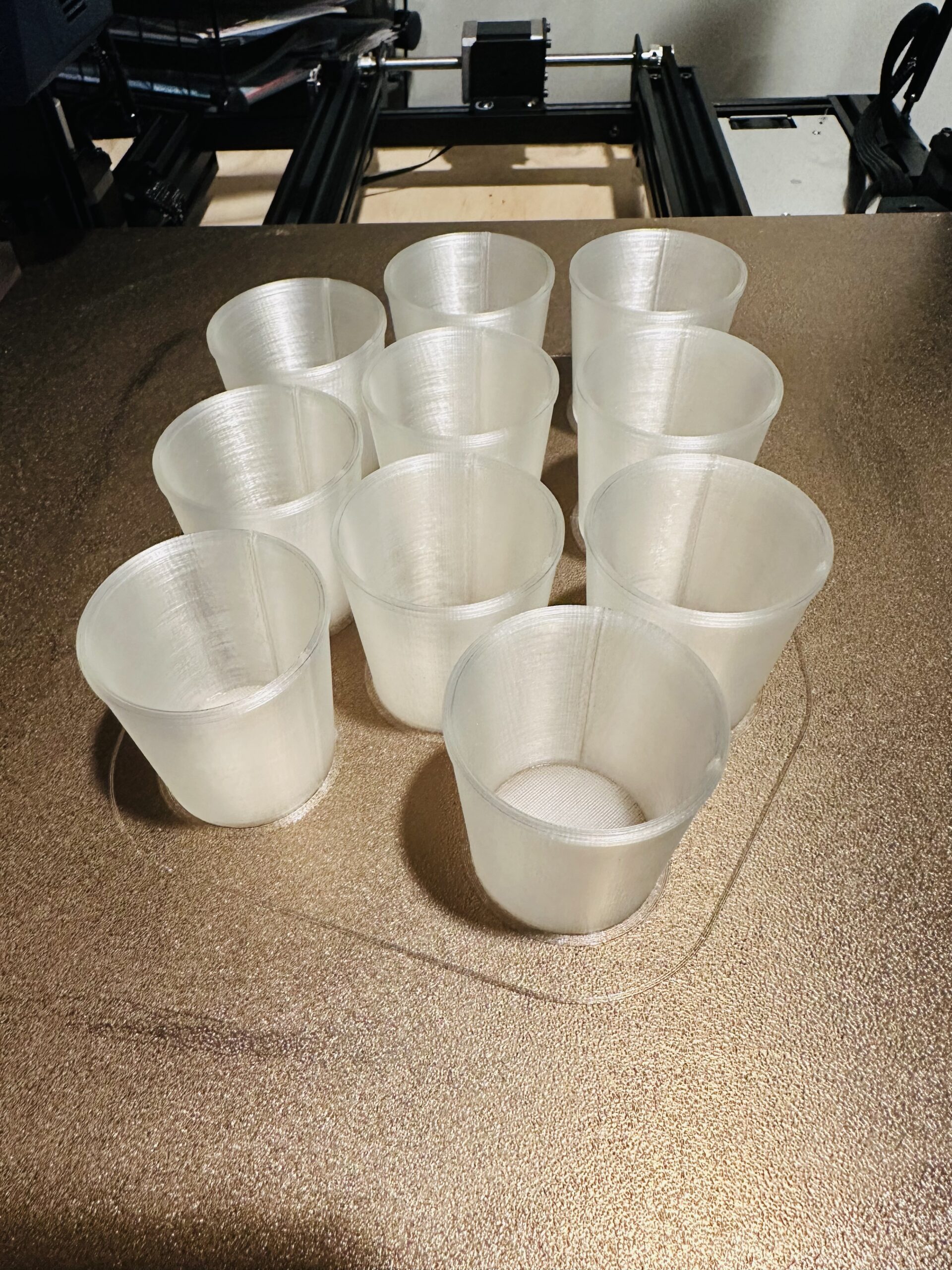

Eksoccer99
(@eksoccer99)
RE: Bulge when print reaches "solid" layers
used orca slicer last night
IMG_3106
Posted : 17/11/2023 11:26 pm

Eksoccer99
(@eksoccer99)
It’s based off of Prusa and Bambu slicer. It’s weird on how it got rid of my line. Still can’t wrap my head around it, as they have the same settings. It had a pre-profile of my printer and I just carefully went through all my normal settings. Most were spot on to what I had done in Prusa choosing a different base printer profile, as Prusa doesn’t have one for my Kobra Max. The developer of orca can change code, as it’s open source software. Guess, when in doubt try a different slicer. I’m not looking back.

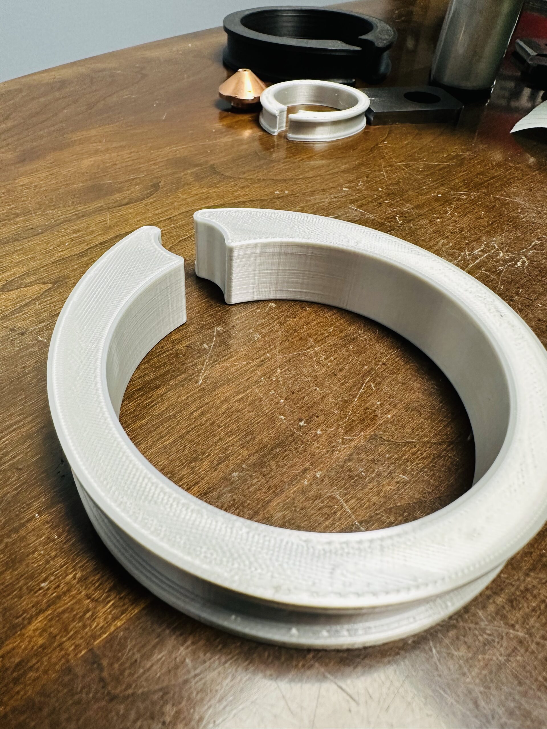

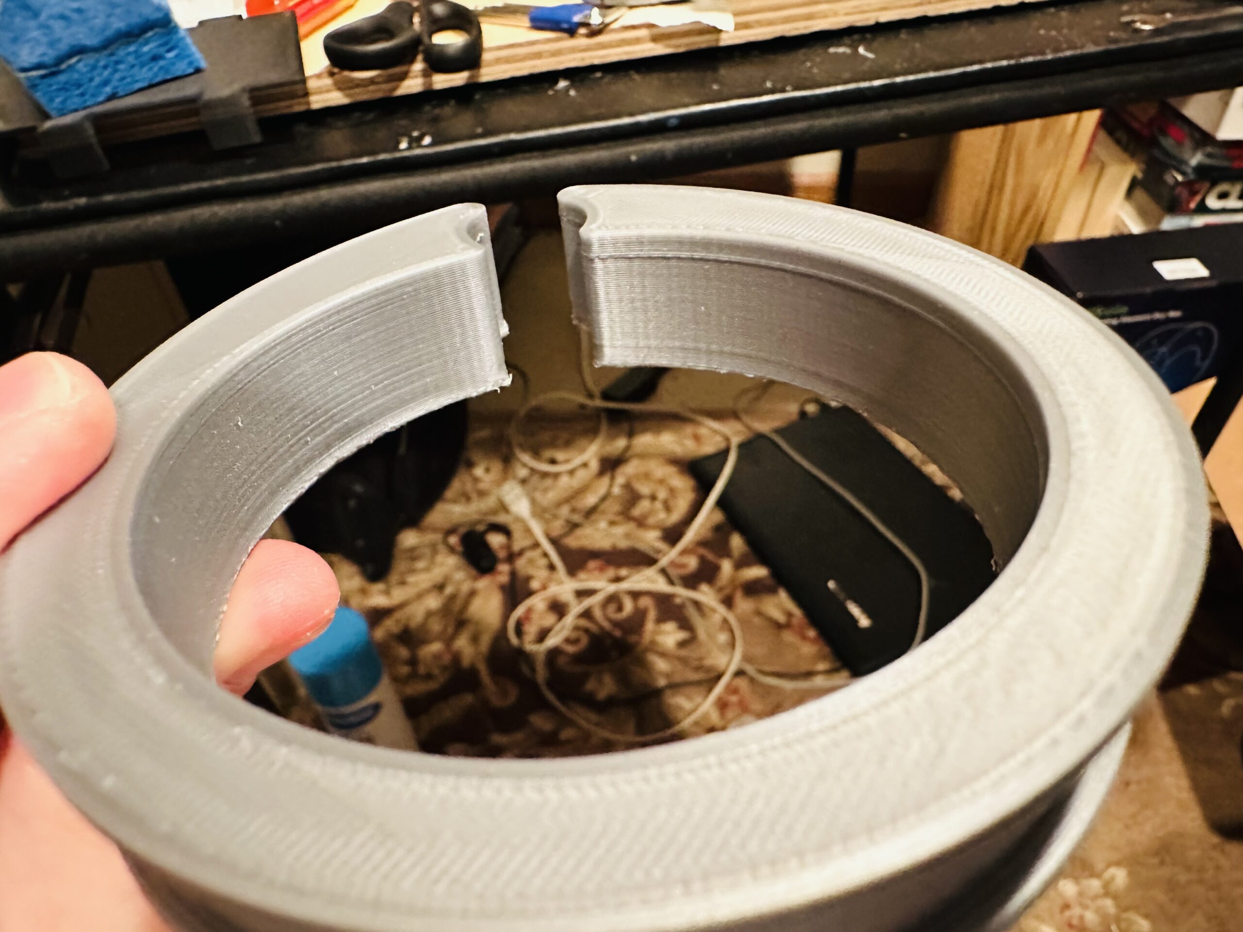

Butter Pockets
(@butter-pockets)
Throwing my hat into the ring - I have read this entire thread top to bottom multiple times trying to figure this out.
I can say that this issue happens for me on a Neptune 4 Pro, an X1C, an A1, and my MK4. I've tried Prusaslicer, Superslicer, Orcaslicer, and Bambustudio. The issue persists through any combination of printer/slicer - although it is MUCH better on the N4P and the X1. I sent a 3MF to Prusa support and he actually did help the issue a lot with settings I did not think would solve it after reading this thread.
The model that I have this problem with is here. It starts on this layer and persists for 1mm which is all the layers with solid infill:
Here is the print from my MK4:
I have tried adding more walls, thinking that the infill was pushing the walls out. I tried setting the infill to be completely disconnected. I tried slowing down outer perimeters. I tried printing slower in general. I've tried every suggestion in this thread.
My initial thoughts were that this is a layer time issue because this correlates exactly with the slowest layers in the print
My thoughts were that since these layers take longer, the part is given much more time to cool so it contracts more, especially the layers right below this. This these layers are shifted outwards from the previous layers. The issue goes away once the solid infil layers are over because the layer time becomes fast again. Which seems to make sense since the N4P and the X1 exhibit the problem less because they have much much more cooling. I also tend to think this is the case since printing multiple of these at a time lessens the problem as well, but thats only a theory. I can't say with 100% confidence that this is the problem.
 Where this gets really strange for me tho is when I print a test model like this where the outer structure only has a single wall.
The bulge due to the inner structure still persists in the outer structure. Which proves its either a cooling or extrusion rate thing, I cant think of another reason why the outer structure would be affected.
If anyone is still active in this thread let me know what you are all thinking and if there are any updates from the people who were active for years.
Posted : 18/02/2024 8:11 pm

Butter Pockets
(@butter-pockets)
Yes the bulge on the outer wall corresponds to the same place as the inner structure. It corresponds to these slow layers seen the slicer
I did send the file to Prusa and their changes honestly did make it look much much better. How it originally looked on the top in green and how it looked after their changes on the bottom in blue. He turned on out walls first, slowed external permiters to 30mm/s, and set retraction to 0.3 (from 0.7).
