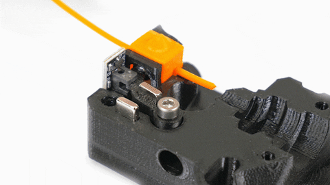

Have you solved your issue since I have the same problem. I took the extruder apart to get to the mechanism and redone everything. In the calibration menu looks like that the sensor is working just fine, even if I tilt or shake the printer a little bit.
Posted : 27/04/2025 5:36 pm
RE: Unwanted/interrupting filament changes during normal print
The Adapter printer wears, with use,
have you tried reprinting the adapter printer and replacing that?
the orange bit, in the image above
Posted : 27/04/2025 8:17 pm
