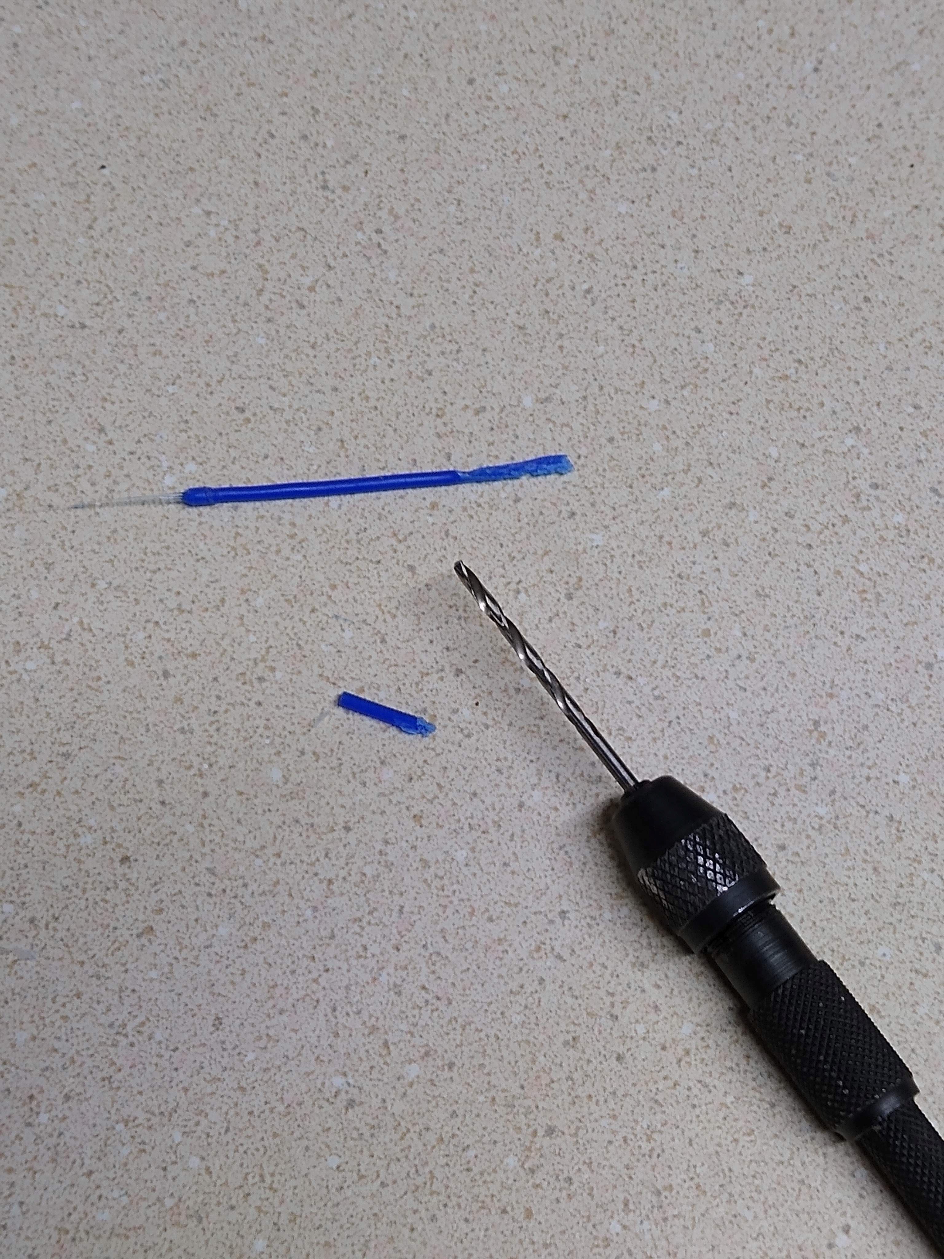

I have a similar problem. This PLA fillament (From PRUSA) often stuck when I was removing it, but in this case, it got stuck really bad and also noises from gears were heard.. I tried removing it, but fillament broke off. I think it got stuck just before print was finished since print was not ok (lack of flow).
Now I can't remove the heatsink from the extruder carriage. I can see PTFE tube move for a 1-2 mm but it won't go out. I used more than reasonable force even with leverage from pliers.
I didn't have problems with other fillaments or types before. For the next step I will try to drill out the clogged plastic with 1mm drill. Your thoughts?
Posted : 28/11/2018 4:40 pm
jure.r
(@jure-r)
Re: Unable to remove heatsink out of MK3 extruder
Fixed. I was able to get fillament out. I carefully drilled in on the top of the stucked fillament with 1.5mm drill until after 3-5mm in, drill captured fillament so I was able to pull it out. After that I was able to remove heatsink out of MK3 extruder.

Startrekfan2
(@startrekfan2)
RE: Unable to remove heatsink out of MK3 extruder
@jure-r
Thanks for that suggestion.  I had the same issue - getting the filament out of the teflon tube.  I used a pin vise with a 5/64 in bit and pulled it out. Pin vise with small bit
