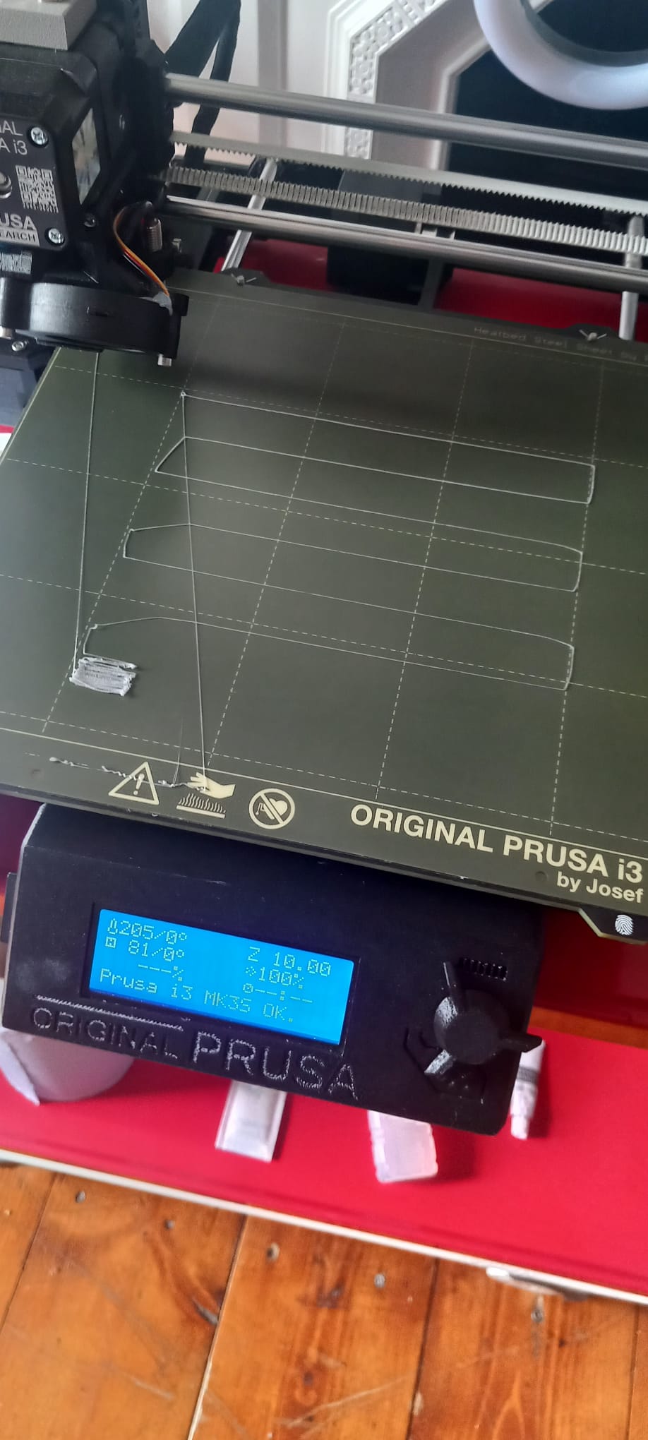

Hi, I bought a second-hand Prusa i3 MK3 3D Printer from a 3D printing business.
I reset the machine to factory settings. I then went to calibrate it and it always stops at the y-axis calibration, saying selftest error! please check: axis length Y

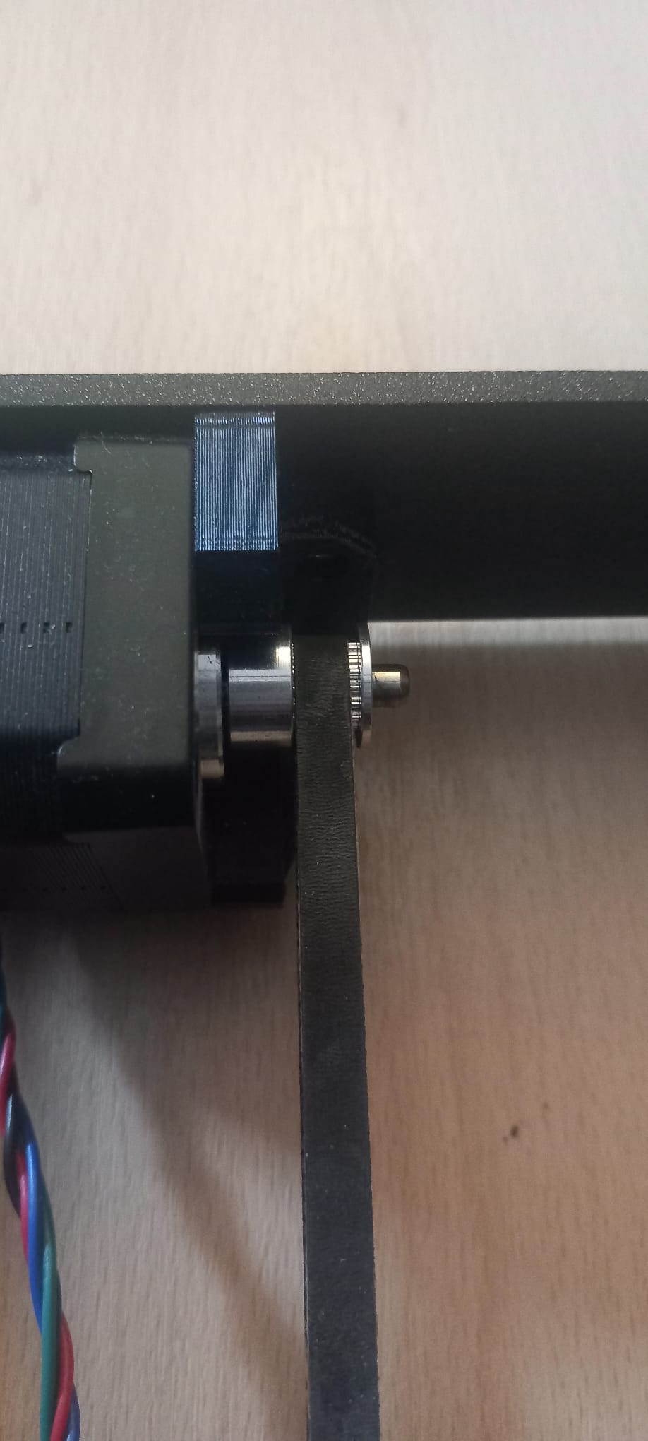

Is the Y Motor Toothed wheel too close to the Y Motor mount, at the back of the frame?

Hi Joan thanks for the reply. I'll attach links to two videos below.
Video 1 (Moving the bed by hand) Video 1
The bed moves freely but there is some resistance. I assume this is normal? I would assume it shouldn't slide effortlessly along the rails. This was done while the machine was plugged in but turned off. Not sure why the screen flashes while its off.
Video 2 (The self-test process beginning at the x-axis calibration) Video 2
The amount the bed moves in the y-axis part of the calibration varies every time I try it. Sometimes the bed moves back and forth the full length and then still says there is an error.

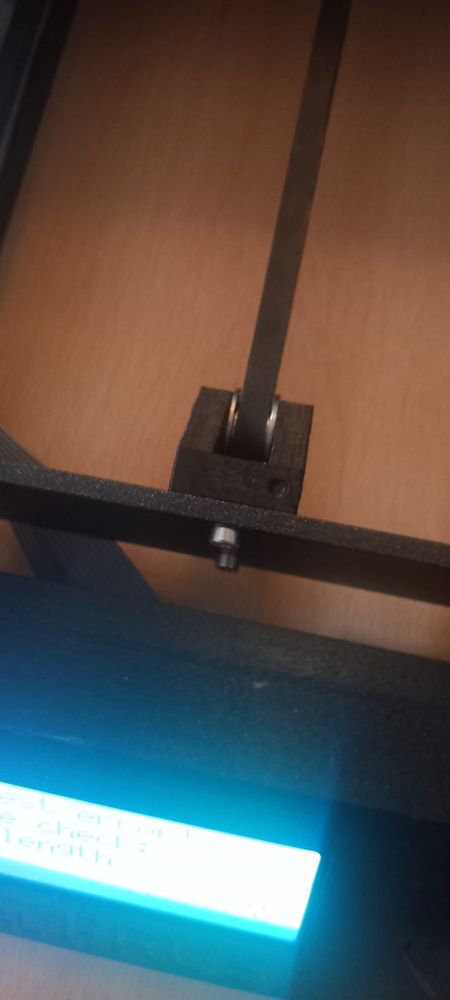

Is the Y axis Idler free to rotate at the front of the frame?
Seems to move fine when I move the plate back and forth.
I'm not sure what too close is. I've attached two images of both ends of the y-axis belt if that helps.

Check the smooth rods are not damaged/scratched. Check the idler pulley is not clogged, out of line, or damaged (loosen the belt and try turning it with your fingertip, is it smooth?)

thanks Diem, it turned out that the bearing at the front was too tight so I loosened the screw a bit and it was able to get through the entire calibration, thanks for all the suggestions guy!
