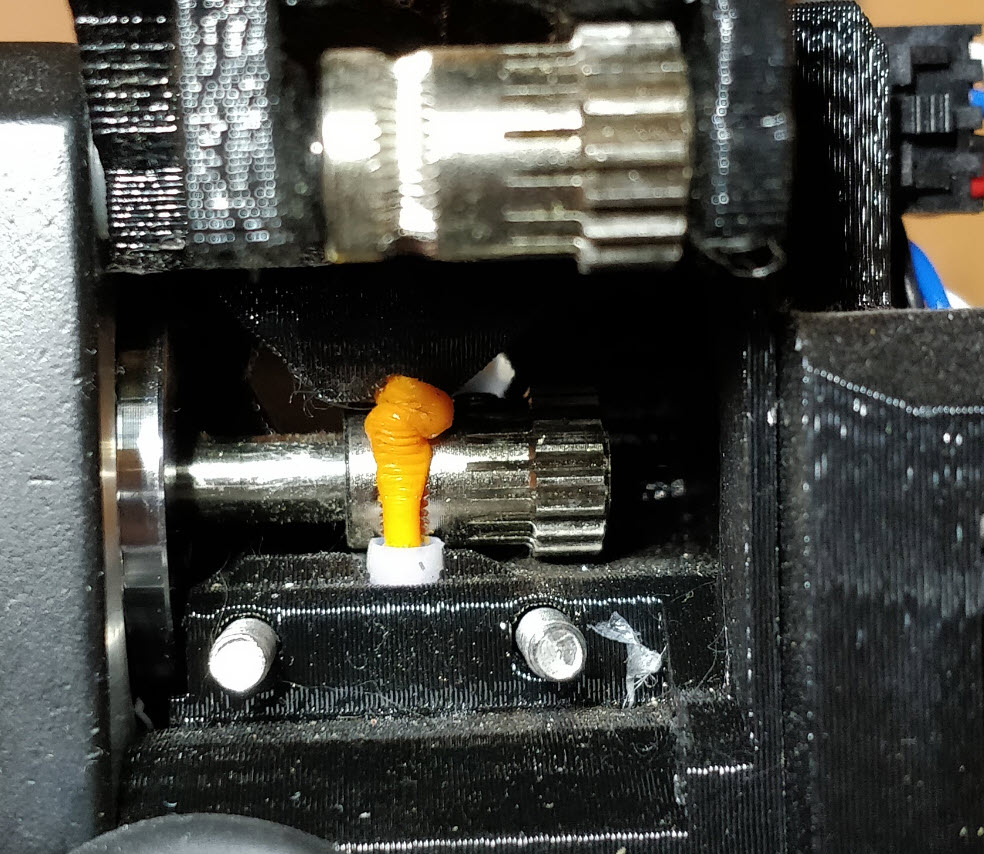

Prusa Mk3 started printing in air, no filament coming out, and when I tried to unload (with nozzle heated) this is what occurred.
Never encountered this before, any tips on resolving?

Heat up the nozzle to 250C, open the extruder door and try to pull hard without breaking the filament. Maybe you're lucky and the jam isn't too bad. Otherwise you will need to disassemble the extruder

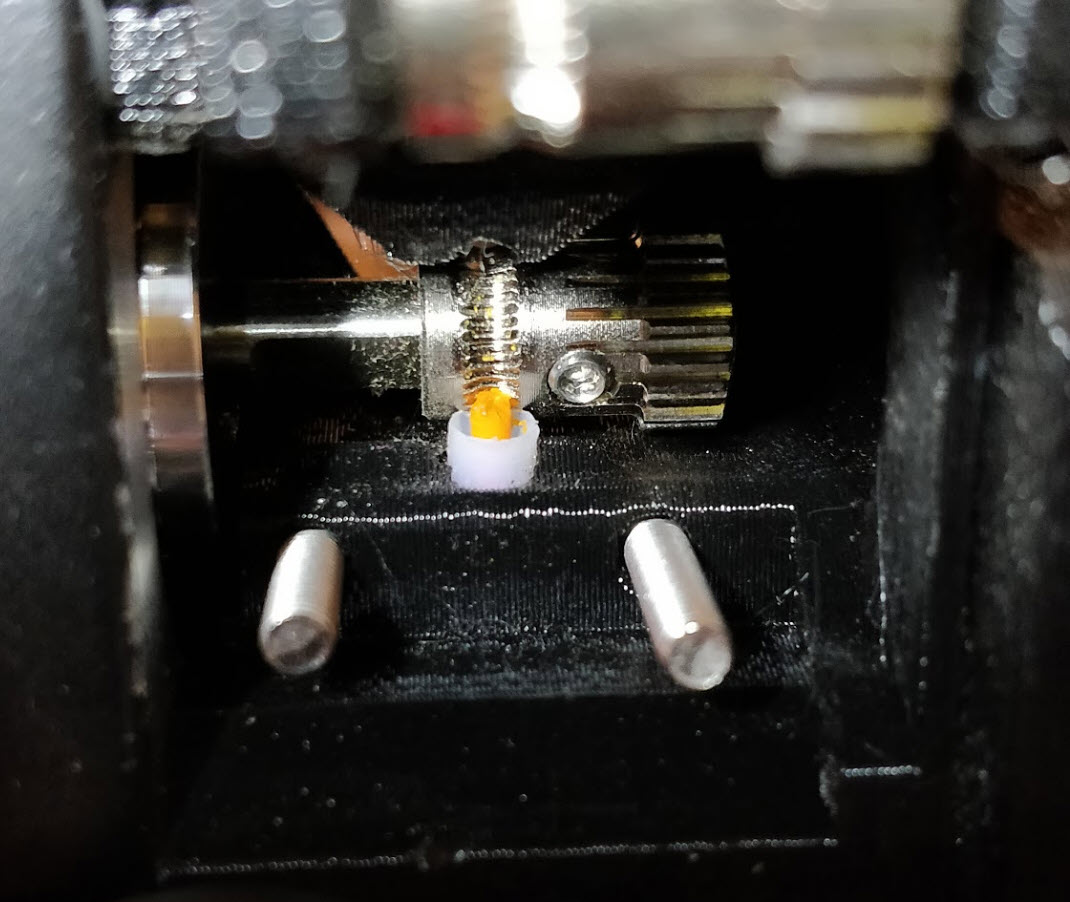

So I opened the extruder, was like this:
Managed to pull some out, (with the nozzle heated to 220 - was before I read the last post), however at some point it snapped.
No way to push it through I assume...
I will look up how to take this apart, never done it in reverse.... and at some point have to figure out how this happened in the first place.
Was in the last 5 minutes of a 2hr print too 🙁
And I ran out of that colour now!

Yes, I read that when I needed to do a cold pull due to curly filament, however it refers to 2 sections of the instructions that have moved. Extruder cover is easy, however sensor cover is not mentioned in instructions.
Also not sure how a 1.5mm wire is going to get through a 0.4mm nozzle.....

Re: Printing in air, filament feed failure, won't unload either...
I just took mine off and looks just like your bottom photo. The small piece I can see wont move up or down one bit.

If there's not enough to grip to pull out, will probably have to do this: https://manual.prusa3d.com/Guide/How+to+change+a+PTFE+tube+-+Original+Prusa+i3+MK3-MK2.5/761
I am about to start that myself now...
Posted : 14/02/2019 7:11 am
wcndave
(@wcndave)
So, I got the hotend out, managed to get out the PTFE tube without doing too much extra damage, heated with hairdryer until the PLA inside was soft, pushed with a pin, got it sticking out, waited for it to cool, pulled out with pliers, put the whole thing back, re-calibrated everything from scratch, and it's printing again. The top of the PTFE tube is slightly damaged, but the filament still seems to feed in ok. Went to order a replacement, and they cost 53ct with €30 shipping....
