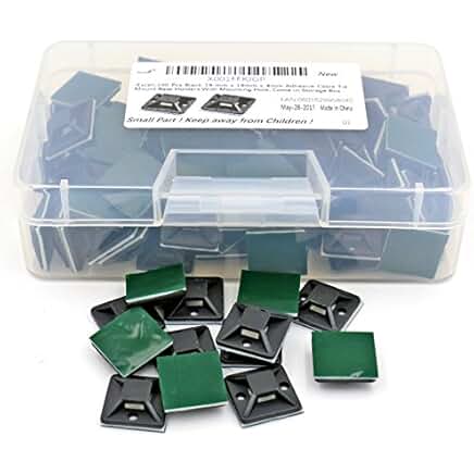

if a few of these were included in the kit and instructions on where to place them this sort of interference could be eliminated. those illustrated at the bottom are 19 mm X 19mm and cost retail $8 for 100. including shipping... they are sold in many different sizes. tossing a few in with the zip ties would not affect the costs on the kit for Prusa
and of course there are many variations of these on Thingverse if you just need a few to print
https://www.thingiverse.com/thing:1800896
and you can scale them to the size you need and if they are to be held by foam tape or screws or superglue. designs for all can be found on line

The objects in the post above are called 'sticky-backs' in the electrical trade around here. Having been in that business for decades, I can tell you that the 'sticky' part is one of life's great lies, right up there with 'one size fits all' and 'the check's in the mail.'
With careful surface preparation, they will stick for a while, but can be depended upon to pop loose at some point in the future. Best look into a way to secure them in place with screws if you depend on them for something besides making a job look good until you get your tools out of the building.

surface prep and super glue perhaps? I have high strength double sided tape that I use in the machine shop to aid in fixturing sometims but You are correct I have no idea how that foam centre tape would do over time (the stuff I use it is thin with no foam centre which seems to be the way the zip tie things are attached if they don't use mechanical fastening).
yet I grab old inkjet and laser printers and xerox machines at the dump from time to time and strip them of useable parts and I see these used inside the larger office copy machines with foam centre double sided tape and I have to run a blade through the foam layer in the centre of the tape to get them off so there do seem to be different grades of this sort of product
for the illustration above I just grabbed the first Amazon version I saw with a 19x19mm size and have no idea if the tape it uses is any good so I guess like anything else it comes down to the quality of the individual brand.
