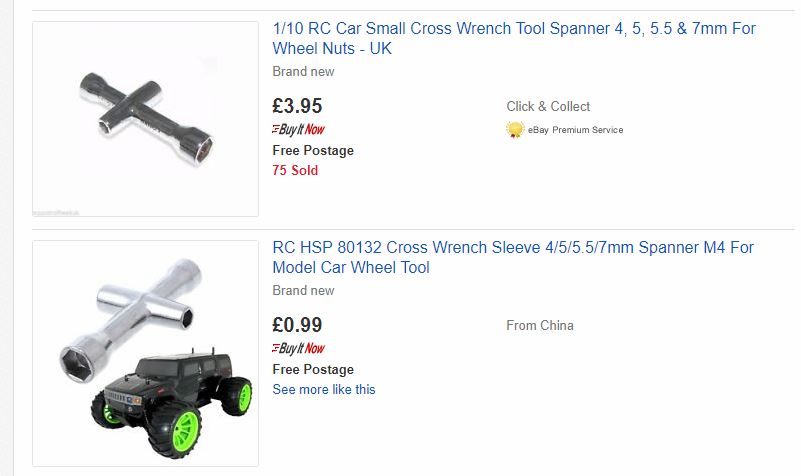

at the back of nozzleblock I have a model car spanner, this is useful because the wings are small enough to stop you overtightening the nozzles when re installing them.
I like the socket in preference to a flat spanner, because :
A, the hot nozzle doesn't drop out onto your build plate,
B, it's a lot easier to align the nozzle with the hole in the heat block without burning your fingers when re inserting the nozzle
c, it doesn't keep slipping off the nozzle in use...
Another inspiration! I'll see if I can root one out.

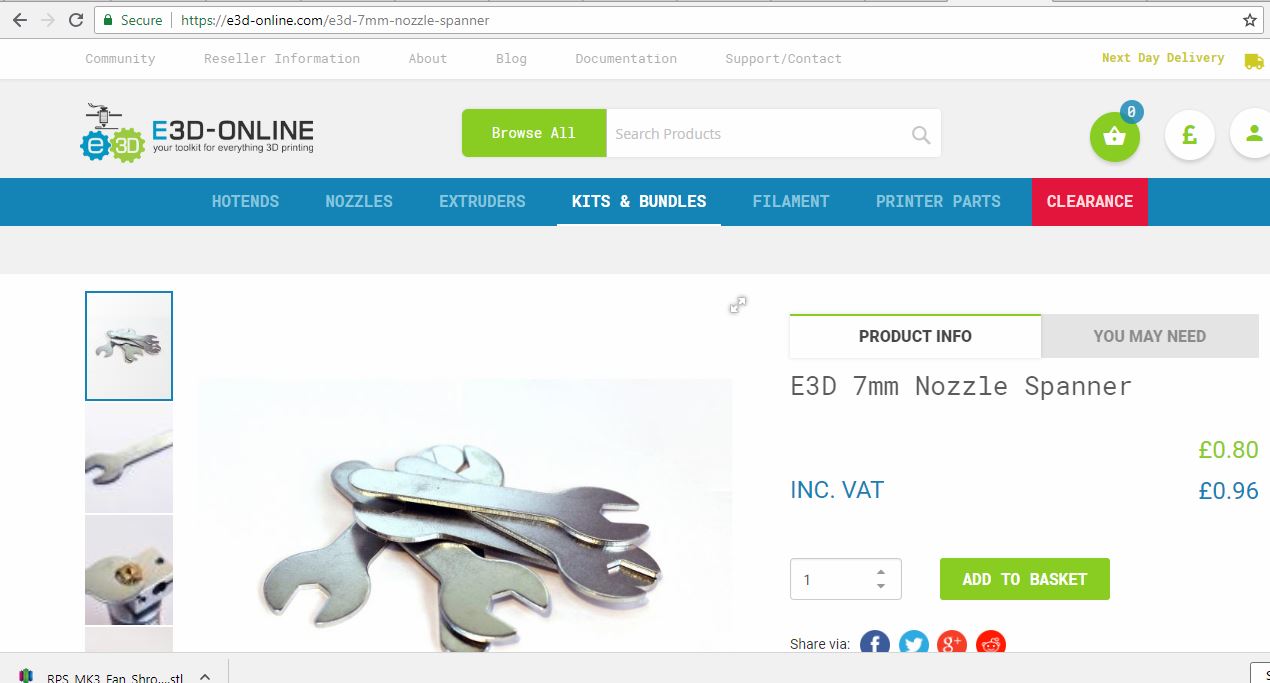

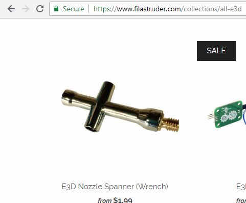

I was looking at the Prusa spares page at Filastruder, in response to another thread, and noticed that they now sell an identical spanner
so I looked at the E3D Page to see if it was available there
and I looked where I got mine from
Please be aware, there is a Black variant of this spanner... It's Plastic... may not work too well with hot nozzles...
