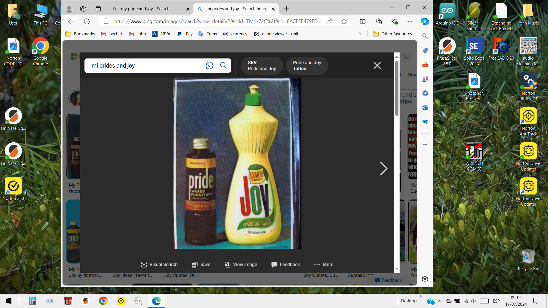

Enclosed a snapshot of my pride and Joy LOL  😀
Cheers
John
Spain.
