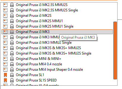

I have a MK3S+ and the only drop downs for configuration selection in the Prusa Slicer 2.9.4 are MK3 and several others. Which one should I use?

You installed a lot - but missed that one:
At the bottom of the dropdown select Add/Remove printers, if offered a choice select Presets - you will enter the Configuration Wizard
When you get to the Prusa FFF listing scroll down and you will find the preset.
