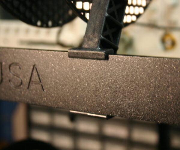

how to attach filament holder to I3printer.
The useless manual that comes with the I3 only says to attached the filament holder to the top o the printer, but of c filament support attached to top braceourse, does not say how.  Unfortunately, it can be done in a couple of ways, one of which is wrong and will cause the vertical support for the filament holder to interfere with the x-axis of the printer.  This photo shows the correct orientation.  I'm posting this to save another beginner the headaches I went through.    Come on Prusa!  Time to hire a professional tech-writer.  The documentation on the I3 and the Mini) is worthless.

Easy!
Something like this.  I even got it to fit with the MMU2S.
