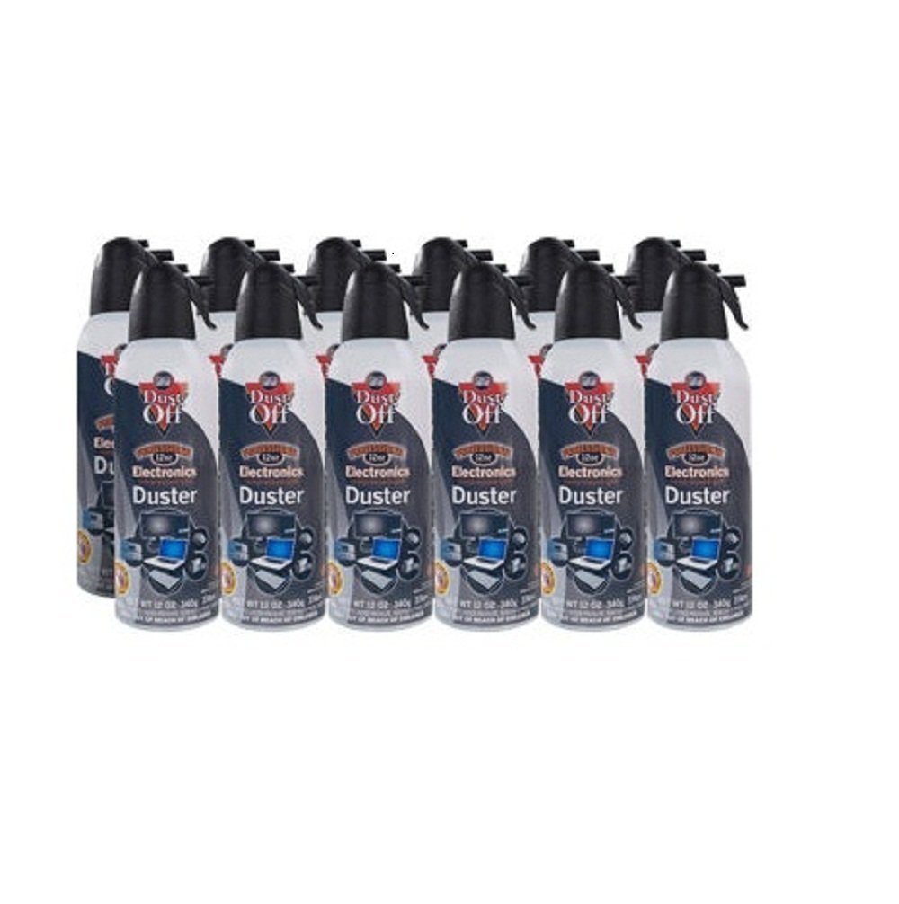

use a can of electronics chiller
or Dustoff canned pressure duster. point it at the corner and the part is chiller and separates from the bed. works every time even on stuff 0.2mm thick
