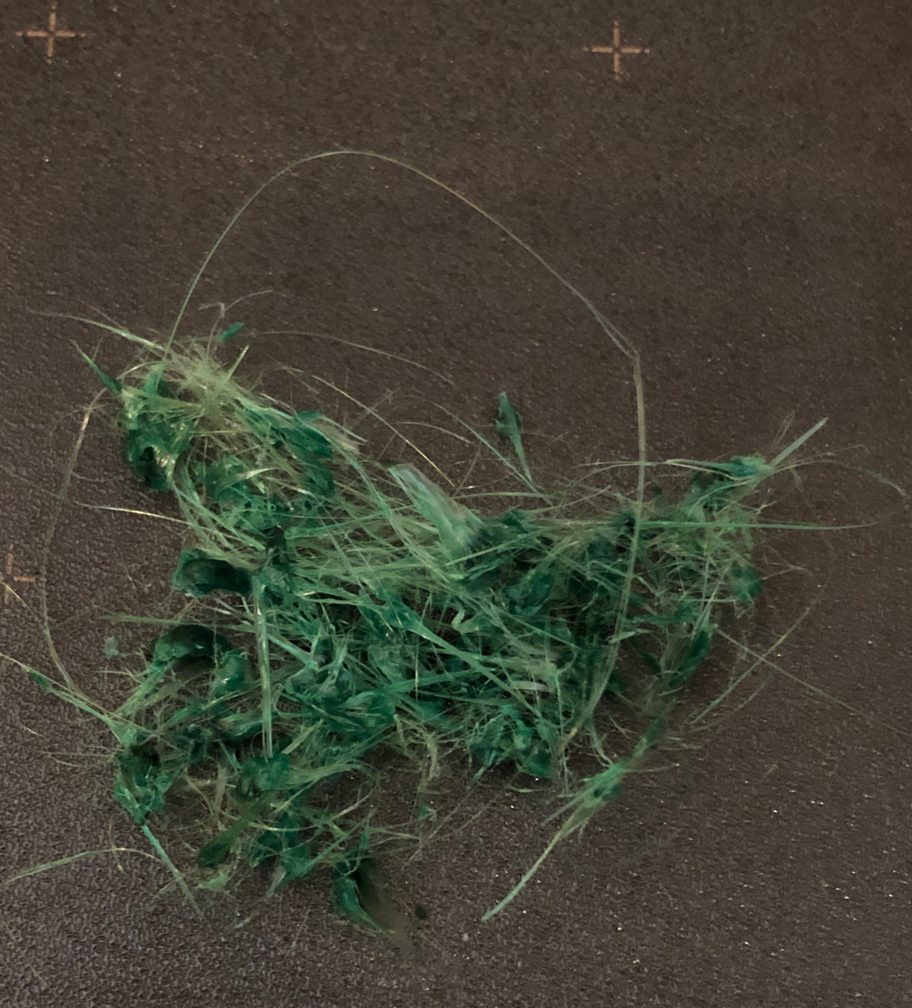

Well it finished printing my first over 24 hours long print. it is not perfect there is a bunch of snot that built up over night and the front left corner has warped up off the bed a little but it is more than good enough for its purpose the bottom shot shows where the adhesion failed and also it shows that I should have gone a bit lower in my Live Z the snot. The spider webbing photo is what I found inside the box this morning most of it was not attached to the inside walls, or so lightly that it brushed off with a light sweep of my fingers... This Pollyalchemy Elixir prints with a lovely shimmering sheen using Chris's pretty PLA settings... all that said how do I address these remaining issues of spiderwebbing and snot? the warp I can see is where I might have has a fingerprint at the left front.(i was eating fresh buttered popcorn as I set up and right before I cleaned the plate in the kitchen sink and brought it back to the printer and so that corner lifting is all on me.
