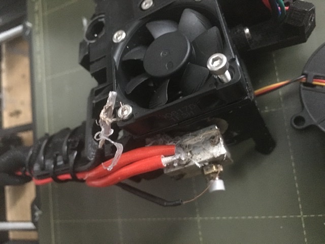

So this happened... huge chunks of PLA Wrapped around the whole block of the hot end. Two wires pulled loose getting it free. Can This be soldered together simply? Or do I have to buy another whole unit? Is there an upgrade to this available if I have to spend the money and time to disassemble and replace it?
RE: First catastrophe - wires pulled out
Solder would melt. You need a new thermistor. (here, from Prusa or another reseller)
It's a bit of a hassle to replace, but not so bad. Move the printer to a location where you can easily access everything and go slowly. You're going to have to do a bit of a tear-down unfortunately. Some users have soldered on various modular connectors to avoid the need to unwrap the wires all the way back to the controller.
It is possible the old thermistor may be jammed permanently in place. If so, you're likely to find that a lot of bits in the hotend are fused. Be prepared to replace:
- Heater block
- Thermistor
- Heater cartridge
- Nozzle (unlikely but can happen)
- Heatbreak (if you snap it)
Be sure to read up on the procedure for replacing the nozzle and getting the gap between nozzle hex and heater block.

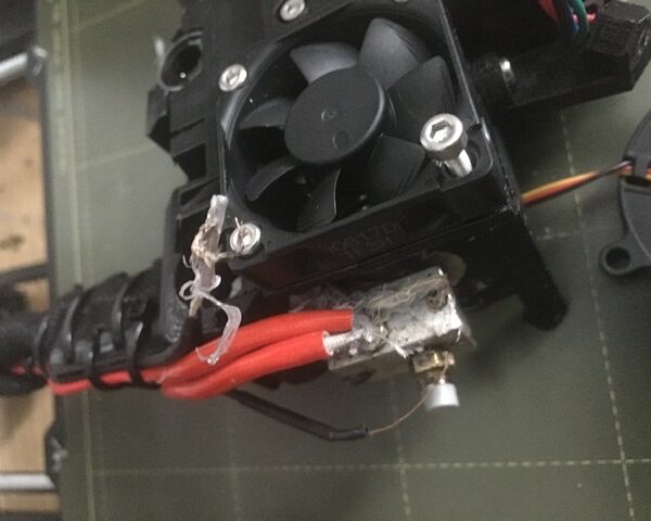

Would this fit? I'm still not sure I'm seeing all the wires right... I can't find a close up of all the wires cbonnected to the heat block to compare properly. The wires don't appear to be blue, and that's confusing me right now.
https://www.amazon.com/gp/product/B07TYGYWRG/ref=crt_ewc_title_dp_1?ie=UTF8&psc=1&smid=A1283MCABFXB0
I did confirm those were the thermistore wires that broke loose, but I can't get the heat block free so I'm assuming it's fused somehow... so maybe I order this
