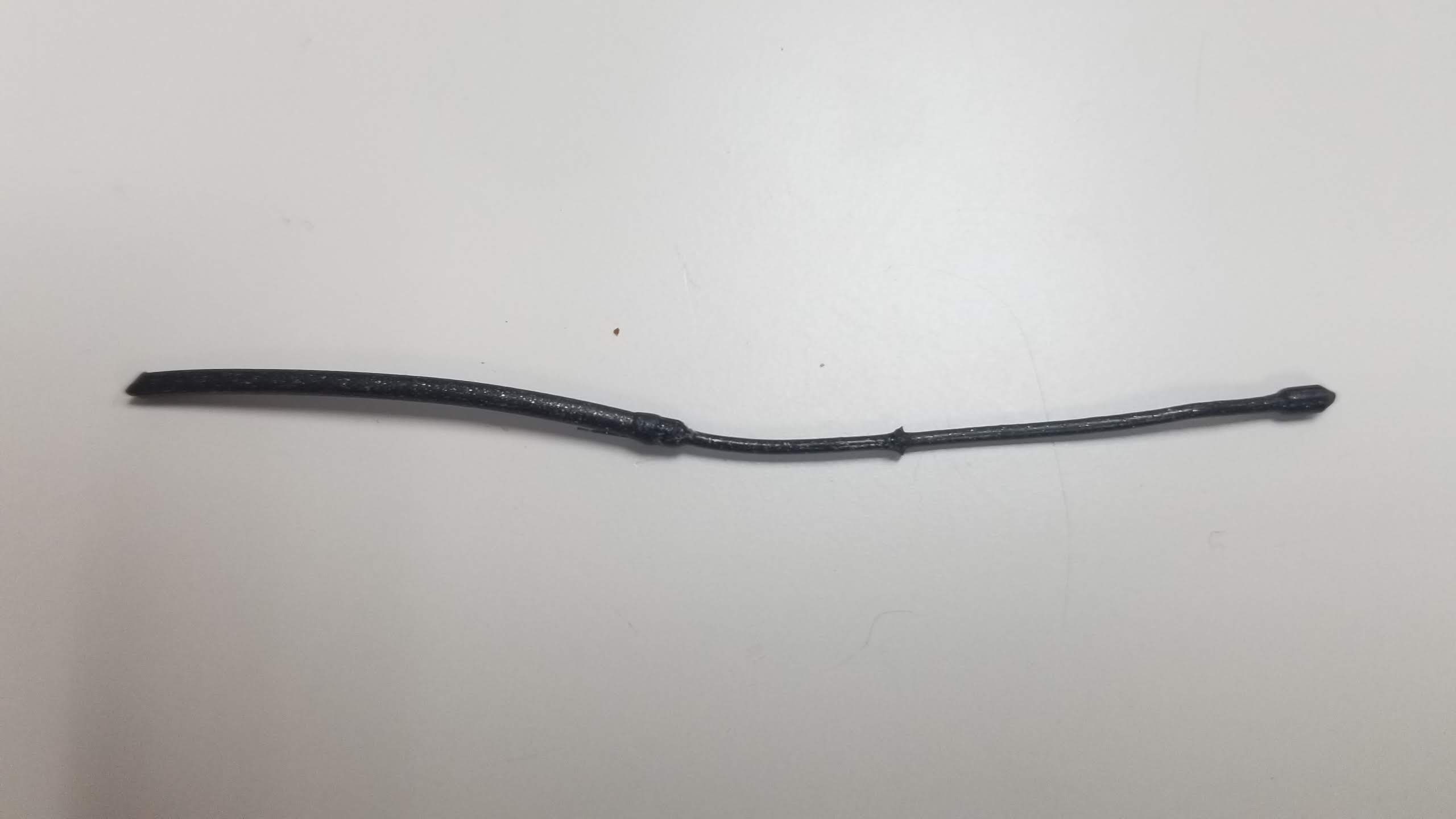

After one of these failed prints, do a normal filament UNLOAD and snap a sharp photo of the melt end; and post it here.

Here is a picture of the last few times I've had to unload the filament, snip the end and re-load.
Does this help? I looked at the links provided but neither thread concludes with any kind of solution that I can see. I browsed the search results but still haven't found much that helps.

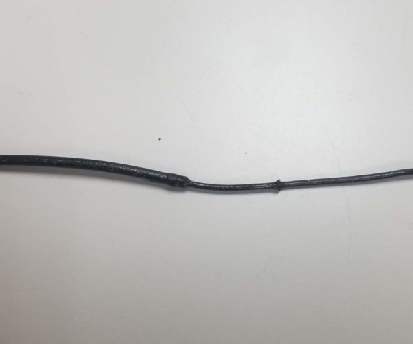

The assembly manual helped A WHOLE LOT! Thank you for that. I did a cold pull, and I'm going to run the machine to see if it works better now. Here is the piece I pulled out.
Cold pull results
So the PTFE is a little white tube that is down inside the Hotend. I have not yet figured out how to make sure it is all the way forward. I don't see any positioning instructions related to the PTFE in the assembly manual.

RE: Filament stops coming out in the middle of a print.
The cold pull tip looks fine.  But this step in the filament at the heat break is indicative of the common heat break jam.  Many of us resorted to replacing the Prusa mod heat break with the stock E3D-V6 version and the jams went away.
