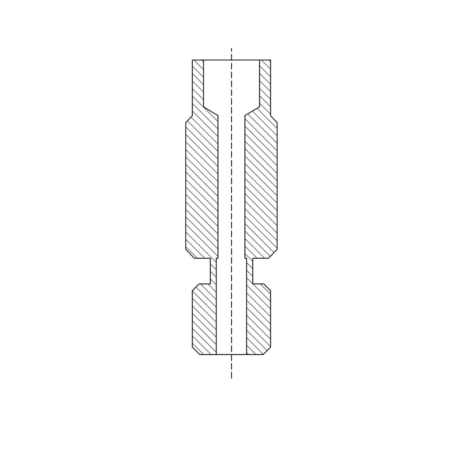

I'm not sure. Coming from CNC machining background, I would guess there's something possibly up with the original machining. I do not have access to my old "lab" else I would cut my old heatbreak in half to investigate it myself. I will be asking E3D if they will investigate it, and send me the results. (I will meet the E3D guys @ ERRF2018)
My understanding of the MMU/MK3 heatbreak, (and I visually confirmed this looking into it) There is a "step" on the "top" of the heatbreak. I am unable to measure the ID at any of these points, without cutting it in half, and I do NOT have the proper equipment for doing it "cleanly", so I'm not going to do it.
But it goes from the 4mm ID for the PTFE tube, down to ~2.1 or 2.2mm. Eyeballing this here, so forgive my lack of accuracy. 😛 which goes from the PTFE tube, down to the "top" of the neck. (I think) It is hard to gauge distance looking down a ~2.1mm hole. There is a "step" that goes down to 1.9mm. This is specced by Prusa, and is NORMALLY ~2mm. In fact, I think this is the same diameter from top to bottom on a "normal" E3D V6 heatbreak. I am unsure on this though, as I do not own one to look at!
Anyway. I am unable to feed filament through my MMU/Mk3 E3D heatbreak "freely" as in, the 1.72-1.73mm filament is "touching" the heatbreak. You might say "Oh but yeah, that's because your filament isn't straight!"
My 1.9mm ID, Capricorn PTFE tube, *DOES* slide freely over my filament.
There is something smaller than 1.9mm ID in my hot end. In fact, I would go as far as to say, it could be a damaged drill, causing "micro burrs" on the ID. These micro-burrs are less relevant when new, however through "normal use" PLA will begin to carbonize in it. I specifically encountered my problem after printing with ABS rather hot. Almost as if the ABS broke my heat break. I know, you are gonna say "There's ABS stuck in there silly, that's what happend!" Yes. Let's play that game. That's why ABS jammed in there too!
I think the issue has SOMETHING to do with carbonization of the PLA. This really only happens at ABS/PC/Nylon temps though.
Feel free to say "It's not the heatbreak". But there's apparently a *LOT* of people "fixing" their mk2 MMUs, with "their original, old, MK2" heatbreak.
And honestly, the "last" time I tried to "manually" push filament through my hot end, was nearly impossible, it felt like there was a "jam". (eg, the nozzle was 75% clogged) My guess is that was the "heatbreak" grabbing the filament as it went through it.
I'm not realling blaming E3D, as it's a "non-standard" heatbreak. But the fact of the matter is, as big of a problem as the MK3's PSU is... (240watt heat bed+40watt nozzle, on a 240watt PSU anyone?)

Semi-Custom fabricated by E3D.
https://wiki.e3d-online.com/images/0/09/V6-175-BREAK.pdf
That is the "typical" E3D V6 heat break. 100% stock. This would be FINE.
The "potential" design flaw on the Prusa MMU version (which is what the MK3 has)
Looking at that image of the Heat break, Just above the "neck" there is a "step" and from the "neck" down, is 1.9mm.
So it's 2.0mm ABOVE the "neck" and
1.9mm from the neck down.
This allows a VERY small "lip" on the filament, to cause a *JAM*
I think it also can get "carbon buildup" and kinda... "catches" filament. (or even burrs) Making it "harder" to push into the nozzle. (causing high temps on the extruder motor, and clicking sounds)
It also will cause under-extrusion. Basically it's a jam. Kinda.
This is a image of the Micro Swiss heatbreak. If you notice theirs is "smaller" towards the top of the heatbreak, and there's a "step" on the inside getting LARGER going towards the bottom.
This prevents the filament from ever "jamming" on the "forward" motion, and as long as the filament is "hot" you can always retract it over that step. (And if it's not, you can always push it forward to melt/heat it, given there's no step between the filament, and the heat)
My understanding of the MMU/Mk3 version, is they are the EXACT opposite concept, of the SwissTech.
Basically
Looking down hole from TOP of heat break, on E3D MMU one, you can see a "step" towards the bottom. This is what I think is causing the issues.
Looking UP the heatbreak, on the Micro Swiss, you can see a "step" towards the bottom. (the side you are looking in) They claim this makes it better.

Just out of curiosity, has anyone tried replacing the stock PTFE tube that goes from the feeder gears down into the hotend with one made of Capricorn material?
I feel this would benefit form several effects.
1. The material has a natural(synthetic lol) lubricant that would allow for the material to slide better/easier in the tube into/through the heatbreak, and hotend.
2. The ID is smaller, and almost the exact size of your filament so it will have less of a chance to expand, and/or bind up in the tube (Especially helpful with flexible materials.
3. It has a higher temp range, and would help with the thermal barrier/protection in keeping the heat creep from reaching the filament in this section of the extruder yes?
Anyways, I am planning on doing this when I get mine (eventually lol).
I also plan on making my tube slightly longer, and with more of a ^ cut in it like on the Flexion extruders so that it fits tighter against the extruder gears, and less of a chance for the filament to escape when printing flexible material.

I suppose one could insert additional temperature sensors to monitor the temperature in different stages of the heating process. That might help diagnose the problem. It does seem like R&D that end-users shouldn't have to be doing though.
Would a stock E3D V6 fit and function within the Prusa I3 MK3 PETG parts, or would only the customized Prusa E3D V6 fit?
