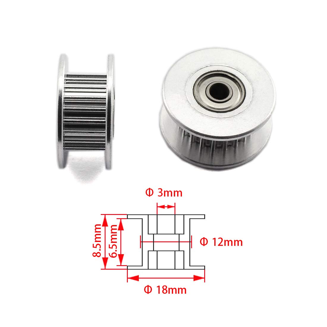

Joan, are these the same item
https://smile.amazon.com/HJ-Garden-Aluminium-Synchronous-Mechanical/dp/B07LGKYGY1/ref=sr_1_5?ie=UTF8&qid=1547331003&sr=8-5&keywords=HJ+Garden+3mm
HJ Garden 2pcs 20 Teeth 3mm Bore Idler Timing Pulley with Bearing 2GT Aluminium Alloy H Type GT2 Synchronous Wheel for 6mm Width Belt 3D Printer CNC Mechanical Drive Silver
Opublikowany : 12/01/2019 11:13 pm
Re: Clicking Sound when Extruder moves along the Y-Axis to the left
They look good Randolph,
although the diagram seems to show the core diameter of the hub without the teeth... as if it were a smooth roller, this is probably done for simplicity
Opublikowany : 12/01/2019 11:39 pm
