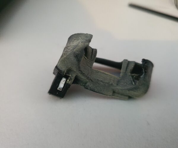

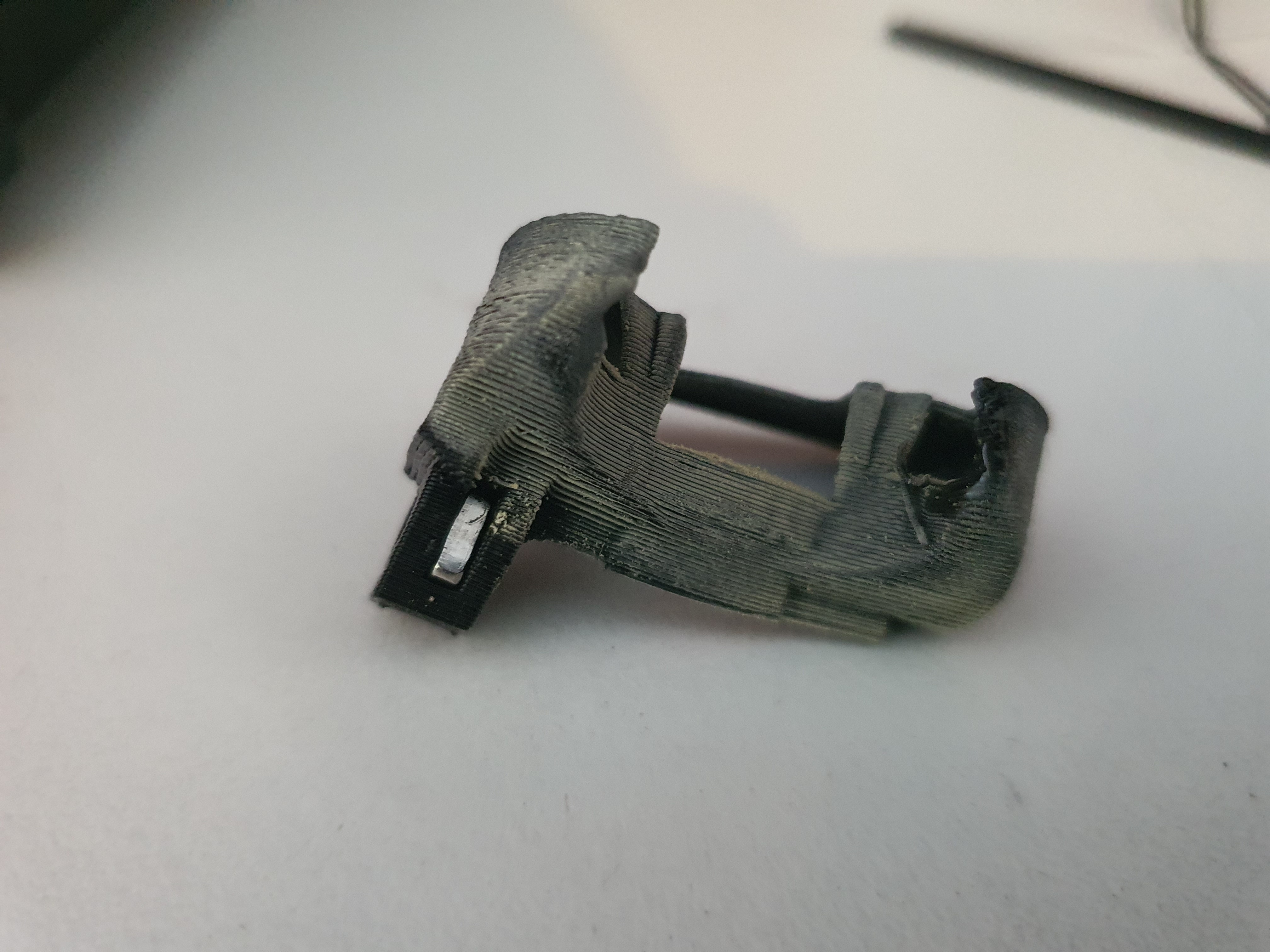

 So I am doing my usual prints when I noticed a scratching noise.  Apparently the fan shroud has melted and deformed, hitting my prints to the point it dragged one of my prints off the bed.  Failed print of course but definitely used to it on this new problematic printer I received from Prusa.

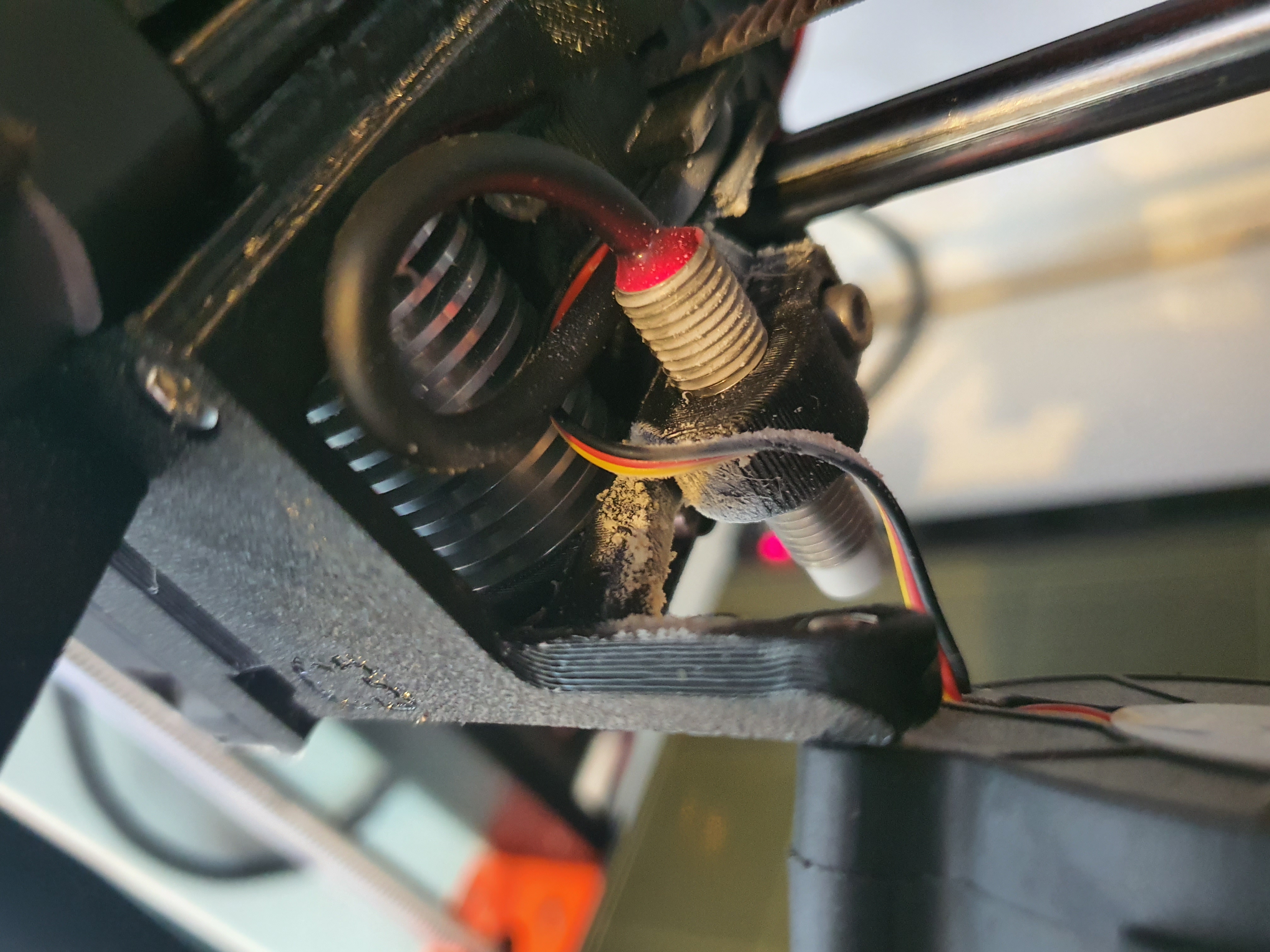

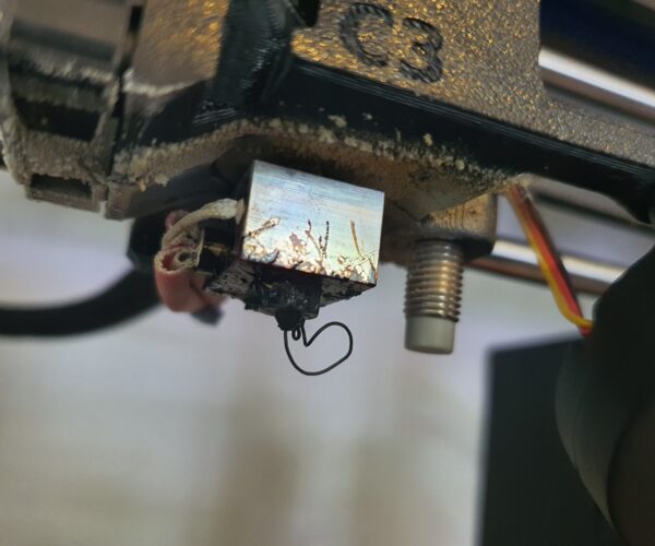

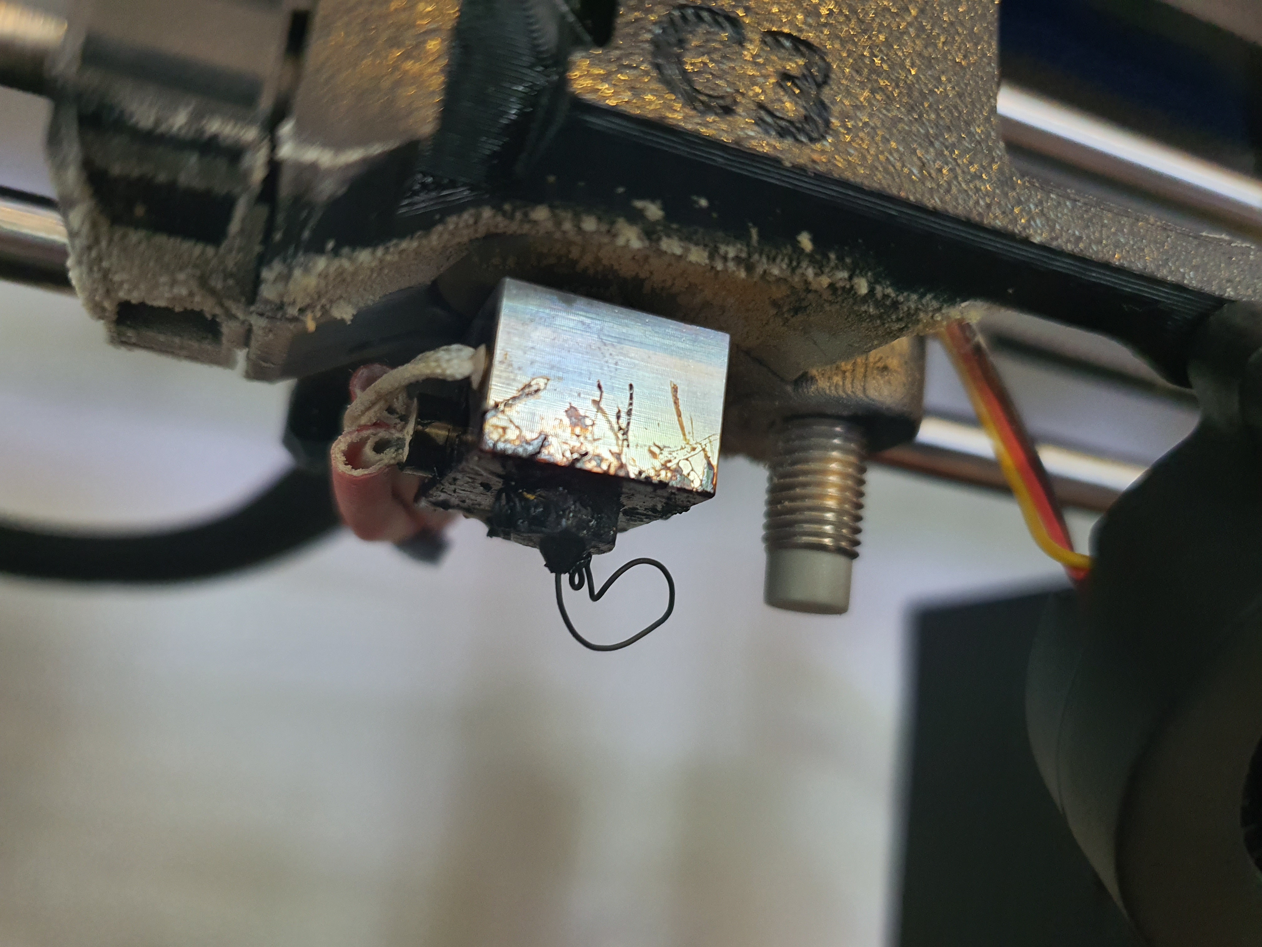

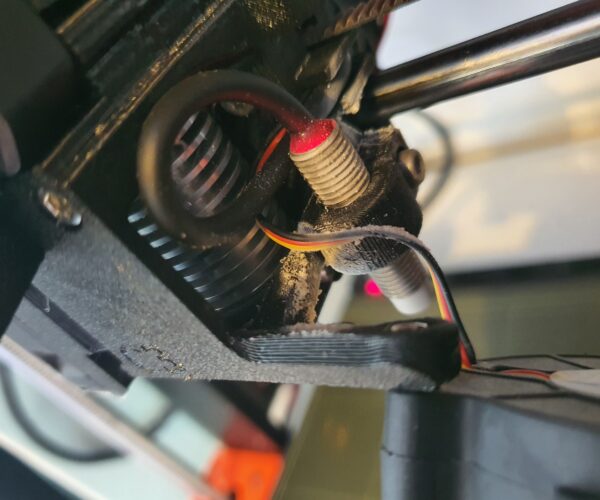

I can re-print that part, not an issue, but what makes me wonder is the white dust that is accumulating around the extruder area.  Any idea what this is about and the gravity of situation I am facing at the moment? I print mostly Prusa ABS and the only time I printed PETG is to make the face shields which is roughly about 25-30hours a month back.
dust at pinda point dust on extruder body and around it deformed fan shroud and turned almost white due to dust.

Do you use any paste (copper paste or ceramics paste) on the hotend (nozzle or heatbreak)?

The use of copper or ceramic paste prevents cold welding, corrosion and sticking of the nozzle and heatbreak. When the nozzle is heated, the fat in the paste evaporates and can settle in the area of the hot end and cover the surrounding parts.

No, the paste is only applied thinly to the threads and has no contact with the plastic parts of the extruder or with the filament. After applying the paste, the grease contained in the paste evaporates for a few minutes and smells a little. After that you will not notice anything. If you repeat this often, a whitish layer may deposit on the surrounding parts, but this does not bother you. As long as everything works perfectly, I wouldn't bother about the coating any more. You should clean the hotend from time to time anyway.
