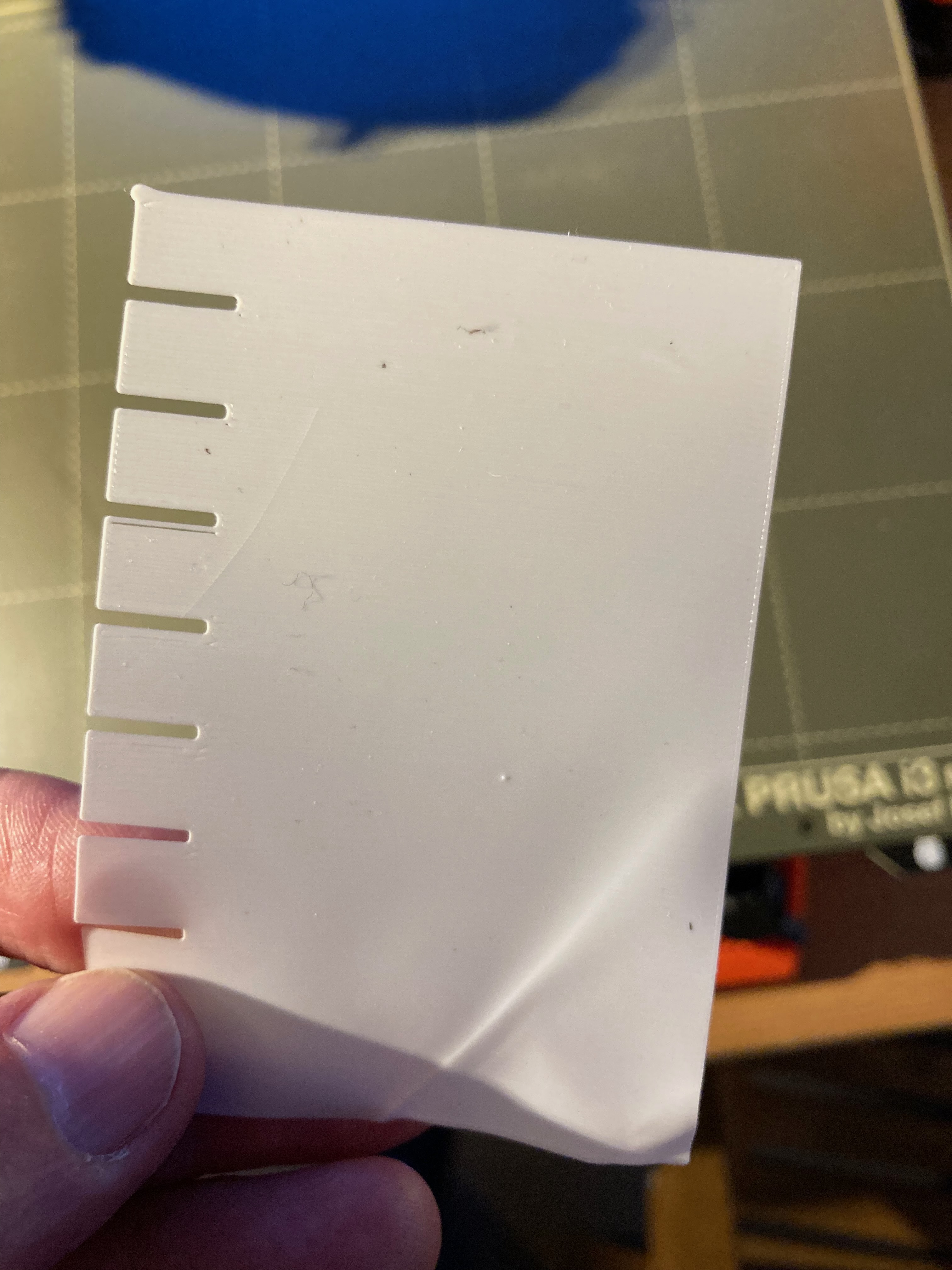

what needs looking at on a used MK3S+?
Just got this today with seller-reported issued of layer-shifting and a broken filament sensor. Working on those issues but it's seen some action, for sure. I blew off the dust and loose grime with canned air and it passed all the tests. The Z rods are a bit mucky and the fans look a bit grubby as well. It works, as best I can tell, but I want to make sure it keeps working. So what's worth looking into? Stock up on belts just in case?
Here's my first layer…Z-offset of -1.600
Posted : 06/02/2024 2:58 am
See: https://help.prusa3d.com/en/article/i3-printers-regular-maintenance_2072
https://help.prusa3d.com/guide/maintenance-tips_23200
The belts themselves should be OK but layer shifts might be caused by loose belts ... Print this:
https://www.prusaprinters.org/prints/46639-tension-meter-for-the-gt2-belts-of-i3-mk3s-or-prus
It MUST be printed in Prusament PETG or the spring tension will be wrong.
Come back if layer shifts persist.
