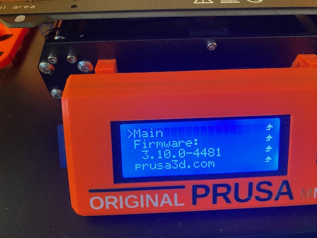

This is the firmware version running on my MK3s/MMU2S

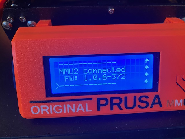

Some progress but not much. After much fiddling I am able to get all five filaments loaded into the MMU. I can even then selectively advance a specific filament to the (heated) nozzle, but then, all printing fails with the appearance of under-extruding which I am attributing to high friction of the filament within the PTFE tube(s). Some more parameters have come to light (I was not scrolling far enough in the Support sub-menu.) I now see the entry "EINSy_10a", "E3Dv6full", and "Date: Dec 19 2018". Then "MMU2 Connected", "FW: 0.9.0-86". Removing a filament then becomes a crapshoot, frequently requiring a reboot/reset. When a filament is loaded to the nozzle, what is the difference between menu choices "Unload filament" and "Eject filament"?

Do not update the printer higher than 3.11.0 ( get it here: https://help.prusa3d.com/downloads/mk3/firmware ) Above that you will get the new thermal model that might result in problems if your hotend has been modyfied in any way, if you go much higher you will need to use the 3.something firmware for the MMU (see below).
Do not update the MMU higher than 1.0.6 (get it here: https://github.com/prusa3d/MM-control-01/releases/tag/v1.0.6 ) Above that you will need the printer on current firmware for the MMU to run at all)
Then, reduce the friction in your setup (buffer, PTFE, PTFE couplings ect) until you get it printing reliably, if you encounter the 5 LED blinking error, upgrade the powersupply (DIY or with the new PCB, there are cheap clones that do the job). If you sorted that out, upgrade to the current firmware and deal with the problems they add and enjoy the features they bring... or don't.
