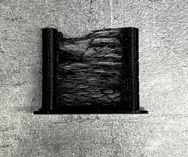

Hello,
This is my fourth Prusa, I have printed many hours on Prusa profiles and I have never had such a problem. One of my printers suddenly started stringing, I have tried everything I could think of and read on forums. I cleaned the fans, replaced the PTFE tube, checked the heatbreak, put in new thermal paste, new nozzle and it did not help. The pressure is also correct, the printer has been restored to factory settings, it has passed the calibration tests correctly. I would not like to solve this problem with software, because it is troublesome to configure the settings individually for each print, and I know that on other printers everything works correctly. Please help.

Unfortunately not, if it were I would be overjoyed. I opened a new sample of Prusa filament and this problem still occurs on one of the printers. I will add that the idelr is tighten in accordance with the Prusa instructions. I wonder if it is worth checking the heater or the thermistor, but if the calibration tests are correct, why would it be damaged?

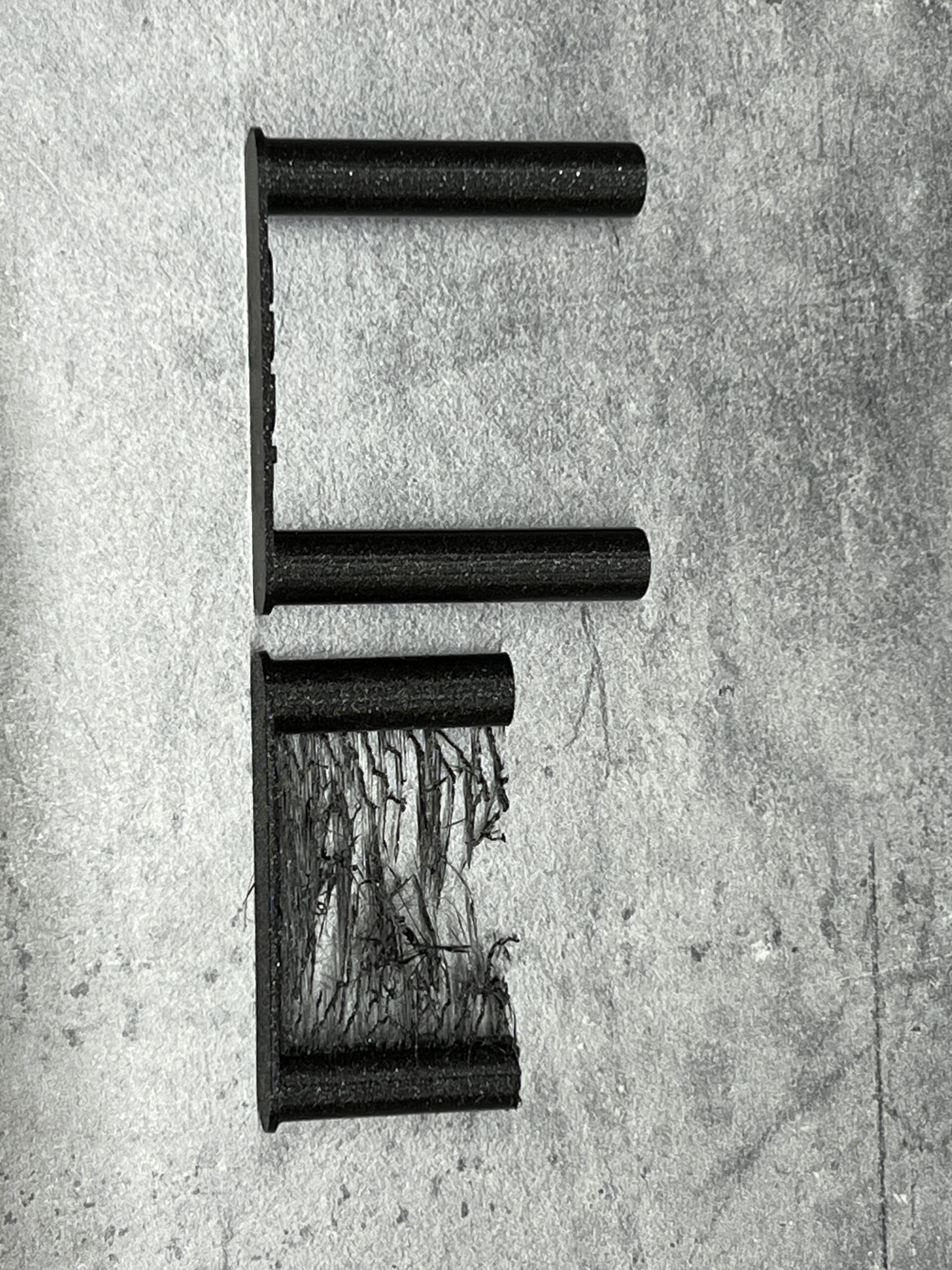

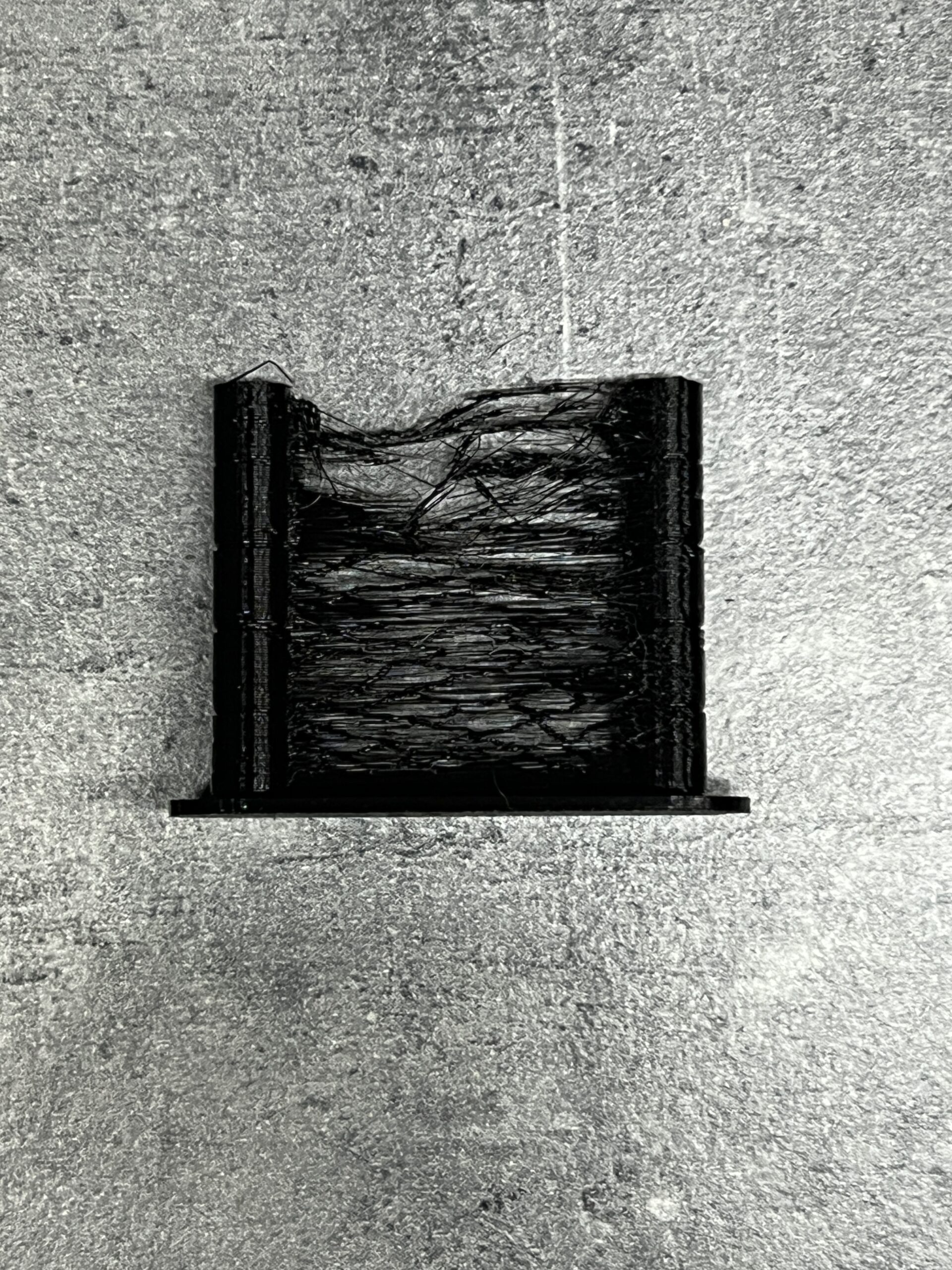

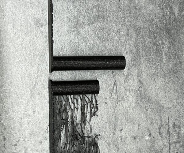

The perfect print is from MK4 the one with the strings is from MK3s plus. The same prusament PLA, same standard settings for both printers

The perfect print comes from Mk4 the one with strings is from MK3s. Both printers used the same prusament pla with basic settings.
