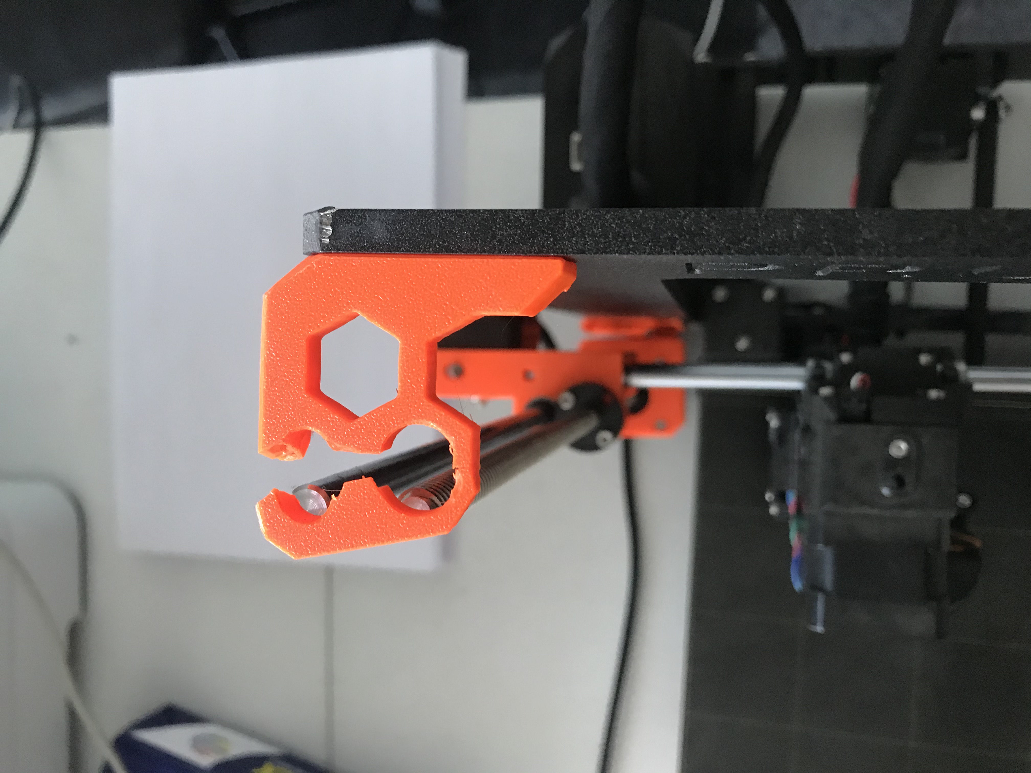

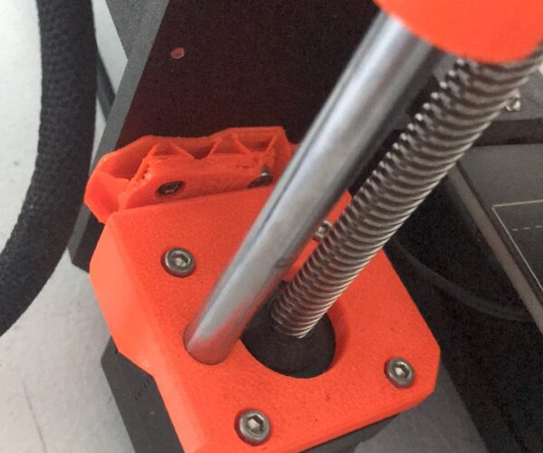

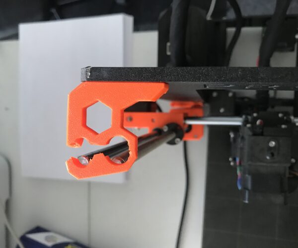

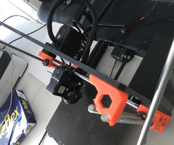

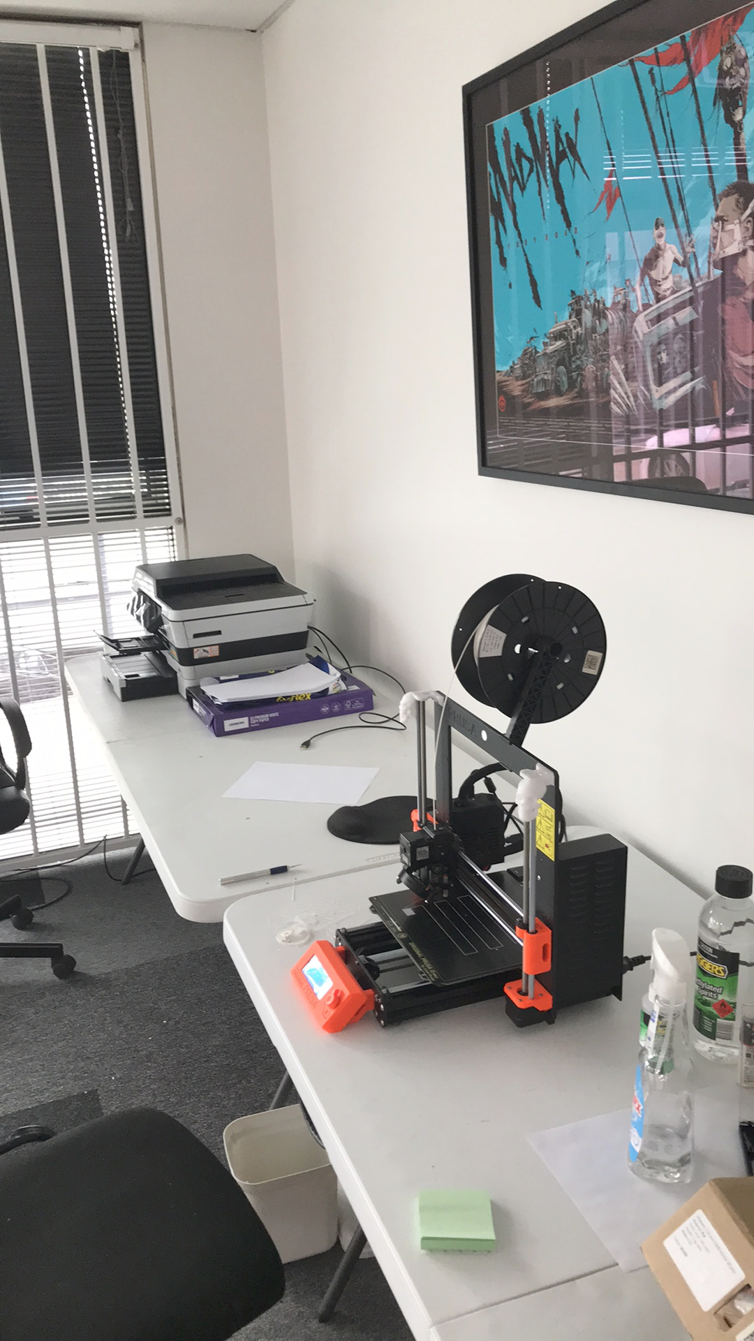

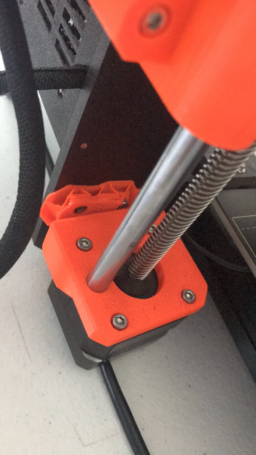

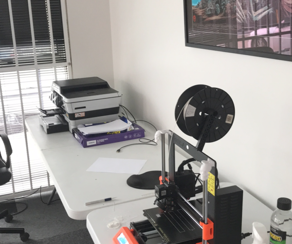

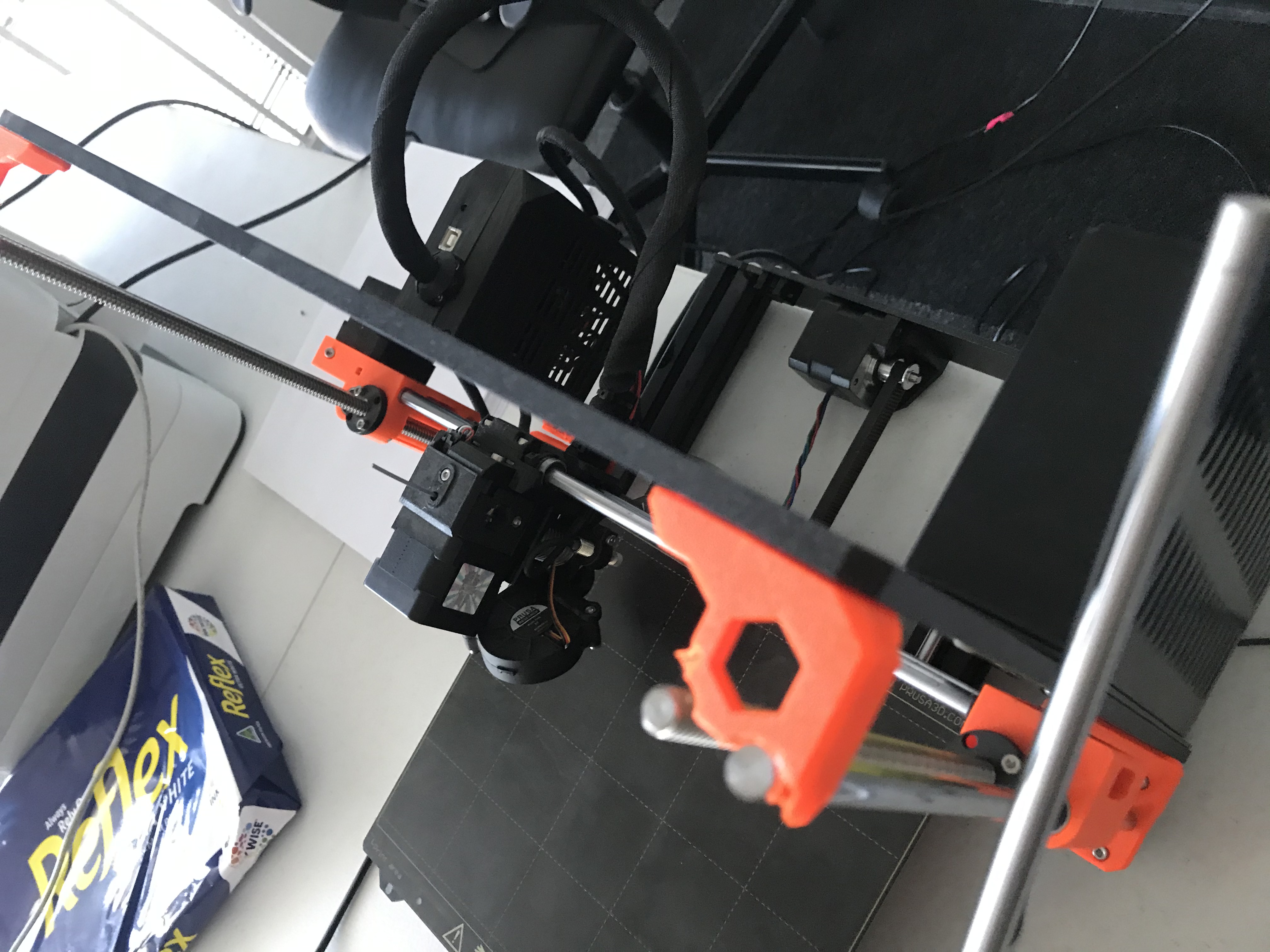

If my Mac is plugged in and running Pronterface can I potentailly use these setep to control my printer. What are the Pros/cons of this over rasbarry pie and octoprint?
You can set up remote access to your Mac, Windows, or Linux computer.
  1. On your computer, open Chrome.
  2. In the address bar, type remotedesktop.google.com/access .
  3. Under “Set up Remote Access,” click Download
  1. Follow the onscreen directions to download and install Chrome Remote Desktop.
Loving my Prusa Mk3s at work.. had it shipped up from Syd to Qld Au and parts broke in the pakaging.. A friend of mine then saved the day by printing off these broken parts and I was able to fix my printer.
Josef what is your team working on next? We want to print bigger! Will this type of connectivity through WIFI and maybe a camera be built into your future models..
"Pack and send" sydney damed the box and my printer inside. borken "Pack and send" sydney damed the box and my printer inside. "Pack and send" sydney damed the box and my printer inside. work setup need to make it more stabe for those micro jitters.. will use a flat stone and some soft foam underneath A friend posted me these new bits up just in time for my 41st birthday Yippeee.!
Respondido : 24/10/2020 11:08 am
