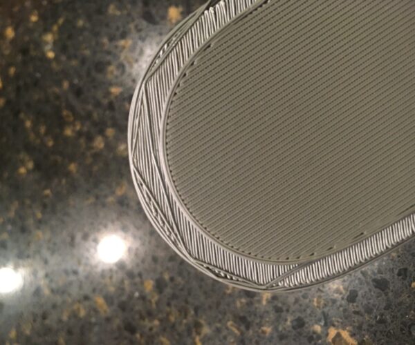

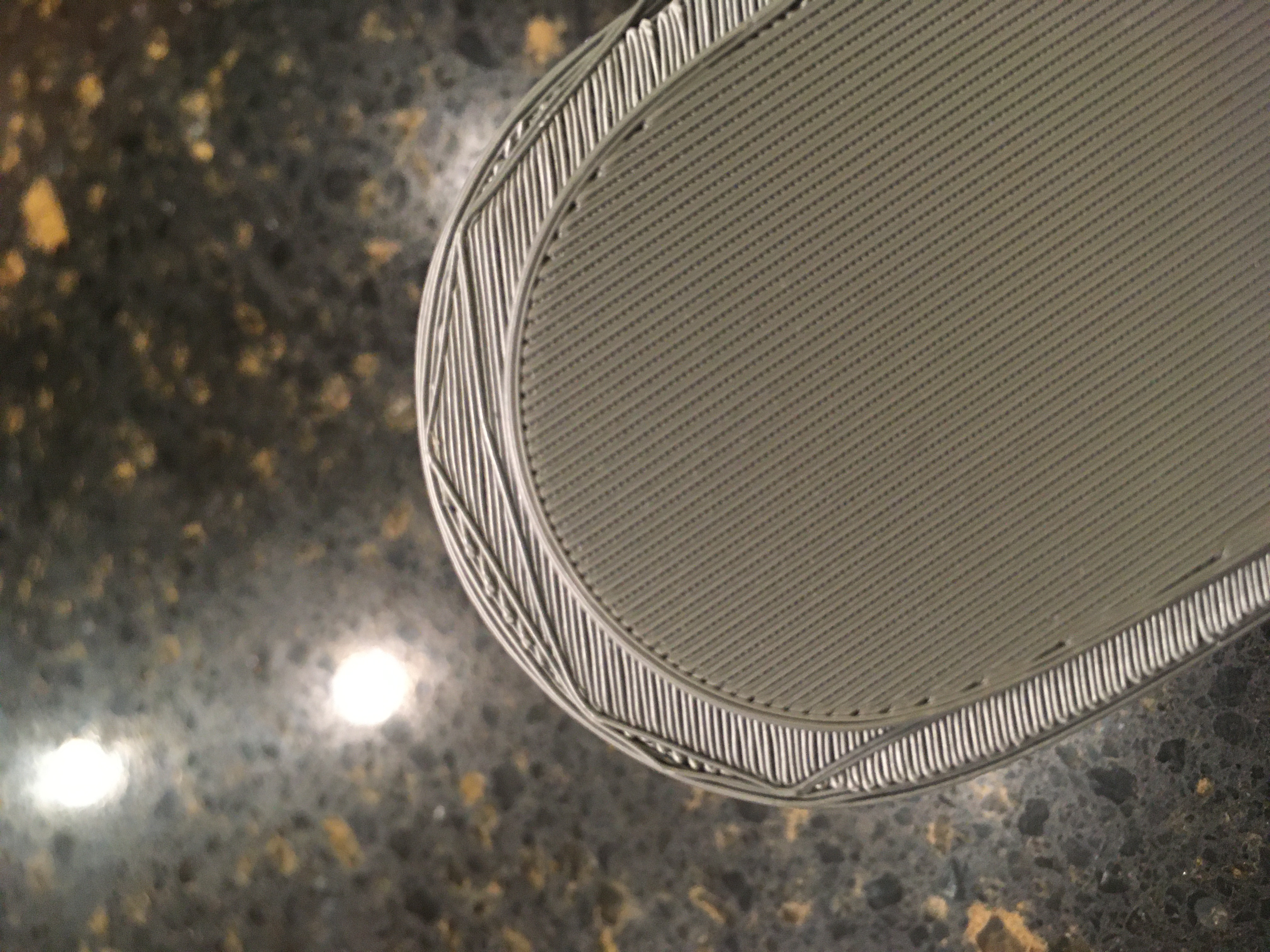

Hi everyone,
Total FDM rookie here.
I'm encountering a weird jagged perimeter draw on a lid I'm printing. Seems to happen on first layer of cantilevered "lip" of the lid (picture shown is the underside of the lid). What should be a smooth curve is faceted in a seemingly random way. It seems like this problem happens on only a couple layers. I've checked the slices and there is no indication of this anomaly.
This is what happens on the first "overhang" perimeters.
Any ideas what is going on here?

Did you use supports?
If you use Supports, check contact Z distance and consider using the removeable setting...

Looks like you're trying to print in thin air. As @joantabb said, you'll need supports to, well, support the overhanging lip.

I'm unclear if that picture is the top or underside of your print. It looks like a view from the top to me. Those odd extrusions are caused by poor inter-layer adhesion. The filament gets pulled taut as it becomes dislodged and is pulled across the arc. If each layer doesn't have enough filament underneath it -- very possible with a sharply sloped or filleted underside -- there's simply not enough filament below to grab onto.
Slowing down, increasing temp/decreasing cooling, and reduced layer heights can help. Wider perimeter extrusions may help provide more underneath. I'd try slowing down 50% using the front knob as a quick test to see if it improves. If the underside is sharply curved or angled, it may require support (which will give ugly results). You might want to redesign the part to use chamfers instead, if it's your design, or reorient the part to minimize the overhang angle.
It would help if you'd save your part & settings in a 3MF project file, zip it up, and attach the file to a reply here. That way we can examine your part, orientation, and settings to identify possible issues.
