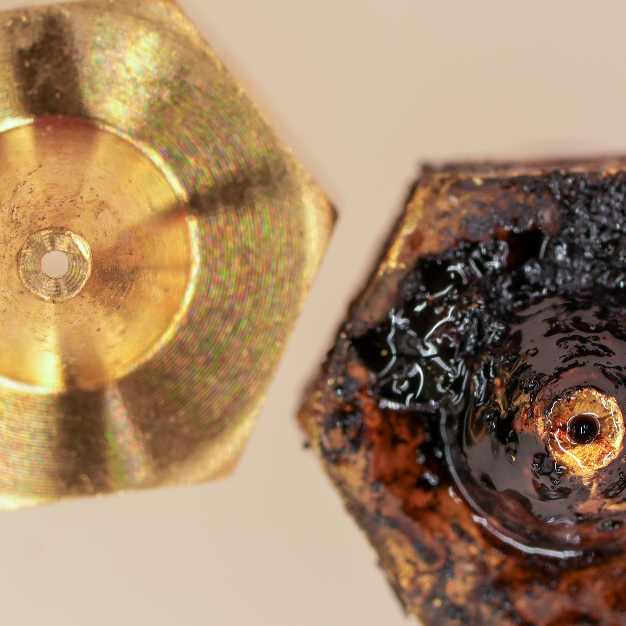

I am one of the 3D printing co-stewards in our maker space, and as you can imagine the printers take a beating. People new to the hobby, or just distracted will happily run ABS at PLA temps and wonder why it under extruded and didnt stick great. Run a spool of glow in the dark filament on a brass nozzle etc.etc.
Our "most popular" printer has 38,824 hours on it, next are 20,717 and 15,314.
Part of what makes MeanStreak so popular is even with > 1,000 days on it, it works great every time. We get wires to the bed go bad from time to time as well as bearings, but we have done a lot of construction, so that could be drywall dust / ceiling tiles etc.
I would say we do not change the nozzles as much as we should, this is what one looked like coming off after I would guess 5,000-10,000 hours.
One new and one well used nozzle One new and one well used nozzle
