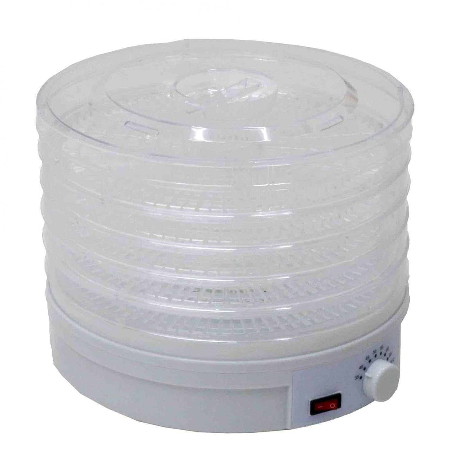

Has there been any progress on the project from the original post? I am interested in vacuum drying my filament as well. With the MMU 2 upgrade, im looking for a way to dry 5 filaments at once without using my oven in the house. Im thinking that using the vaccum pump method would cut the time needed to dry my filament down to a minimum as well.

Unfortunately, the original poster seems to have gone MIA. I had posted earlier that one of my buddies attempted the vacuum drying technique and ended up going the food dehydrator route instead. He said that he didn't seem to get as nice a result with the vacuum method. Unfortunately though, it wasn't a proper test with variables that were being tested, so it's not *great* advice... Maybe I shouldn't have even said anything hahaha.

Unless you have deep pockets, don't bother with the vacuum method.

Basically the parts to do this are expensive as well as the container to withstand such a vacuum
and you would need a vacuum pump capable of pulling water up a tube 9.83 m high.
Or one of these for just over £27 if in the UK.
https://www.amazon.co.uk/Oypla-Electrical-Dehydrator-Machine-Thermostat/dp/B00KB9494S/ref=sr_1_6?ie=UTF8&qid=1548794502&sr=8-6&keywords=Food+Dehydrators
The plastic trays in the middle come out leaving just the outer rings and lid, just leave the bottom tray in and stack your fillament and put as many rings as required to cover, set the temperature and leave for some hours.
Recommended dryer times here: https://www.printdry.com/dry
No doesn't that look familiar? 😉

Thanks for all of the info! I've had very good luck with my modified food dehydrator. I'd like to convert it into a spool feeder while it's doing the drying job so that I can print filaments like nylon and the like.
Thanks again mate!
