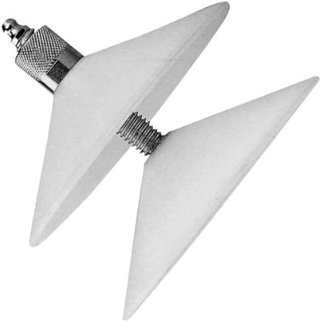

some time ago I saw a printed part (mostly, had a bit of other parts like a zerk fitting) that was for greasing bearings. you had to print special parts for each bearing and for the bondtech needle bearings they would be very tiny but those can best be rubbed with a toothpick anyway you clamp the bearing in the fitting and the linear would have an outer part holding the shell and an inner a tiny bit smaller than the ID then with a small grease gun shoot he grease in until it comes out about the edges. wipe clean and reinstall... don't know it is still there on thing verse or one of the other sites but there are commercial larger ones for sale on line and you can see how they work and decide it you like the idea.
the central threaded rod with the zerk fitting is printed to fit your linear bearing and it is hollow with a cross hole or holes the cone things are also printed all form memory as I could not find the thing on thing verse.
