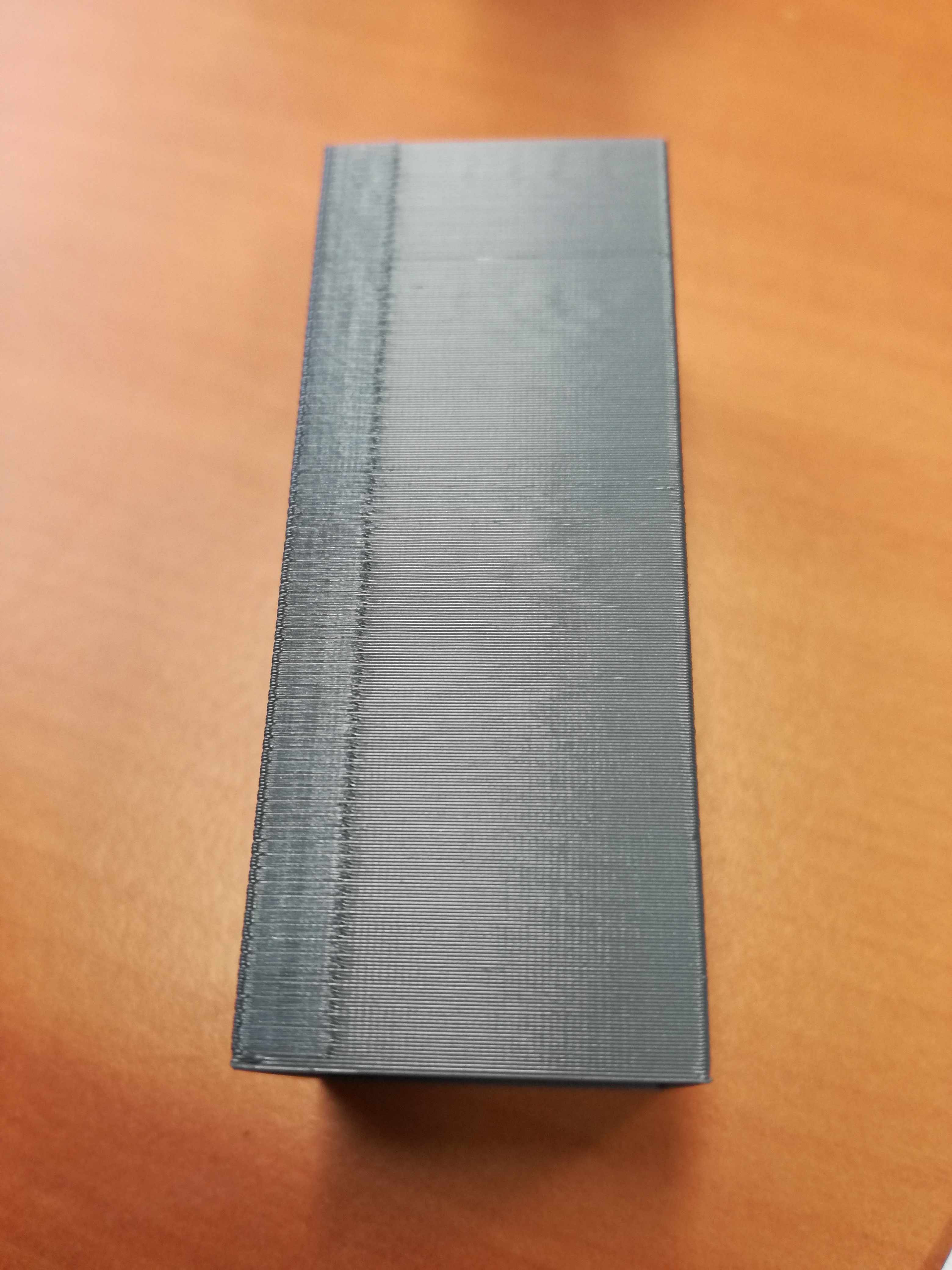

Hi makers,
Yesterday I was trying some parameter variations one a single wall tower and this happened :
As you can see, a weird line is on the left side. I watched the extruder movment and it did this for each layer :
So 5 and 6 caused this line. Do you guys know what this is ? I mean why there are 5 and 6 movment and how to change that ?
I don't really care for my tower purpose but I don't want this to appear on real prints.

This looks like a wipe move to me.
Look at your slicer settings. in Simplaify3D e.g. wipe is by default set to 2 mm in the MK3 profile

for a single wall tower, why not use vase mode. ?

I use Slic3r and there is indeed a wipe option enabled, but I can't find the lenght. Anyway, I'll try to disable it and print my tower again. Thank you for your answer.
That's a good question ! Actually I wanted to enable the Vase model but I couldn't because Slic3r considered there was more than one object on the plater. I've just tried 2 minutes ago and it worked. Should be better indeed 🙂
