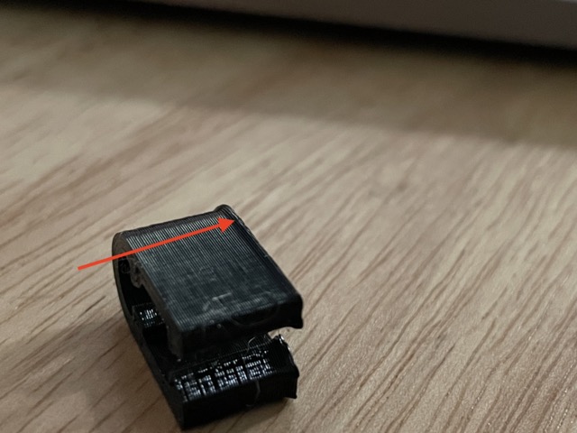

Profile flaring outward at base
What setting / adjustment would need to be changed to eliminate this flaring out at the base of this object? Thanks.

No picture so anything is a guess but usually the expansion of the base is called elephants foot, and the setting is called elephants foot compensation.

RE: Profile flaring outward at base
Yep, got a picture now.  That looks extreme.  Normally its only the first layer on most printers.  To get that much you would really really have to have the nozzle close to the bed.
I take it you have calibrated your extrusion etc ?  Basically all the normal setup and calibration steps for your printer and material.
Just in case its some settings weirdness could you save your project from Prusa Slicer.  Basically slice it like you have there and then use File>Save Project as.  That will save a PS 3mf file.  That will contain the part as well as copies of the 3 profiles you are using as well as any placement, modifiers etc.  Its basically a snapshot.  Easiest way of looking through all the hundreds of settings.  We can also see the preview and if needed generate the same gcode from the project.
I still think its basically EP but it could be exacerbated by cooling settings.  Depends on the material you are using.  Project would contain that info too 😉
Also whats the bottom layer like ?  if you could rotate that and take a pic of the bottom I think that will give a complete picture of everything along with the project.

I believe you were correct, I adjusted the Z plane higher off the bed and it looks much better. Thanks again!
